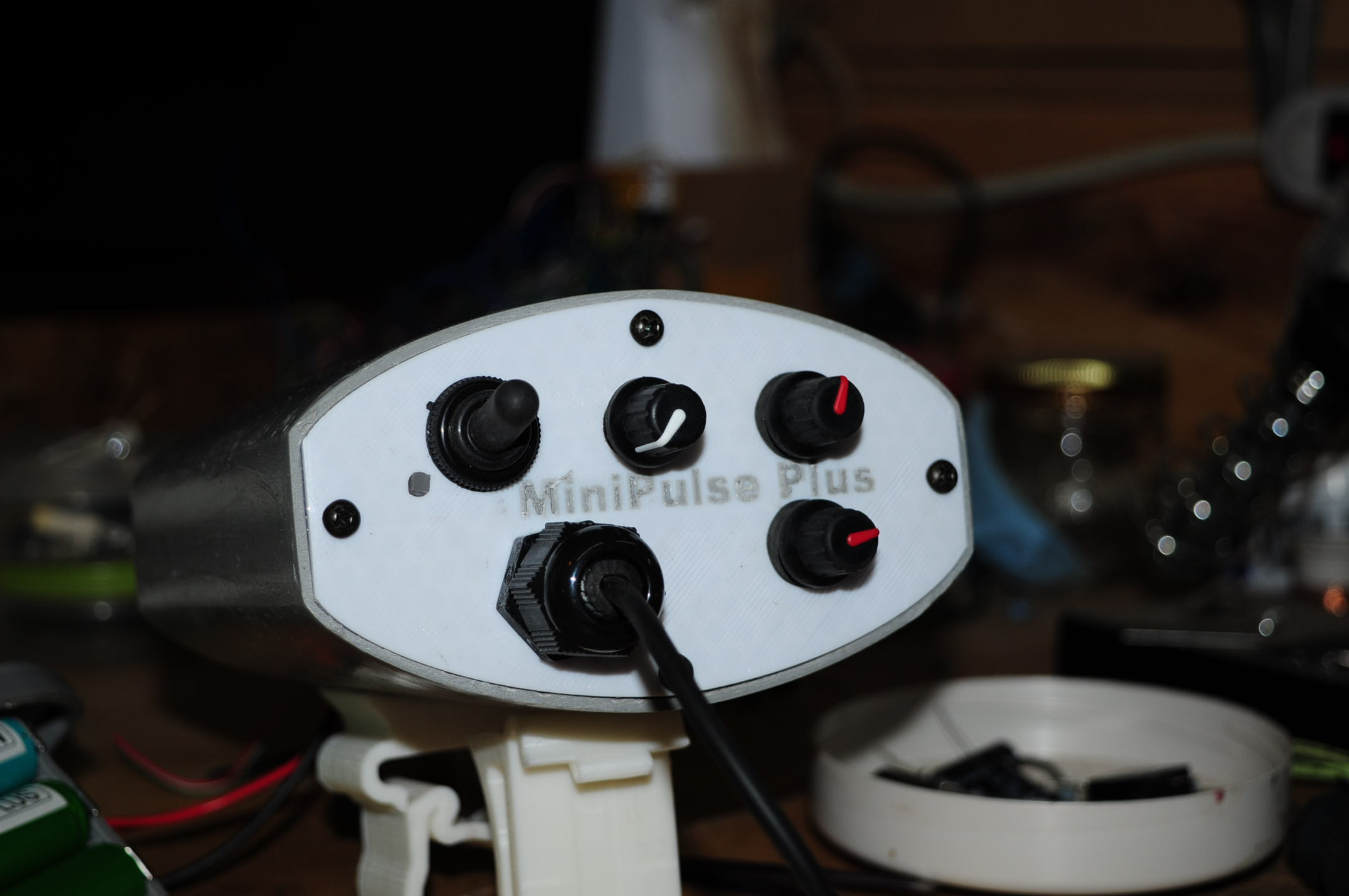

    Happy Canada day to all the Canadian folks On here,
    I have been experimenting with different coils , and of course none of them use the same damping resistor, So what would be a good way to set up the MiniPlus for easy coil swap? AKA fast resistor swapping, Is there a shoe of some kind that one can pop out a resistor for another , or would be a permanent variable resistor pot be a better option, and if so what would be the guru's suggest ? maybe a small trimpot?

      Remove the resistor of the PCB and add the resistor to the coil connector. Then when you change your coil you also change the resistor.
        I was thinking that , however I remember reading something about Carl Saying that was a bad I idea , but I don't remember what post it was!
          I always put the Damping resister on the associated coil .
            if you use it with the same detector should be ok, but if you have other detectors? different setup.

              That is the problem I have more then one, the SurfPi which is my fun go to toy, and the Minipulse plus which when its working right is a joy, and I asked Andy for the Geotech Baracuda. So putting the resistor inside the coil is a no go. I would rather have a input swapping thingy a mobobber lol I am starting to like the idea of having a Digital pot with a small 2X16 lcd running off a Arduino mini.
                Can't you just put part of the resistance on the coil connector and the rest on the board.
                  Easy Fix. Just build adapters for Each machine with correct Damping as required. What ever connectors your use to using just put the resistor in a gender bender connector. Male/Female or what ever.
                    I use Ip68 waterproof connectors, there is no room for a resistor in the coil side of the connector loll Trust me lol I would of thought of that myself hahaha.
                      what Id need is some sort of clicker knob with a center point and a way I can place a few values of resistors, Something like that's on the back knobs of a oscilloscope but less complex haha
                        There we Goooo! Nice find!
                        Now we need to make it fit hahaha

                          Happy Canada day.
                          Is that base mount on your detector 3D printed?
                            There are basically 4 places you can choose to fit the damping resistor:
                            1) On the PCB.
                            2) In the coil shell.
                            3) In the coil connector.
                            4) In the detector enclosure on the inside of the coil socket.
                            #1 results in the same damping resistor being used for all coils.
                            #2 is a problem if you want to use the coil on different detectors.
                            #3 is often tricky because of lack of space.
                            #4 means that you could use (for example) a 5-pin connector, with 2 pins used for the coil, and 3 pins connected to different value damping resistors. Then the closest required value can easily be selected by a wire jumper in the coil connector. However, there may still be problems swapping between detectors.
                            Other possibilities (already suggested) are:
                            1) Add a selector switch to change resistor values.
                            2) Use an adapter cable.
                            Personally, I put the damping resistor inside the enclosure on the back of the coil connector.
