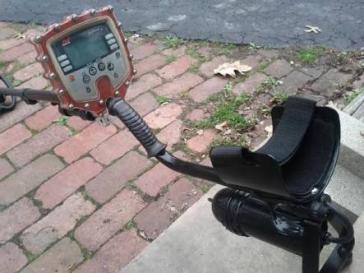

                    Originally posted by targetdown22 View Post
                    i love my minelab but i can't go underwater that's why i build the surf pi 1.2.
                    I love mine too but i'm so eager to make it waterproof like this.. its really time saving than using pi.Click image for larger version

                      I saw this pictures too, i would like to do the same but i don't feel it good to go with a machine i paid 500$ inside the water lol anyway i will not use coil shield and i will see how it performs.
                      Thank you a lot
