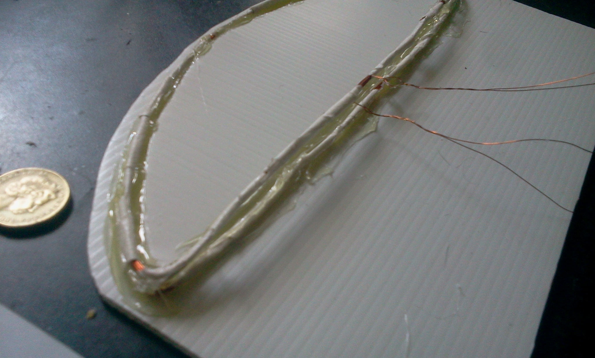

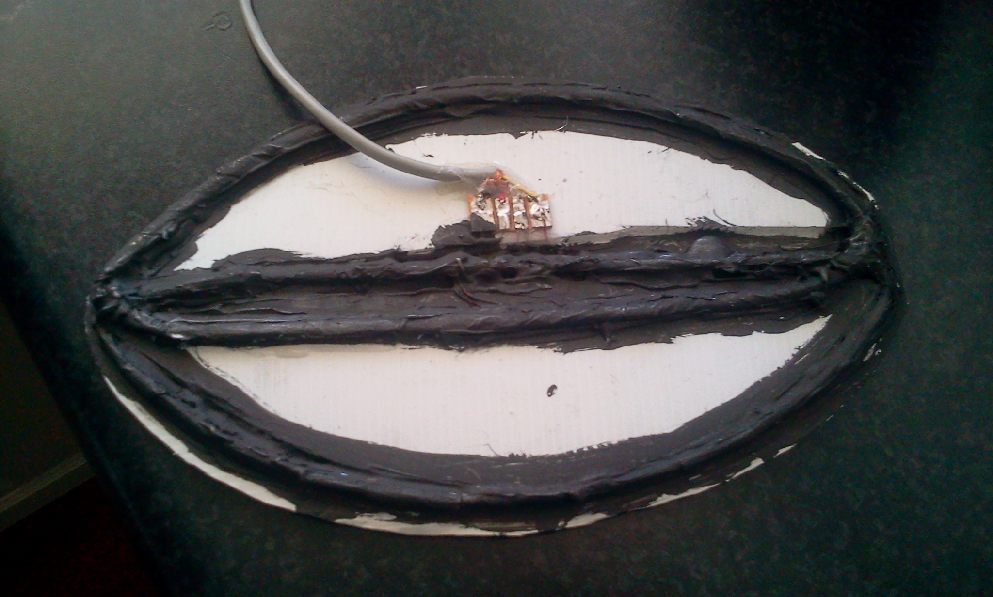

    I am currently playing around with this idea for improving depth and efficiency of metal detectors i have built one for my 60khz diablo and shows promise the idea would probably work for pulse induction designs as well
    this idea is just something i came across in my other interest free energy devices.
    and is very simple for VLF - two transmit coils phase connected the same way stacked one on the other is supposed to amplify the magnetic field and there is no reason you can not stack 3 or 4 for the same effect something worth experimenting with.
    this is a patent explaining it.
    US4806834.pdf
Name:	2017-09-22 10.58.42.jpg
Name:	2017-09-26 15.28.32.jpg
    and a little trick i use to balance my coils is null as close to what you need then use a small ferrite fragment moved around to do the final tuning point then glue it down works for me.
    Unfortunately the US Patent Office is notorious for granting patents for inventions that don't actually work, and this is one of them. If you want to increase the magnetic flux you have to increase the current and/or the number of turns of wire. No amount of 'mirror image' winding or other gimmicks will do this. (Also much of the language in the patent is simply nonsense.) Sorry.

        I suspect one large coil would be better than two stacked coils but feel free to experiment and post your findings. There are some two transmit coil designs explained in the data sections of this website with their advantages and disadvantages.
          I'm all in favour of experimenting, but I have to say that if that patent is correct then all the textbooks are wrong. That's always possible but I'm fairly sure that if they were people would have noticed by now.
            I see a lot of "it is believed..." in the patent. That is, they don't know what they are doing.
            At about the same time ('89-90) I was hand-winding tiny toroid RF transformers to use for driving my ADC designs. I was doing exactly the same thing shown in Fig 1 & 2; the center tap was my drive voltage and the outer taps were grounded. The secondary was a grounded center-tap differential winding. The purpose of winding the primary that way was not to produce any magic effect; magnetically, it did not perform any better than a single winding. Rather, I was trying to achieve a perfect symmetry with the signals to minimize parasitic coupling. The transformer was used to do a single-ended to differential conversion at up to 100s of MHz for characterizing ADC performance, so I wanted perfect signal balance.
            So I have direct experience with this method, and I recall nothing at all that supports the benefits claimed by the patent.
