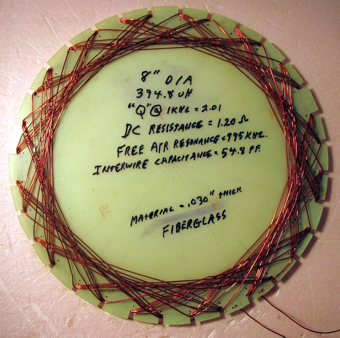

    Here is a nifty circle divider if you want to experiment with PI coil formers or something else that needs odd or even numbers of slots equally spaced around a former, simply enter the Diameter and number of slots required and the program will divide the circle for you, print it and have fun.
    https://www.blocklayer.com/circle-divider.aspx
    A coil former example

      i do not recomended fiberglass never. material i use and recomended is fibreboard.
      i also told about the dielectric constant of materials so you can SEE and LEARN what material has less that.
      http://www.perm-pp.ru/images/sampled.../99999-dvp.jpg
        i give again this link. this coil is NOT WORKING. yup it seems done best, but absolutely unusable (SIC!!).
        WHY??? you must SEE the cause.
