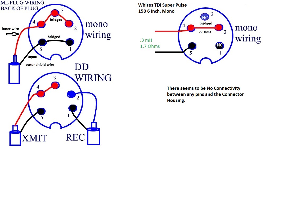

    Is this a true mono coil or a DD masquerading as a mono?
    Anyone have the pin configuration or ohm readings?
    Funny your on about this I orderted 15o a week ago and it happened to come in today.
    Here is what I found.
    I ordered it to use on my Pulse Mini Plus. Or Barracuda. Or some other PI.
    The Sale is over by the way. I should had ordered the other TDI coil they has as well.
