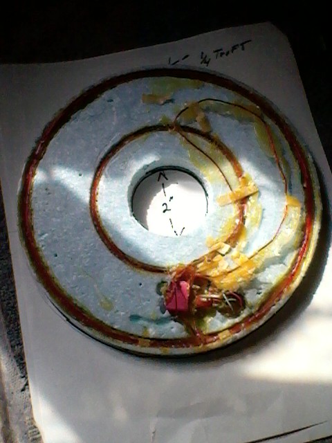

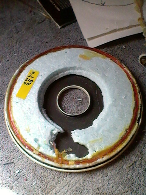

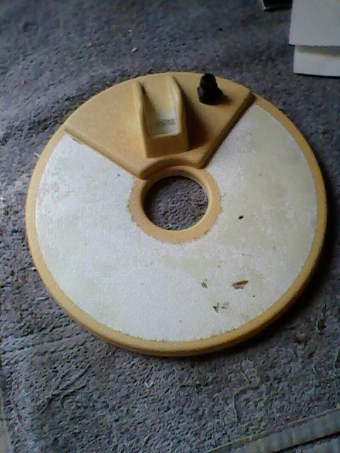

    I came across some old Discovery Baron Coils to play with. One was opened so nothing to loose I dissected it. I now have another coil for one of my Project DIY Pi's . The Tx coil made with 22 AWG measured come to .7 Ohms @ 310uH. Right on the Money for your basic PI Detector. Why Discovery used this set up as a Tx coil on a VLF is a conundrum to me at this point. They must have been putting out a considerably strong field for a VLF.
    All I need to do is Re apply some Conductive Graphite shielding , foam things, Some nice white Rattle Can Vinyl Paint the original enclosure and DONE. Cool one more for the Toy Box.

Name:	Baron ESPcoil -7ohms 310uH.jpg
Name:	BaronCoil Housing.jpg
    could you measure the resistor/square of the shielding sheet ?
      no special reason if there is not measured resistor. main rule that you do not want to note... your mind on ground
      and disconnected.
      in moment of discharge of static field high voltage/potencial charge some graphite granules must be unite by microbreakdowns in
      some kinda chain of closed connection. do you see here the resistor measured by tester's low voltage?
      thats mean GOOD shielding de facto we call of.
        There is No Sheet. It was just sprayed. Measuring various distances it seems to be about 700 Ohms per inch.

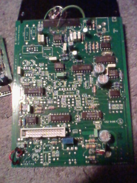

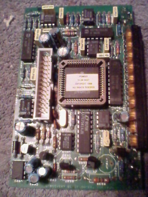

            I have like three or four Sets of PCB's all in various states of Disruption .... LOL

              i have cobra ii. your board is same but part of details are not soldered, seems no need if with the micro.
                Cool. Petty there not complete
