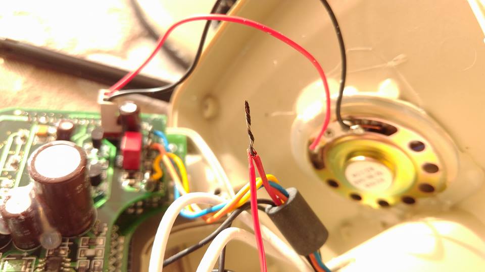

Found this picture of a RF? choke on the coil cable of a metal detector, wondering ...
    Apparently enough. Usually these things are added while the unit is being tested at the compliance lab. They play around with adding ferrite beads & chokes until they can get it to pass EMI, then production units have to include the same solution.

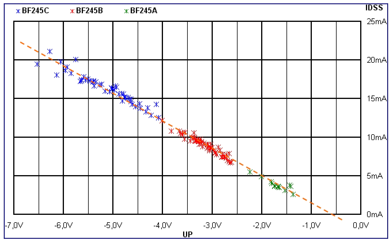

                      Hello Sinclairuser, I finally got a collection of WIMA Foil capacitors, all in the smallest dimension available. Yippee .....
                      I think I am starting to understand the matching business of JFETS as you mentioned. This picture sort of said it all for me.
                      Someone was so nice as to put the test results on the net: Click image for larger version
Name:	JFET Variance.jpg

                        Thanks Ionut_mtb! I have returned from travelling and brought a box of assorted, defined ferrite stuff with me for playing around.
                          Well, I added one to my Eagle Spectrum and it definatley does something. I can now work a lot nearer to electric fences (before was 60yds or so, now it's more like 25yds)
                          With a VLF it will flter out fast spikes with a PI it will filter out fast spikes and stuff your detector as the fast edge is needed. So many non technos on other forums who swear blind that, as per the audio crew, gold capacitors or unobtainium resistors make the amplifer sound SOoooooo much brighter and alive . Emperors new clothes syndrome if you ask me (a bit like LRL's.....Shhhh Rant mode suppressed)!

                            Hi Sean,
                            Thank you for your reply! I have an XLT spectrum myself and will try this. Did you put the ferrite just short of the plug to the box, or somehow
                            inside the xlt?
                            I got your point with ferrites being not good for letting fast transients pass thru for PI purposes.
