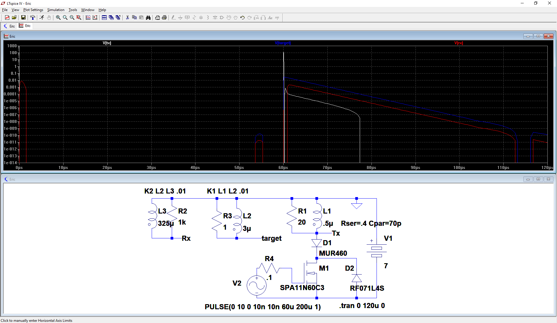

        An attempt at a spice model. Try with series MUR460 diode and with diode shorted. Need Tx damping resistor with spice(resonance 25MHz), didn't test for optimum value. Something to play with.
                Used a model I had for an IB coil. Probably needs added coupling between Tx and Rx (K3 L1 L3 .5?). Can't sample at 1usec when added. Maybe something wrong with model.

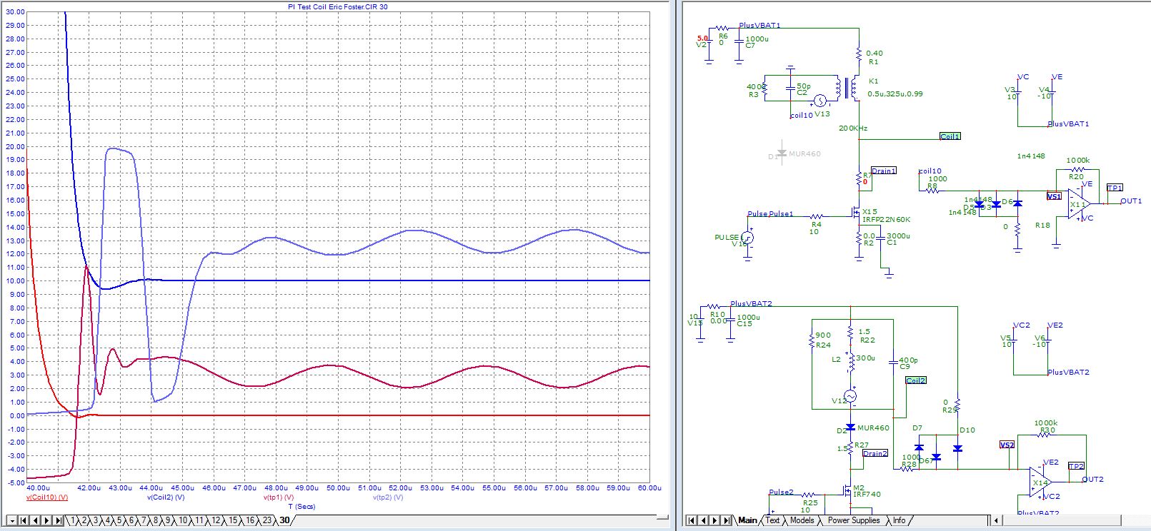

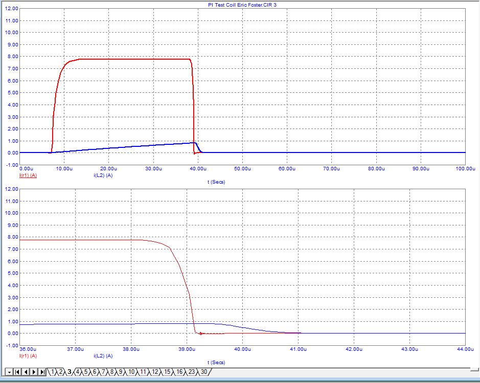

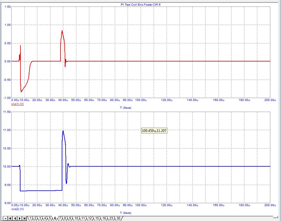

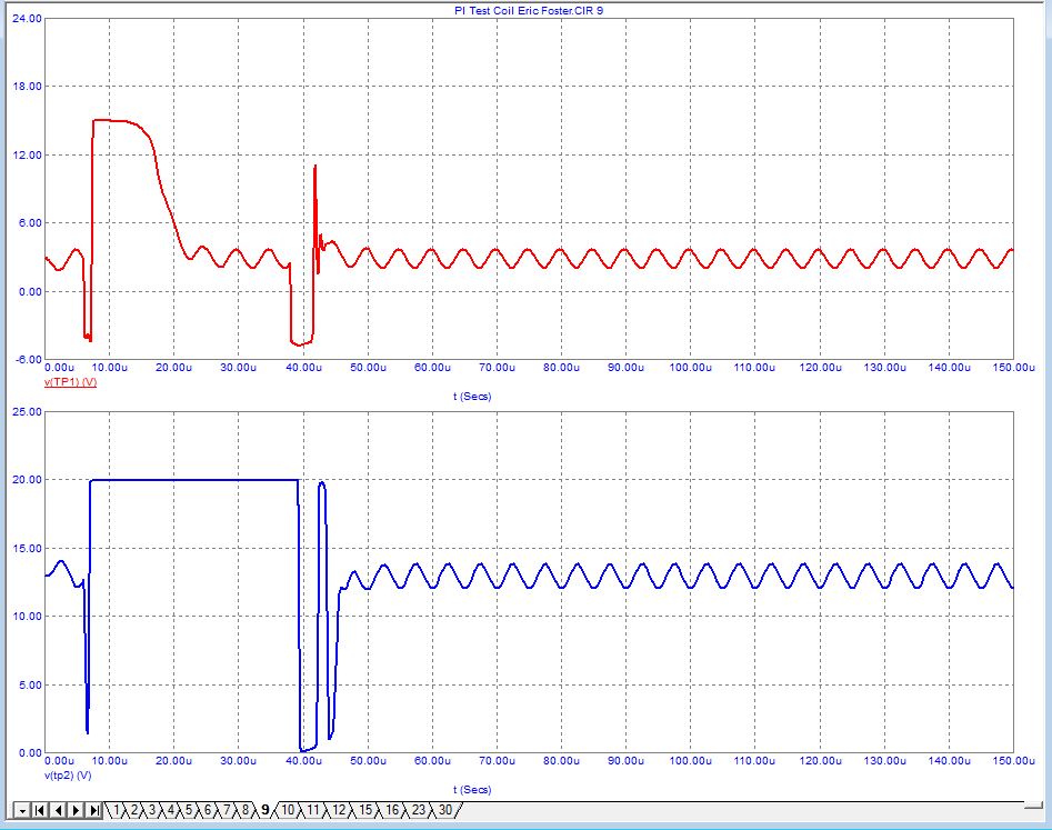

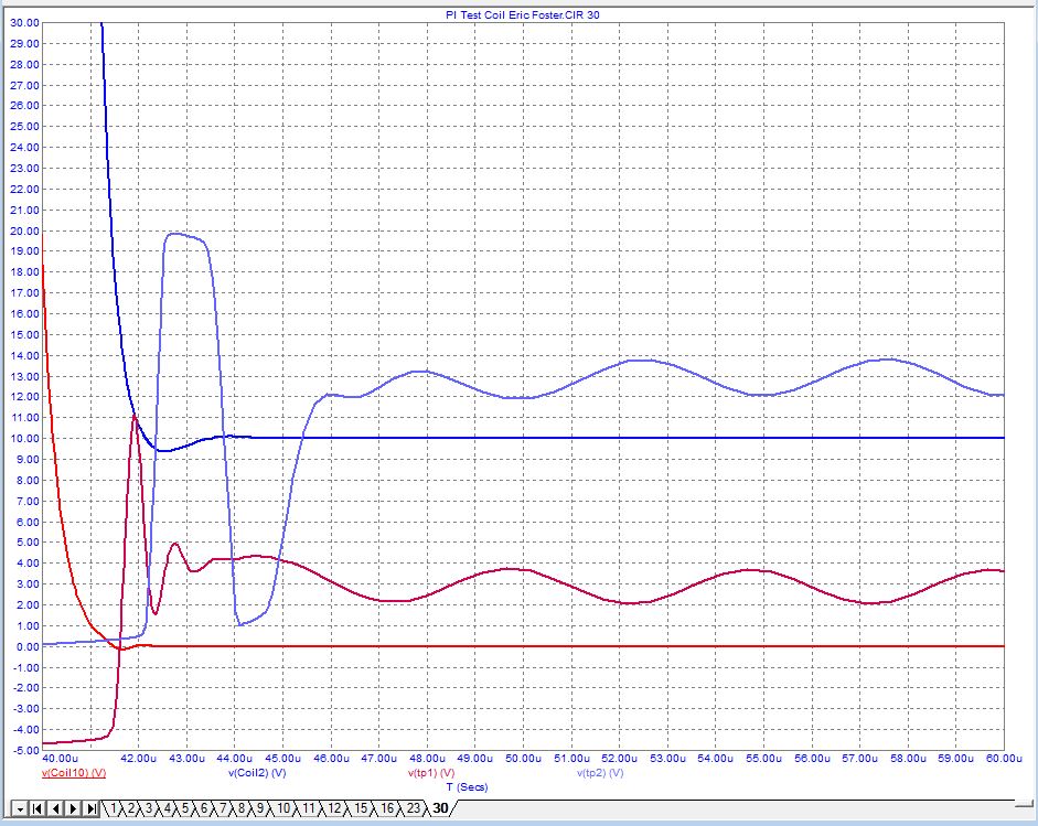

                  Hello,
                  have drawn on my Spice (Microcap ) what I have understood of the project.
                  I have used a transformer , in spice , with 0.95 as coupling coef. and your values of coil.
                  For the moment I used a IRFP22N60, as I have the model in library.
                  I can only attach jpg files here. (or I don t see the way.. )
                  So , hereafter some pictures.
                  I use a sine generator in serial with the coil, 200kHz 2mv to see the OPAmp working at soon as it is possible , according to the spice model.
                  The pulse begins ot 6µs, 2µS of delay to one level, so 1 level at 8µs
                  The trailing edge of pulse is at 38µs, the time delay is 2µS to level, making the end of pulse at 40µS
                  The current flowing in the Mosfet is near 8 amps.
                  The 200Khz sine is visible at say 45µs, with a 100Mhz opamp.
                  But in these simulations, i am not sure of accuracy of the setup times. It is very dependant on the quality of the spice model.
                  I also have put in same schematic, a classic TX, to compare the speeds.
                  I will try to attach pictures.
                    I have many errors while attempting to post , like the "token has expired" ????
                    here after some pictures

                    the sine signal is visible.
