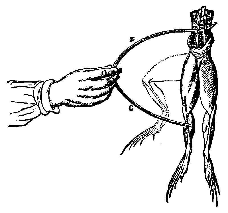

    Illustration of Galvani's twitching frog leg, when touching it with an arc made of zinc and copper.
