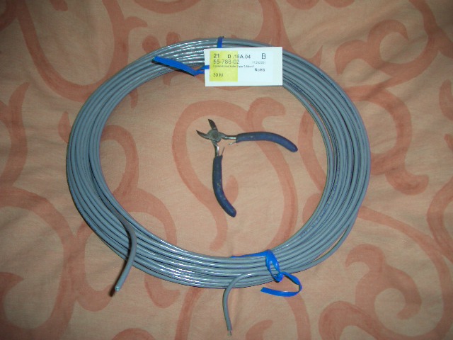

                i have approx 25m of Belden 8723, grey color. i will send 2m for 8 euro if you want.
                  Hm, sorry i want a black one.
                  But thank you anyways.

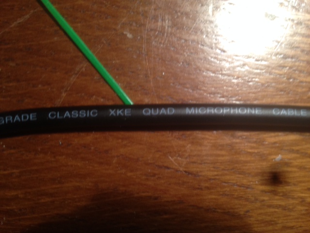

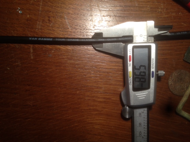

                      I can't believe Van Damme XKE STARQUAD is not available anywhere online in Germany. It used everywhere recording studios. Stage and live music shows. £1.50 per metre here in the UK. They will ship to Germany but you would be better using your local eBay/amazon with postage rates.
                        I found this offer from UK : https://www.ebay.de/itm/Van-Damme-XK...kcUP8pJ9jRK6XA
                        Very cheap 2,50 per meter. But this has a diameter of 6mm sounds very thick. I have seen a normal one with only 4,8 or 5 mm.
                        Do you think the GX16 connectors from china will fit? I think i will order from UK.
                        Edit: I found two different XKE Star Quad. One is the Star Quad miniature. I hope the 6mm one wil fit.

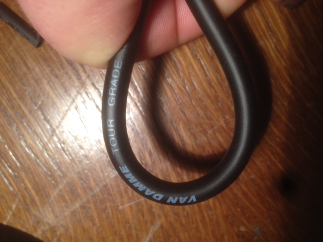

                          6mm is what I use.
                          Works 100% never had it fail. Its almost as if it was built for the job. Been out in freezing weather. Sharp rocks and salt water. Last thing you need is a cable fail after its all epoxied up. I know. I had to start a coil again after using an old USB2 cable. It was just too sensitive to being bashed about. You could tap your finger against it and it would false.
                            Perfect thank you for the pictures. Now i only need to find a strain relief in germany and i have everything for my new coil.
