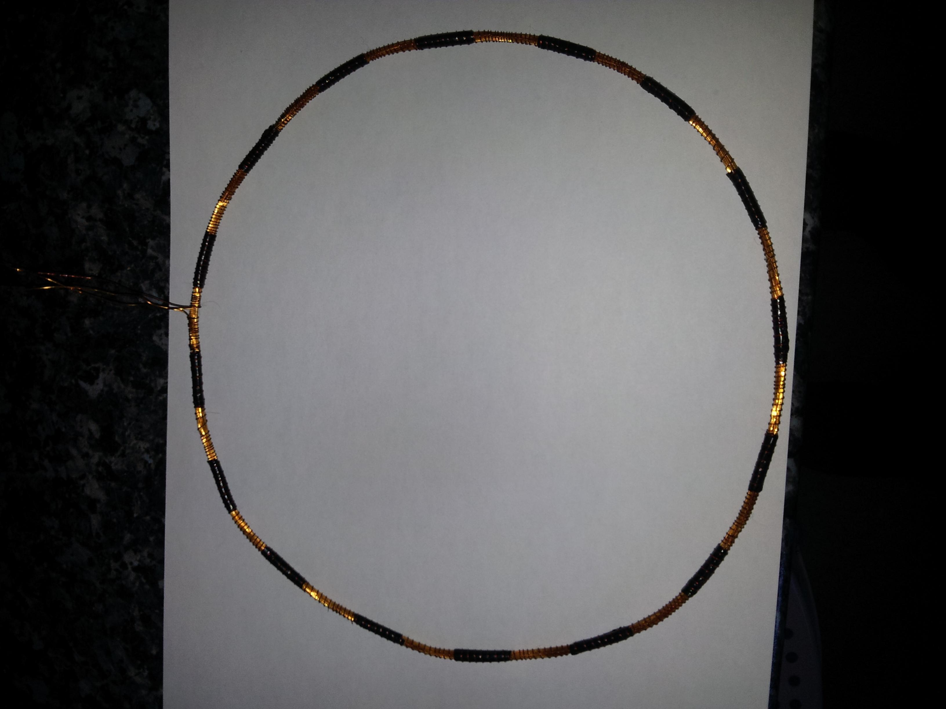

            with regards to your shielded verse unshielded coil. there is a very quick and dirty trick you can try
            to shield your coil, simply run a ground wire down to the coil then wrap some very thin wire (.125 MM)
            around the coil say 15-20 MM wide wraps hold on with a couple of bits of sticky tape and test.
            Leave gap between start and finish.
            There are also a few interesting remarks about adding resistors to coils in this old thread
              agreed i do the same thing rap a coil round the coil i used the same wire as the coil is made of, its that quiet when im close to metal objects i hear the change on the head phones and zero in on it, its the best shielding i have found

                I will try a wire wrapped around the coil as a 'drain' (shield) on the next round of tests.
                thanks for the pics and suggestion.
                This should work well on the Mono and DD coils but will need something like Graphite on the Concentric coil.

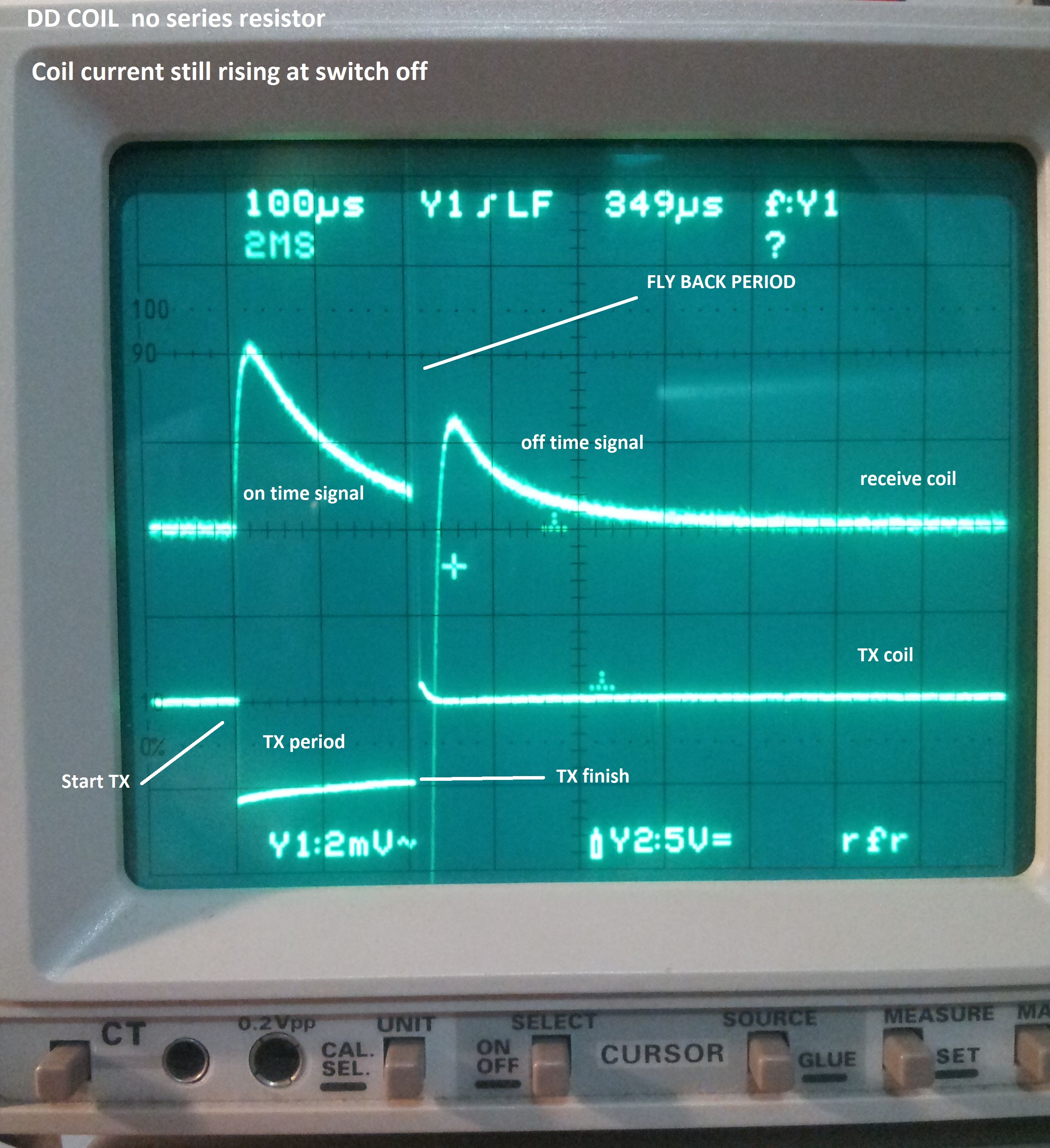

                          Hi Joseph, I have read in your various posts (example above) your explanation about the need to stimulate a target five times faster that the target's TC in order to fully charge it. You then refer to the need of the TC of the coil decay cycle to meet this requirement. May I suggest that it is the coil charge cycle and peak back-EMF change in polarity that does the target charging, not the coil decay cycle? Any thoughts?
                            Hello Elliot
                            I may have miss-understood your post but if your suggesting the high voltage back EMF is what is inducing eddy currents in a target then your mistaken,its the coil currents rise and fall and its rate of change that is creating the eddy current,the fly back is merely an artifact within the confines of the coil and the TX cct.
                              Hi Zed

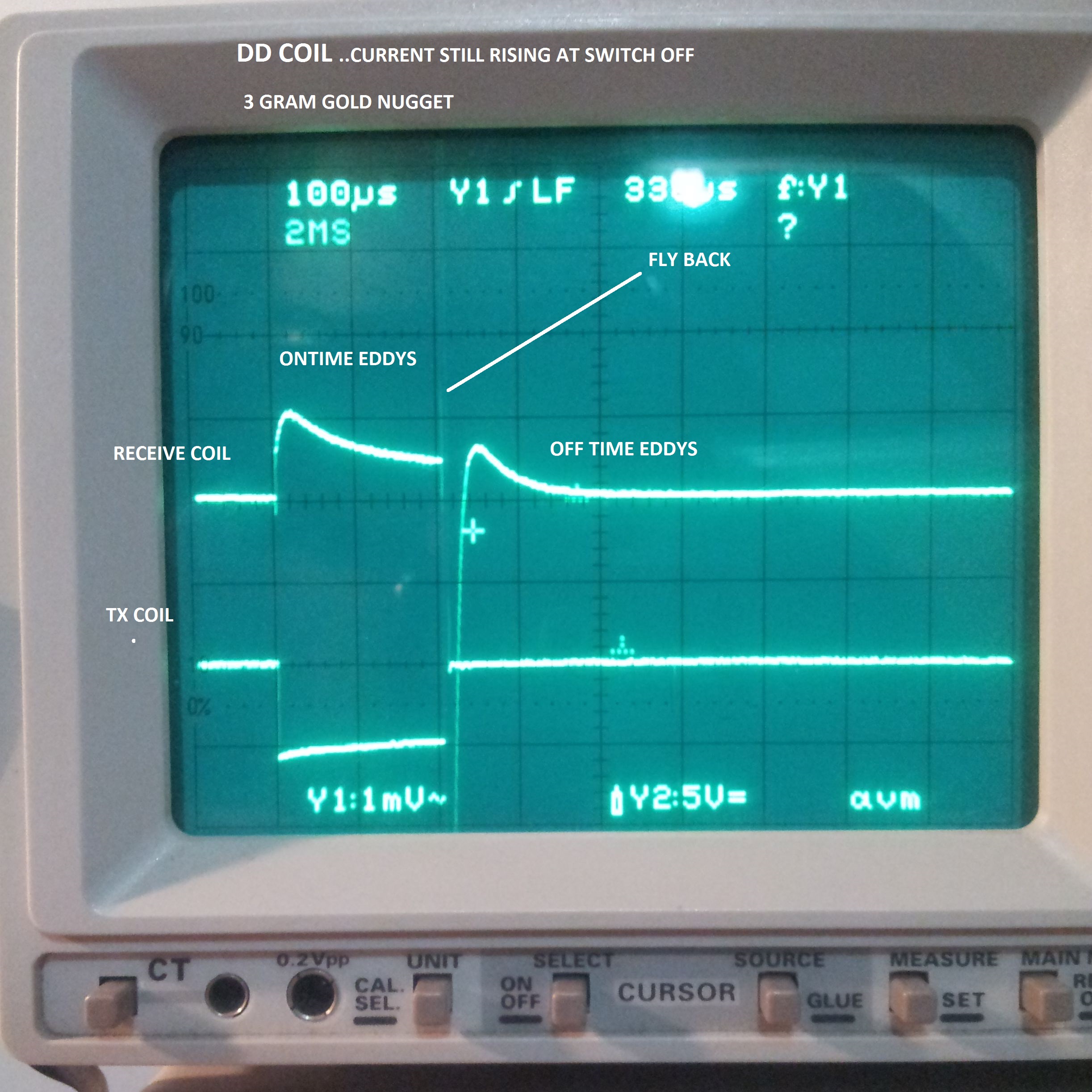

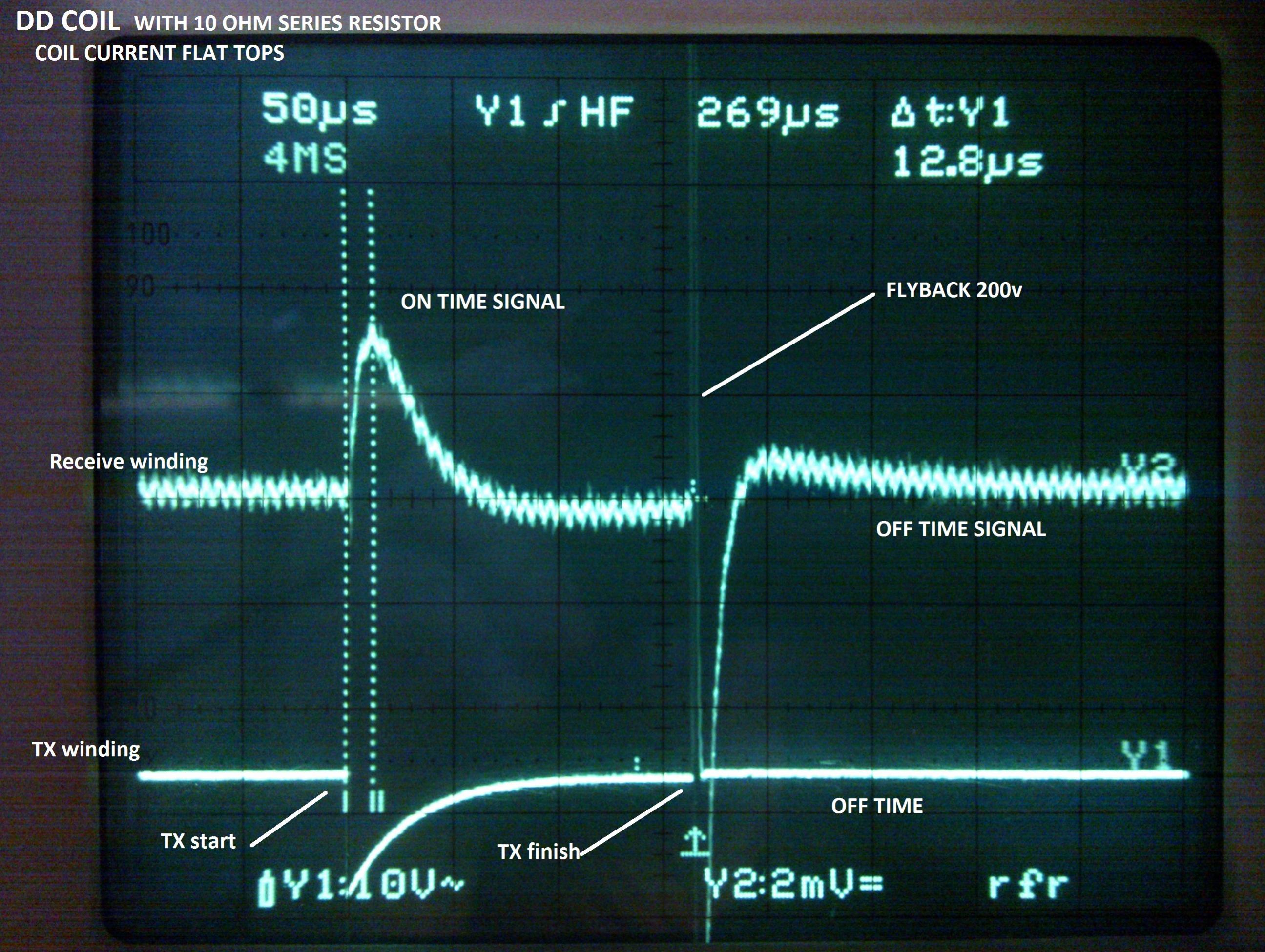

                              As I understand it ,the current in the coil gradually ramps up (coil charge cycle) during the pulse-on time (say 25-65uS). As soon as the current source is switched off at around coil Imax (i.e. when the coil voltage is low to zero), the back EMF rising voltage in the coil response kicks in and reaches a peak (say 400V for example). It is at the point of the quick change in coil voltage polarity at the peak of the back EMF when the eddy current in created in the target, which affects the decay time of the coil. From what I understand reading several of Joseph's text (and I may have read it wrongly), he is inferring that it is the decay part of the coil's signal that is charging the target, which I don't agree with. Now, if I am wrong, at what other point in time is the target (not the coil) charged, and how can you charge the target five times faster than the target's TC? Don't you just love science!
                                G'day Elliot
                                Eddys build on a target during the TX period,after the TX period is terminated the current ramps down,now depending on the TX cct and coil the eddys created during
                                the ramp down will cancel eddys from the ontime and then build eddys again with the remainder of the coil current as it continues to ramps down,it all depends on the
                                TX cct as a whole and the target.
                                When the coil current stops increasing and flattens out the ontime eddys will decay away because there is no longer a rate of change with the coil current,its static "aka DC",so
                                there will be no eddys to cancel as the TX terminates and the current begins to ramp down,on the other hand if the TX period terminates while the coil current is still rising then the ontime eddys
                                will in part be canceled out by the eddys that are created as the coil current ramps down,and if your going to ask why it will be because the ontime eddys have a opposite polarity to the eddys that are
                                generated during the current ramp down period,and so there will be some cancellation of eddys during the ramp down period ,now this is just a basic description at best,there are a lot of other factors at play as well.
                                Its not uncommon to see many references to the coil current ramp down period as "the flyback",typically they both happen at the same time,i even use the phrase as well,its convenient,but !, the very loose
                                use of the phrase can be very misleading,and over a period of time it becomes the norm.
                                Now you said quote "how can you charge the target five times faster than the target's TC? "thats a slippery question,what does it mean,are we talking time,or amplitude,or both.A targets eddys will decay
                                at the same rate regardless of how strong the EMF and rate of change is,and why do you want to charge it faster,whats the gain ?
                                I dont see the point of setting a TX CCT (including coil) up for a particular target TC when like here in VIC targets can be as small as lead shot or as big as a can,its a science for sure but no one shoe
                                fits all.Coil current thats flat top at switch off has its place and coil current still climbing at switch off has its place as well,neither one dominates over the other.
                                I have attached 3 pics of scope shots showing the TX waveform and the target signal as seen by the receive coil,using a DD 11" coil,the TX winding is 0.4 ohms,on one scope shot i have used a 10 ohm series
                                resistor in circuit so the coil current flat tops before switch off.
                                If you have a keen eye you will notice the 1.5 ounce gold nugget still has on time eddys quit late in its decay
