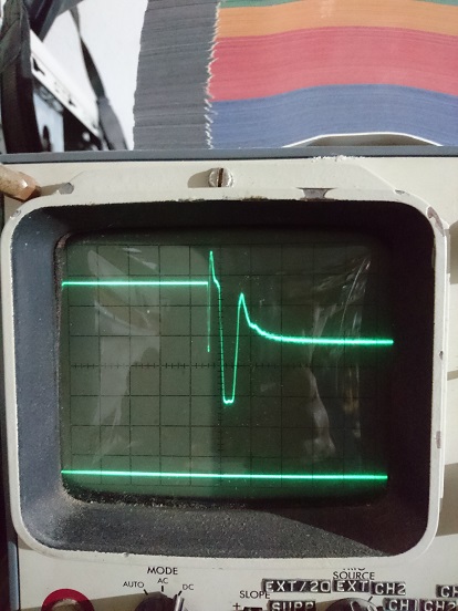

            Hi, I have another question that I would be grateful for any help with. Still working with the damping resistor, I would like to get this area clear in my head before I move on. I have made some mono coils and a basket weave, I think that is what they are called, and got what I believe to be a reasonable form on the scope.
            I tested the response of the detector with my wife's very thin gold ring and it picked it up at 150mm. 6ins.

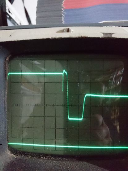

            I then under damped the same coil and the picked the same ring up at 250mm 10ins.
            Have I got this right or is it another stick I have the wrong end of.
              I am not sure why those pictures have turned out on their sides.
                1- slightly under damped does work and can see from the scope pictures sampling could be done a little sooner.
                2- there may be an increase of response, even if sampling delay is the same. In this case the damping R is no longer part of the waveform.
                I have also found slight under damping is a bit more sensitive. What is important is that there is NO ringing so the second scope picture looks ok.
                  Hi Waltr, thank you for you reply, could you explain what you mean when you say that the damping R is no longer part of the wave form.
                    Once the Coil Voltage reaches ZERO there is no potential across the R and no current through the R.
