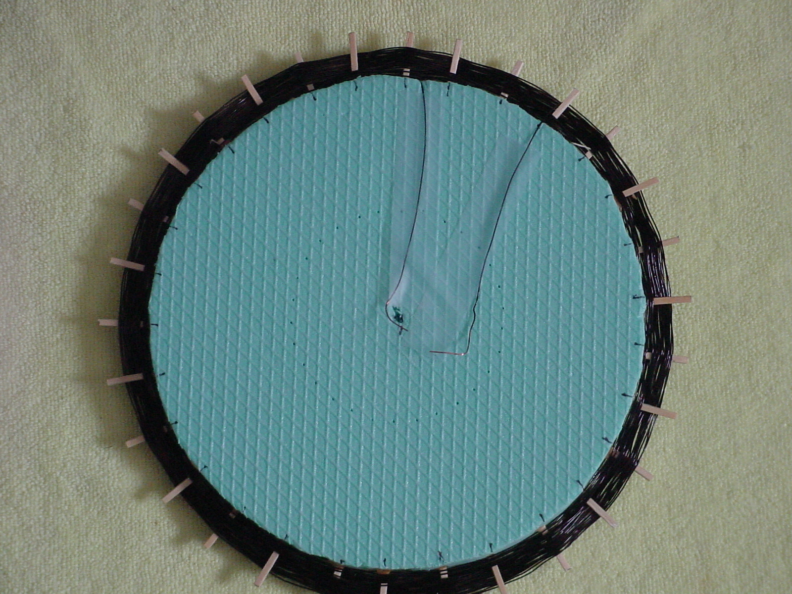

    I wound this coil with 660/46 Litz wire, basket weave. I might rewind the coil a little neater, The spec's are 290uh, .42 ohms, former diameter is 20.5 CM. This coil really works, it will detect a gold ring at over the diameter of the coil. I am using the Hammerhead for the test, I might use the little detector later if anyone is curious. Oh the coil has 60 feet of wire wound on the form. Thanks to all the members on the board for their help an support. I think it is time for me to fade into the wood work. Best to all Jim
    Looks good.
    However, my gold wedding ring is the Easiest target, strongest signal and is detected at the longest distance of any targets I have tried.
    This is due to jewelry being not pure gold, 14K is 58% Au, rest copper, and actually has a rather Low conductance so eddy current die slowly. Also a Ring shape produces much strong Eddy current (see the experiments in the book "Inside the metal detector"). Purer gold has a much higher conductance.
    The weakest signal of all test targets I have comes from a US Silver dime. High conductance and small, thin, solid.

      You did it with an even number of legs and got coils that did not differ. The next one made an odd number of legs.
        Wrong Picture

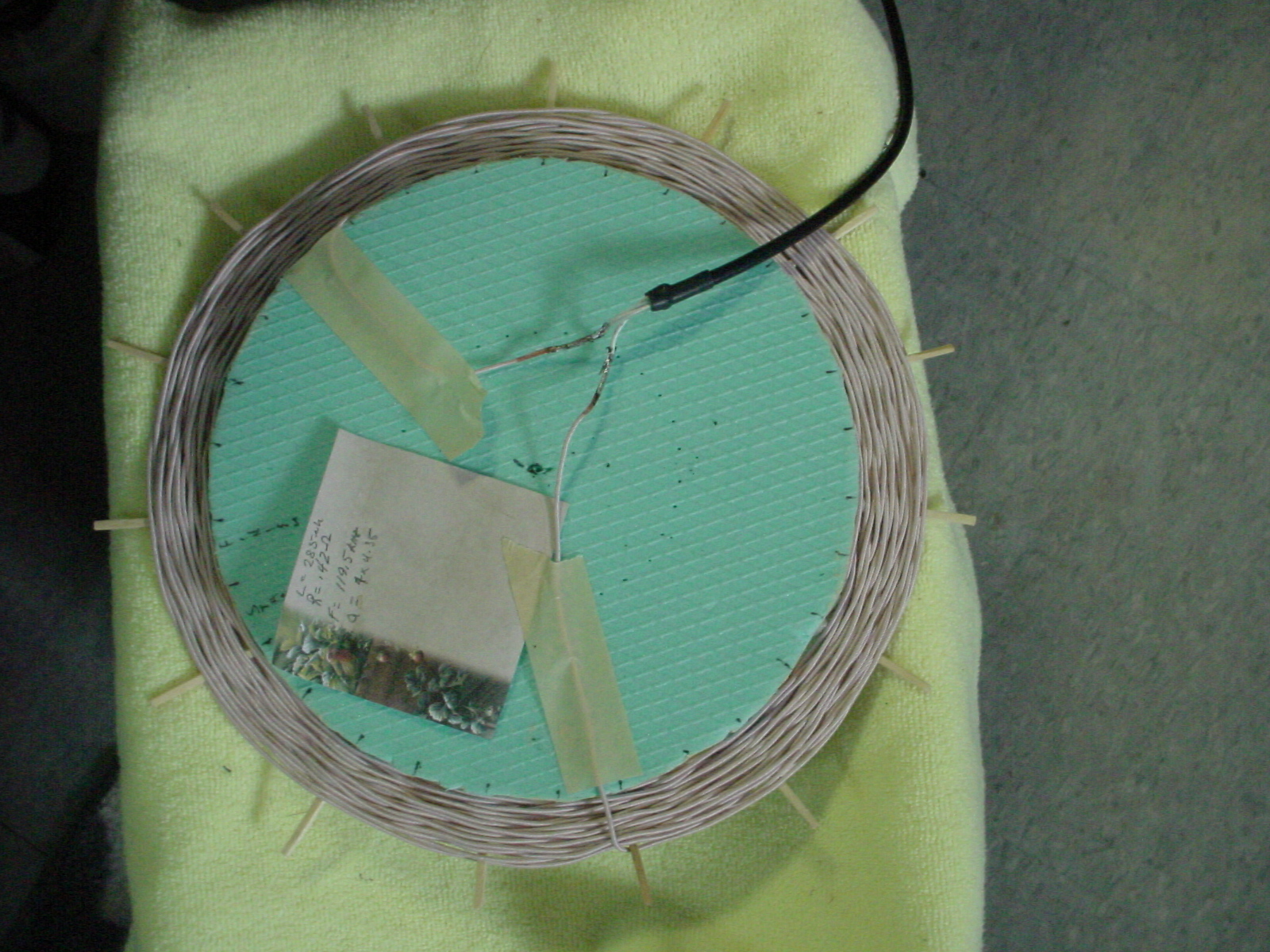

ID:	350605 I posted the wrong picture, this the final coil winding project for me. This is the Litz 660/45 wire. Back in the wood work My best to all Jim
          whats that type of wire like to wind ? is it flexible
            Originally posted by James View Post
            [ATTACH]42136[/ATTACH] I posted the wrong picture, this the final coil winding project for me. This is the Litz 660/45 wire. Back in the wood work My best to all Jim
            Thanks. The coil in reply #1 looked like enamel coated solid. Was going to reply but my eye sight isn't the best and didn't want to question it.

              The wire is very flexible an very easy to wind. Jim
                No I have not, what might I see on the scope? I measure resonant with a scope ,series resistor and scope. I have pretty good luck over the years with that procedure, Best to yo Jim
                  I did the air test with the PI-1 small detector and found very good results. The total diameter of the coil is 23.5 CM. I had the detector sounds off on a small 14k silver ring at 25 CM. The dime was at the same distance. Quarters and larger pieces of metal were sounds off at a greater distance. The gold fillings I test with are pretty small, about 1/4 size of a dime, they sounded off at radius or slightly less. I believe large Litz wire makes the magic in the coil. Best to you an your work. Jim
