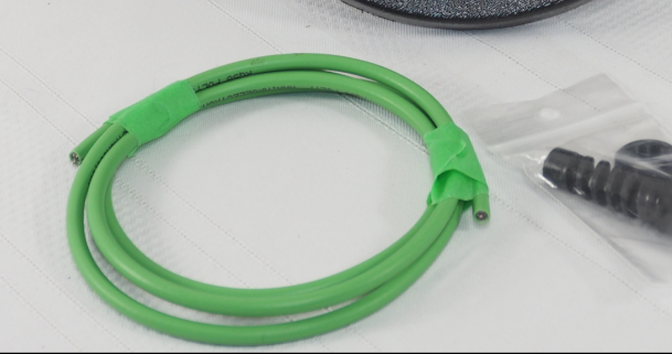

          I have a source for the type of coax used by Eric. Instead of orange in color, its green.

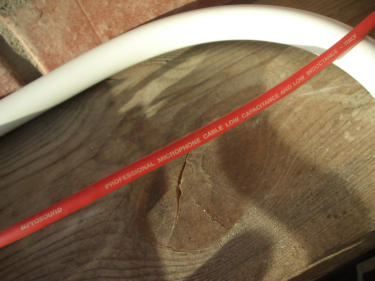

              an orange color cable on DEEPERS coil a type that i do not know.
              this marked microphone low capacitance low inductance, Italy.

                That's why I went looking for a polyurethane jacketed coax that came close to the one Eric used spec wise. The green coax (polyurethane jacket) I am using on all my land and water builds works great. And fairly flexible unlike many coax cables. I have used a number of Marine brand coax cables Ancor etc. but, they have a PVC jacket. Full specs on the Green poly. coax is detailed in the pdf in my above post.
