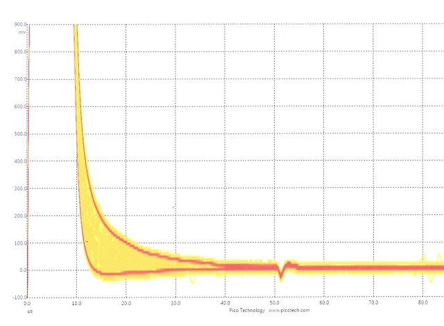

      There is one consideration to note concerning putting the damping resistor in the coil, and that's if you're being aggressive with early sampling. There's been quite a lot of talk in the forum about using the correct type of wire for the coil in order to reduce eddy currents in the wire itself. Minelab also have a patent concerning solder connections in the coil, and ways of preventing these looking like a target. The same will apply to putting the damping resistor in the coil.
      Unless you're pushing the envelope of a design, the bottom line is that it's basically up to your personal preference how you solve the problem. The solution a commercial company uses may be different to that required for personal use.

        I think that coil was probably made for the Goldquest which runs a short TX pulse at 10kHz. Most likely with standard damping the preamp is still saturated when sampling occurs.
          The more common place for RD is on the PCB, the reason seems obvious. Everything beyond this point becomes a function of the damping circuit. The coil characteristics are measured from the point of the connector at the end of the cable and not from inside the search head of the coil. This seems to be the overriding factor.
            Thanks all for the usefull replys. So after dbanner's comment i would say its better to keep few damping resistors on the female socket of the control box. At least for me it does the job as i'm not planning to use more than three coils and at the same time it will be less of headache to solder on the socket rather than spoiling the pc board.
            The Qiaozhi's comment about the soldering patent get me thinking what kind of a solution they may have? If it is just the wires i do not think it present a problem, cause it's tiny piece(unless it is the basket design KT315 mention somewhere which requires UTP pairs soldering). But if 1 watt resistor is there together with the soldering we have different movie;-).
              In the case of a dual field coil where two coils are coplanar, there are two damping resistors, where the value of critical damping resistor is determined by the electrical parameters for the total coil assembly and the value of second damping resistor( which I assume is placed within the coil assembly) is calculated from parameters of the isolated smaller coil.
                For this reason I believe a whites dual field coil should work on a whites surf master PI without mods(except for changing the 390 ohm RD on PCB), the critical damping resistor being on the PCB, the second damping resistor within the dual field coil housing.

                  Damping resistors work by suppressing the flyback pulse oscillation as soon as possible. These oscillations occur because the energy in a charged coil by the TX pulse current at turn off time creates a flyback pulse that can peak near 1000V for high power PI designs. Add to this flyback model, the capacitance added by:
                  1. Coil turn-to-turn wire capacitance
                  2. MOSFET COSS (output capacitance)
                  3. Coax cable capacitance (about 30 pf per foot)
                  4. Coil to shield capacitance
                  The rule of thumb is to keep the coil alone capacitance about one half the total measured capacitance at the end of the coil cable. This is done by measuring the self resonant frequency of a known coil inductance and then doing the math.
                  Then you have some collective value of capacitance that tends to absorb the flyback energy and causes that flyback energy to oscillate. Lower total capacitance has less energy to oscillate and requires less damping so a higher value damping resistor can be used. The sooner the TX pulse oscillations can reach near zero volts, the faster the RX circuit can be turned on. This is called critical damping. During this delay time any eddy currents remaining in the stimulated target are decaying. If you have a small target with a 2 uS time constant, in 5 time constants of that target's charged eddy currents will be at zero and have little or nothing to detect at a 10 uS delay. If you could drop the delay down to 7 or 8 uS you could begin to detect that target with some remaining eddy currents.

                  In keeping with the topic: where is the best location for the damping resistor. It depends on how many coils you plan to use and the range of damping resistor values that will critically damp each coil. If you have a range of coils that will critically damp from 800 ohms (faster) down to 600 ohms (slower coil) put a metal film (1Watt to 3Watt) 800 Ohm damping resistor on the PI circuit board. Make sure that it is not getting too warm as its resistance will get a little higher when warm. Then, when using coils that critically damp at lower resistance values you can add a smaller resistor in parallel to the circuit board value by locating it in the coil connector. Size is critical but since its value will be near 2500 ohms in parallel with 800 ohms its power absorption will be much less and you could get away with using a fraction of a Watt resistor. Use a metal film type.

                      Incidentally, the Fisher impulse schematic shows damping resistors (162R fixed plus a 500R trimmer) located on pcb at loop connector. There are also internal resistors in the
                      Search head. I suppose this is the best of both worlds.

                            I used damping tool circuit on my home built surf and just left it in as permanent. So I can vary from 381 to 1.6k depending on coil I use. I'm always making new coils for experimental purposes, trying to find what works and what doesn't work best, so variable damping is convenient when intending to use multiple coils. I can return to a preset position on tool for any previous coil.
                              I mostly put the damping resistor on the circuit board and only occasionally in the connector on low power PI's. I don't put them in the coil housing for the reason shown in the plot. The fast decaying trace is for no object in the coil, while the top trace is for a 1 watt metal oxide resistor, which is the type I generally use for damping. As you can see the resistor generated quite a substantial signal due to its internal metal endcaps. Higher wattage resistors are considerably worse. I like to start off with as flat a response as possible out of the preamp, without any superimposed metal signals. The Vallon VMH3CS detects this 1W resistor a couple of inches off the coil.
                                in reality a resistor is spiraled track done around a ceramic base. it is inductivity, but with very low value.
                                and yes, it can receive EMF and retransmitted it back.
