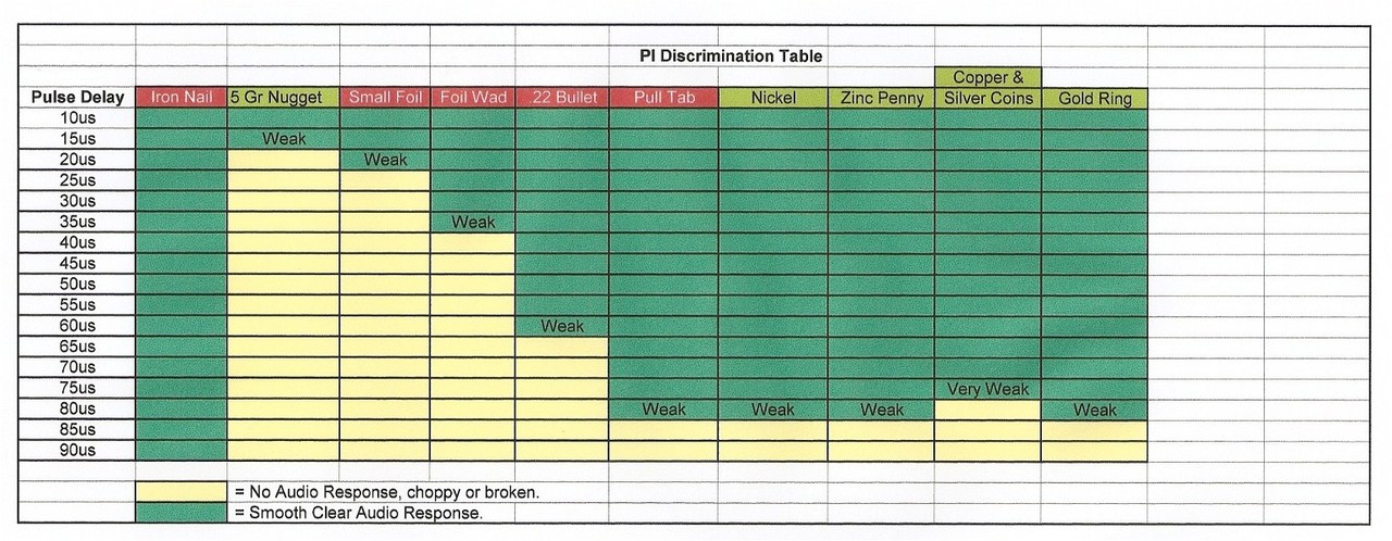

                            purported discrimination capabilities
                            , its more ELIMINATION than discrimination capabilities, along the lines of this graphic.
