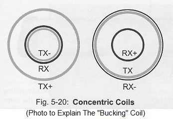

    #1..Does the Compadre (5.75" coil model) have a concentric/coplanar coil ?
    #2..Does the search coil include a TX, RX and a Bucking coil ?
    #3..Can anyone provide a photo showing inside this coil and how the windings are arranged ?

          Sorry I'm late reporting this; I called Tesoro on 5-19-2018 and was switched to Vince Gifford for answers to my questions and his answers are colored blue below.
          Question #1...Does the Compadre (5.75" coil model) have a concentric/coplanar coil ? His answer was "Yes". (See definitions below.)
          DEFINITIONS:
          Concentric...having a common axis...Coaxial.
          Coplanar...Lying in the same plane.
          Question #2...Does the search coil include a TX, RX and a "Bucking" coil ? His answer was "Yes".
          I've included attachments below to give visual and textual aids to help make the above definitions and understanding a "Bucking" coil easier. Vince prefers to call it a "balancing" or "tuning" coil.
          Also, I want to thank Carl Moreland and George Overton of Geotech Forums for the attached paragraphs and the Fig. 5-20 photo which are shown in their co-authored book Inside the Metal Detector and also available to the general public as a pdf document on the Internet at :http://www.geotech1.com/pages/metdet/info/coils.pdf
          The "Concentric Coplaner" photo I picked up somewhere else off the Internet, but don't remember where at the moment.
