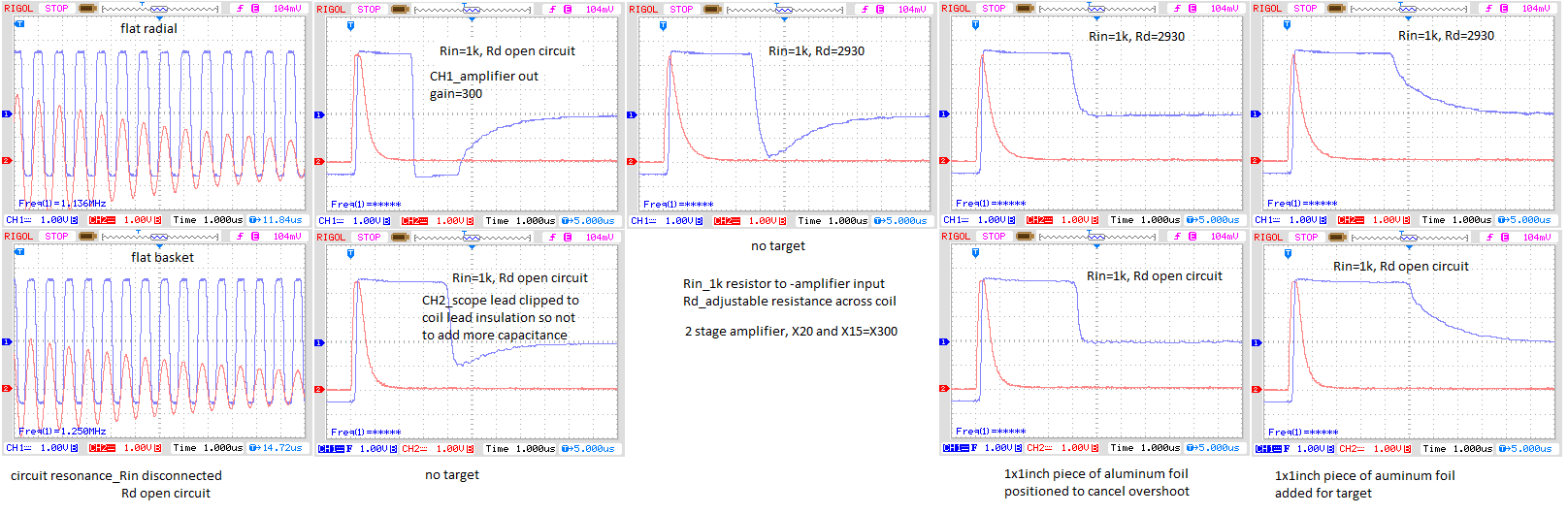

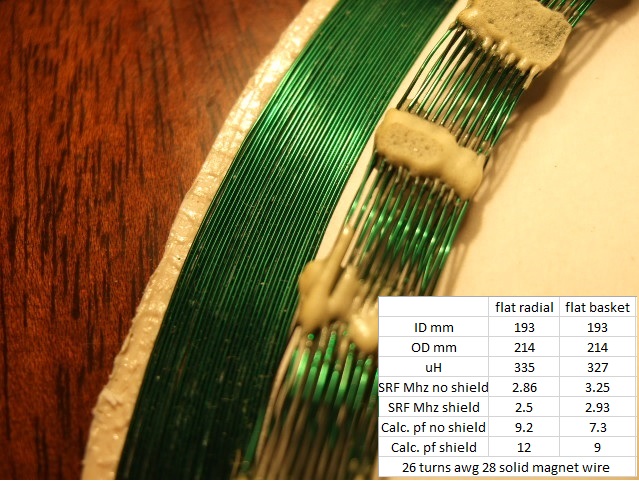

              I used AWG28 solid magnet wire to wind a flat spiral coil, no added spacing. Fast coil but flat basket looked better at amplifier out, don't know why. Interested in how yours works.
                Green, I totally misread you table, the flat basket shows better performance.
                  The difference in specs between the two coils( inductances, capacitance) seems quite small, only the SRF has a small spread, so have you drawn any conclusions as to why the flat basket perform a little better? Just a few puffs can make measured difference? I wouldn't have thought so.
                    I'm just trying to learn. Have read spiral coil is fast but adding shield makes it slower than other winding methods, not what I've found. Most of the time I have more questions than answers. I don't know why the overshoot, looking like the coil is underdamped or why the overshoot is different between the two coils. The flat spiral has a lower circuit resonance maybe some of the reason.
                    Added lead length and Tx circuit capacitance are higher than coil capacitance.

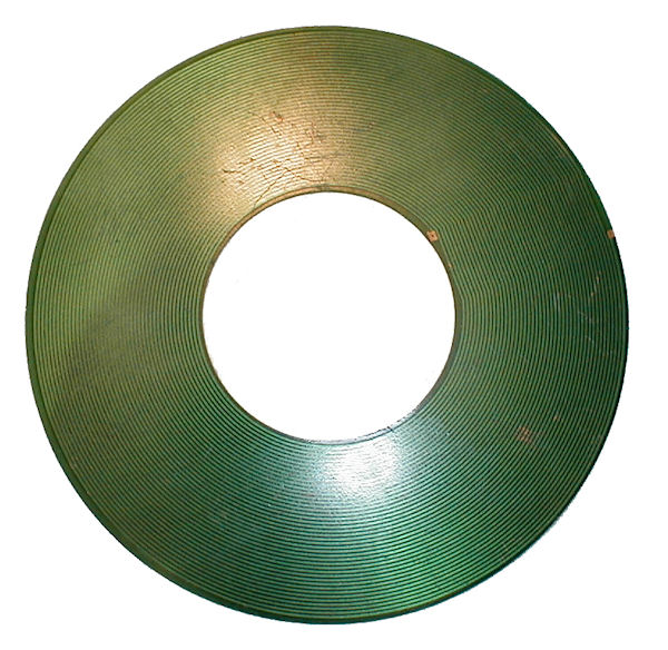

                      In looking at photo of the original surf pi coil, I took note of the spacing between the windings(pitch?). It looked to be roughly half the diameter of the winding itself(maybe more). This give me suspicion of some relevance to the optimal space between windings as half the diameter of wire. But who knows, very little information exists about spiral coil construction.
                      Do you have Coil32 calculator software? It is yet another coil calculator you can download for free. It has a spiral coil calculator which is very good and gives many parameters.
                      The White's coil has 42 turns. Which is of no relevance to your coil, just interesting to know.
                      Another observation is that the White's coil( I am assuming it's whites), the inner diameter looks to be half the outer diameter. This must have some significance, as the ratio is same as a standard concentric coplanar arrangement.

                              Not White's, Tesoro Sandshark. Printed spiral has the drawback of higher resistance, which may not matter in some designs. Assuming 1oz copper, a 1mm trace width is roughly equivalent to 31.5 AWG. One improvement that Tesoro could make is to double-side the spiral. A double-sided printed spiral using 2-3 oz copper could make a dandy fast coil. Easy & exactly repeatable.
