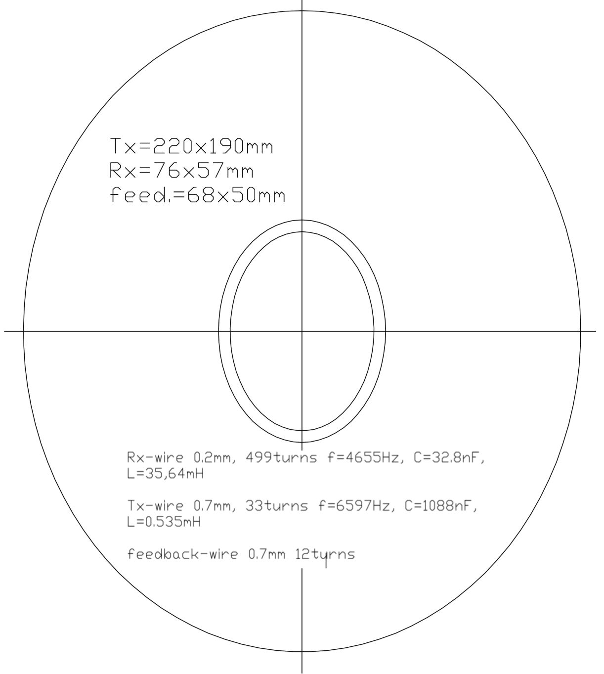

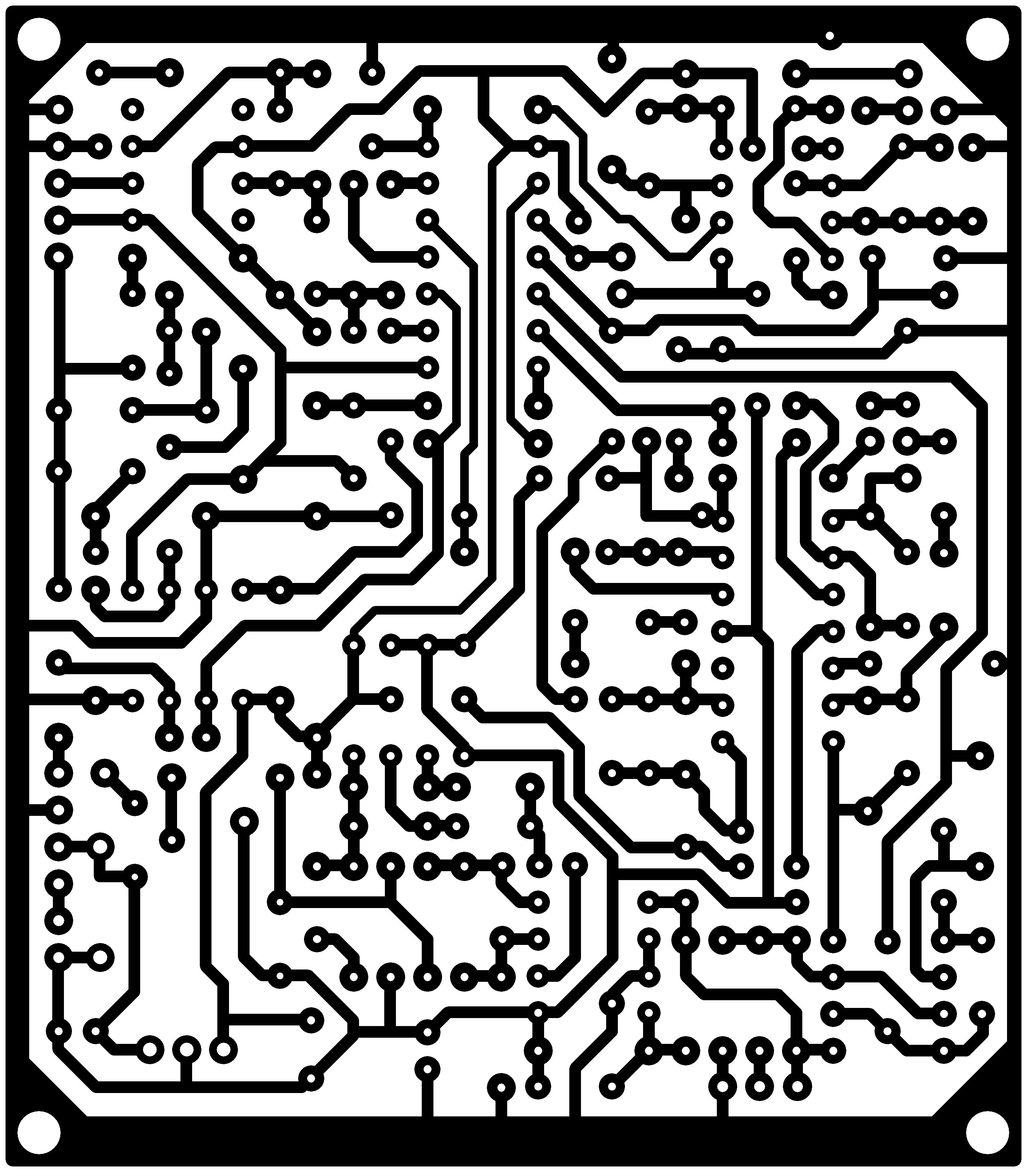

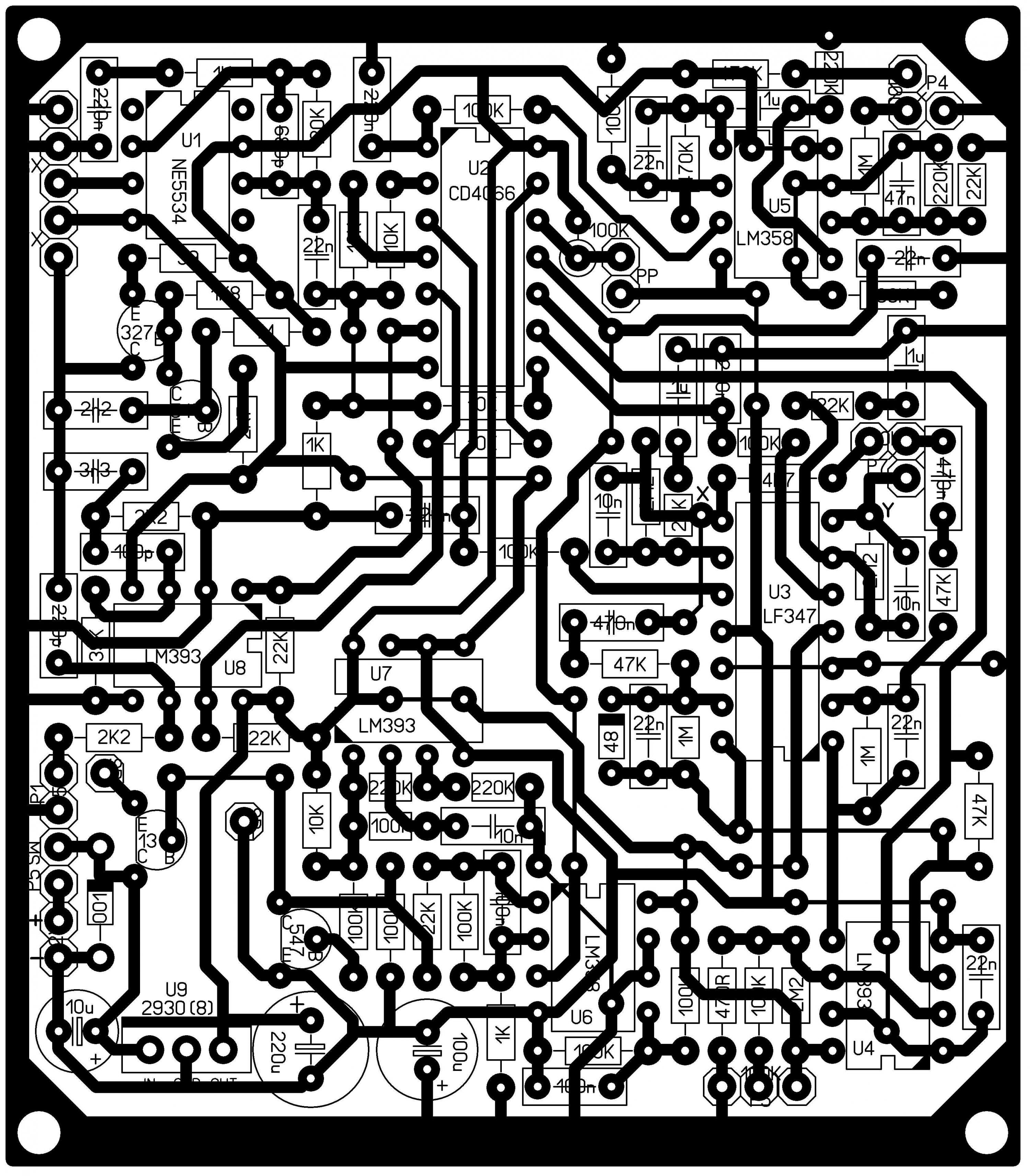

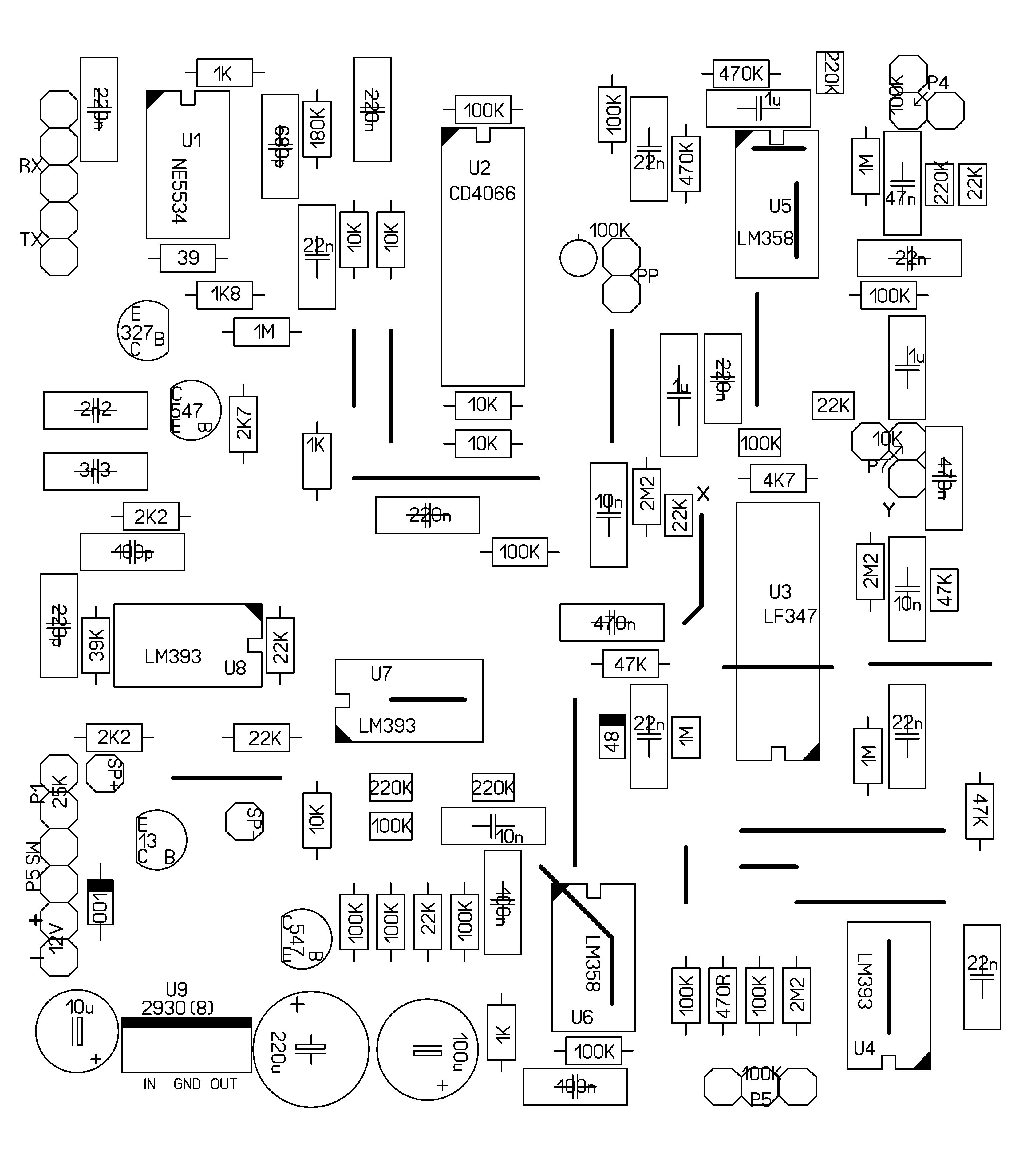

    Although I explored the forum I can't find information about the construction of the DD coil for the IDX PRO. Possibly also the PCB in a readable format with common programs.

    Hiya Tony,,,,,,Do you have the program Sprint Layout? I have a few different PCB layouts in Sprint that may help. Also, I have some layouts in B&W image. I have a few things about IDX Coil data, etc,,,,If you like can make a folder for you of what I have. Hope it helps. Marty
      TX=35 windings - cable 0,70 - 0,580MH , 1 uF in paralel 6590 Hz (Resistance 2.3 ohm)
      RX=270 windings - cable 0,18 -35,6MH , 33 nF in paralel 4680 Hz (Resistance 122 Ohms)

                        Hiya Anthony,,,,Thanks for your kind email. If you look in the folder I sent you, there is a folder with an IDX Layout inside,,,It is labelled 'Correct and Working files'. The name of the Sprint Layout file is just titled 'WhitesIDX'. Just in case you can't find it I have made the Sprint layout for you in B&W ,,,,Hope it helps. I'll post the 'DD' Coil for you soon. I hope the photos are clear enough for you to use. Let me know if you need anything else. Regards Marty.
                          Hi Marty,
                          I answer through the forum because I have some problems with the manager anyway I received everything (I responded with my wife's email) you sent me a lot of material and the PCB in B&W is very clear heartfelt thanks.
