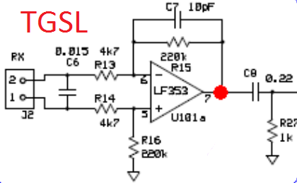

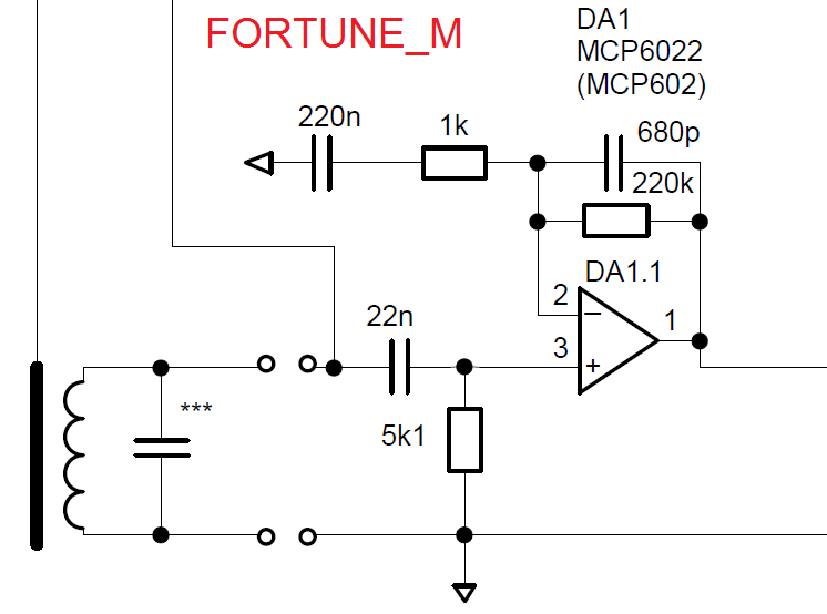

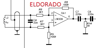

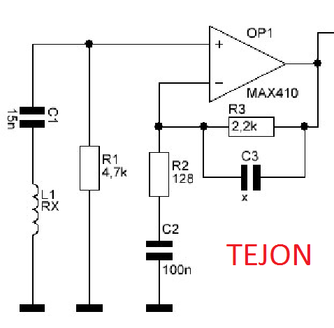

    In general, there are two Rx coil coupling structures that are:
    1) Parallel tank resonance circuit (TGSL and ELDORADO and RAPTOR devices)
    2) series Tank resonance circuit (CIBOLA, TEGON and FORTUNE devices)
    I've taken photos of these two different structures.
    1) What is the difference between the two parallel and serial connection structures in the Rx VLF metal detector coil?
    2) Why did TESORO's older machines use parallel tank structures, but used end-of-series tank resonance series?

      Probably there is no good, technical, answer as to why the engineer chose a parallel verse a series tank circuit.
      Both create a sinusoidal output.
        series resonance low ohms
        parallel resonance high ohms.
          At resonance, a parallel tank presents a high impedance to input current noise, whereas a series resonant tank presents a low impedance to current noise. So, the series circuit should be lower noise.

                  Parallel resonant: provides good filtering, provides voltage boost, but prone to huge phase errors. Searchcoils usually have to be matched to the individual machine or vice versa.
                  Series resonant with light loading: very little filtering, requires low noise op amp, but phase is reproducible. Searchcoils of the same series generally interchangeable.

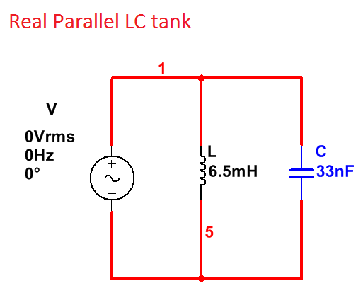

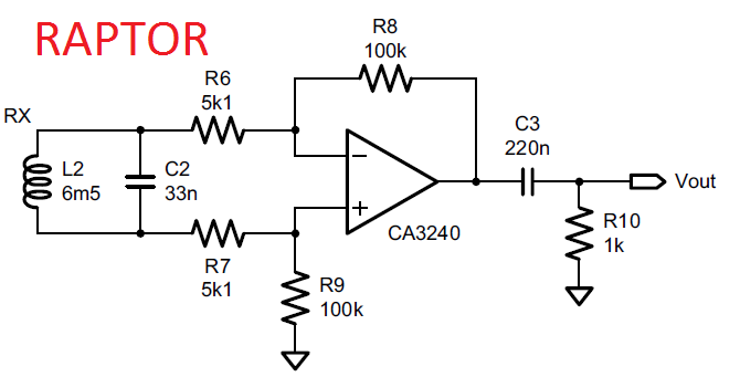

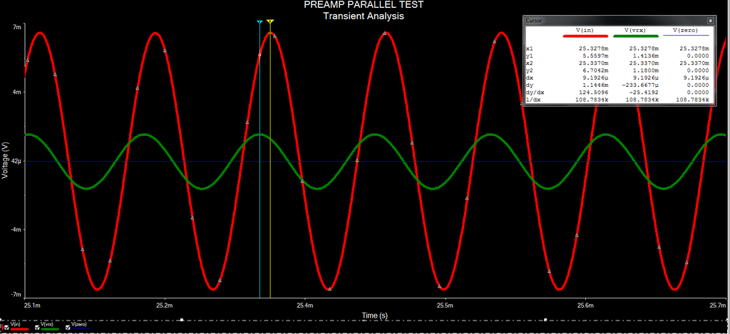

                      >First, let's consider a parallel RX circuit that I think RAPTOR is the best choice.

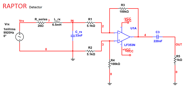

                      1) The first issue is that a parallel tank circuit is not really parallel. In fact, it is a series circuit tank, which in fact the voltage on the Crx capacitor is given to the PREAMP circuit input.
                      In the following I will display the RX voltage with an external source called Vrx and, as you can see, this circuit is contrary to the appearance of a parallel LC tank.

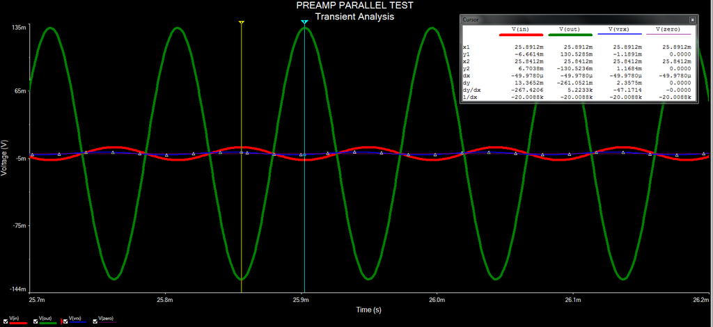

                      In the following, simulating the RAPTOR circuit and applying an effective value signal 1 instead of Vrx, we will examine Vin and Vout signals in the circuit diagram.
                      The selected frequency is the same as the RAPTOR transmitter frequency.
                      You see in the picture above that the Vin signal of the capacitor has a much larger amplitude than the Vrx source signal, as well as some of it. The reason is that here we are very close to the resonant frequency of the LC series tank. The next image displays the Vout signal relative to Vin, which is the only mirror with 20x magnification.

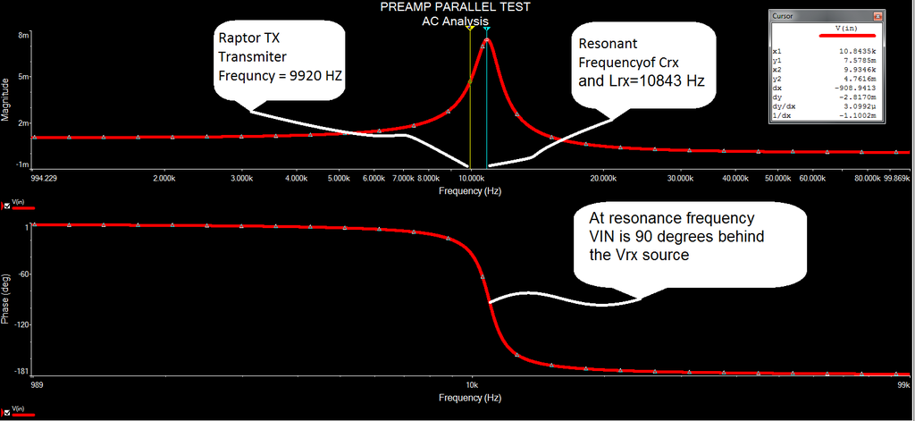

                          In the following, the frequency response and phase of the RAPTOR circuit are simulated and brought forth. As we see, at the resonant frequency, we have the highest amplitude amplitude in Vin.
                          And at resonance frequencies The VIN is 90 degrees behind the Vrx
                          Regarding this frequency response, I think that in the resonant frequency range, if there is noise, it is easily amplified and entered with a high amplitude, but in the other frequencies there is no increase in noise.
                          And the next thing is, I think the Vin signal range can change greatly with changes in L and C tanks.
                          And the other thing is that I think near the resonance frequency, the phase changes are also very severe and can break the resolution.
                          And the odd thing is why the frequency of the transmitter in the Raptor circuit is so close to the receiver circuit's resonant frequency ?????
                          But in Tesoro's TGSL metal detector, I think the distance between transmitter frequency and resonant frequency of the receiver circuit was much higher than that of RAPTOR.
