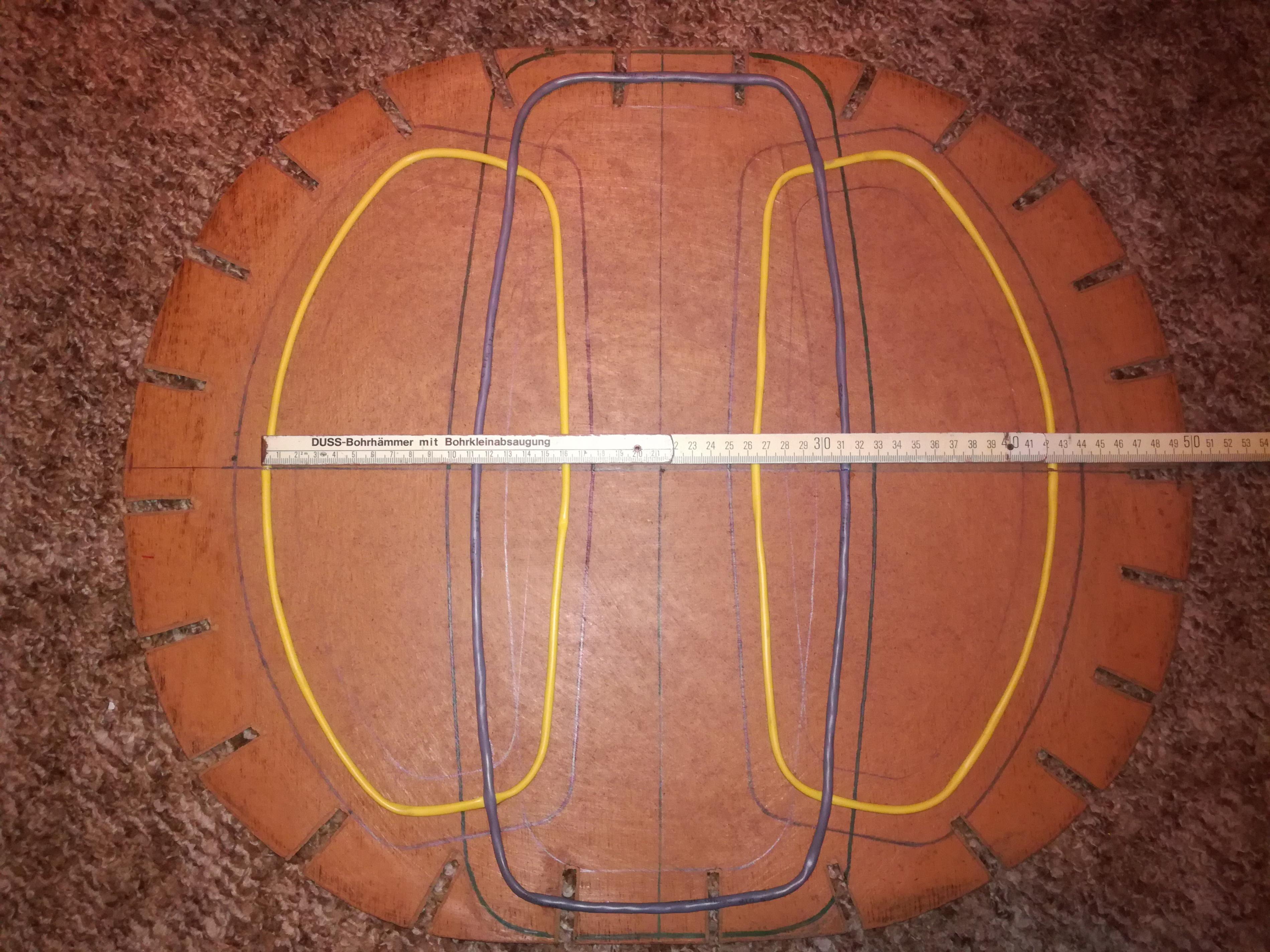

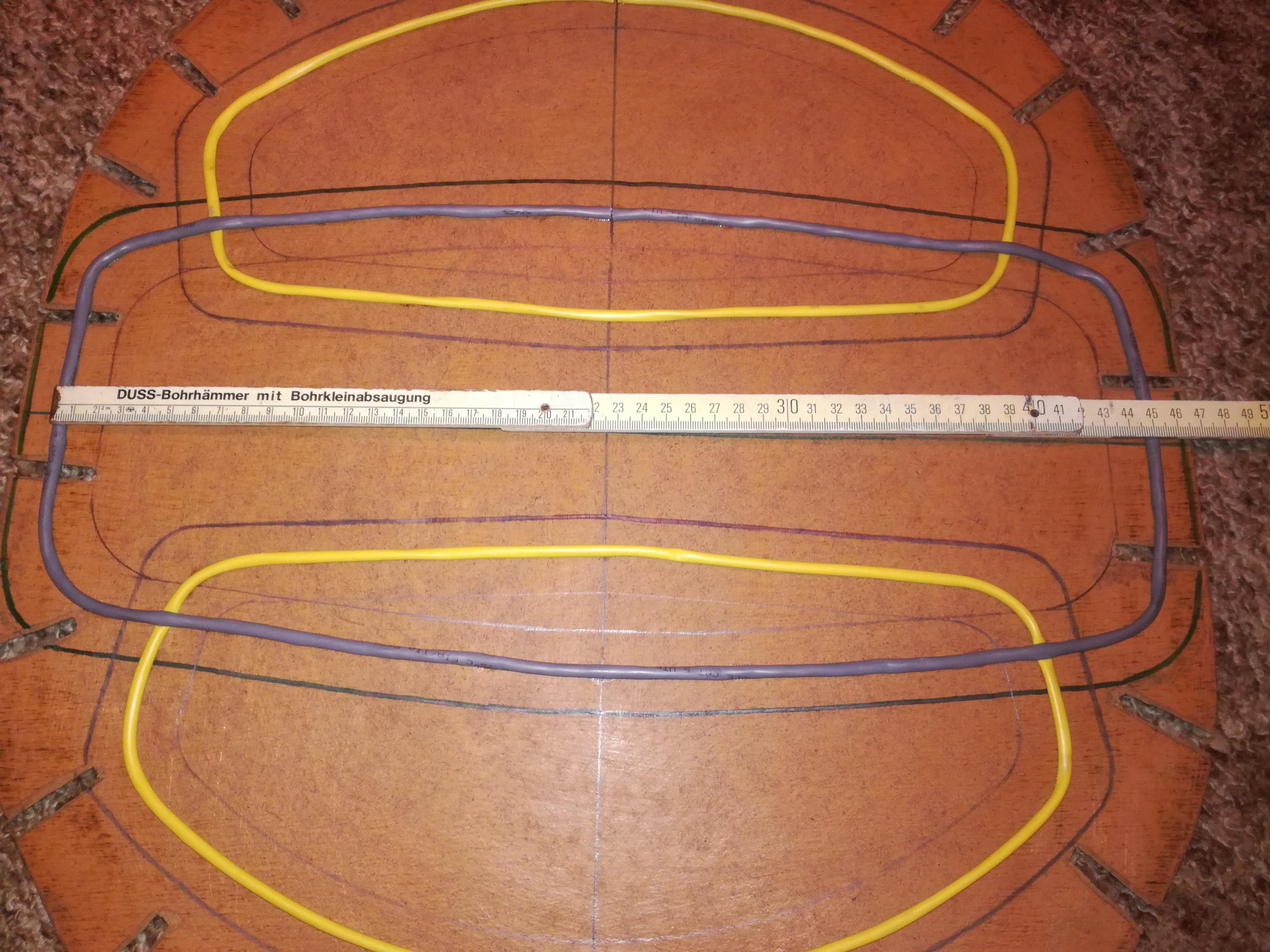

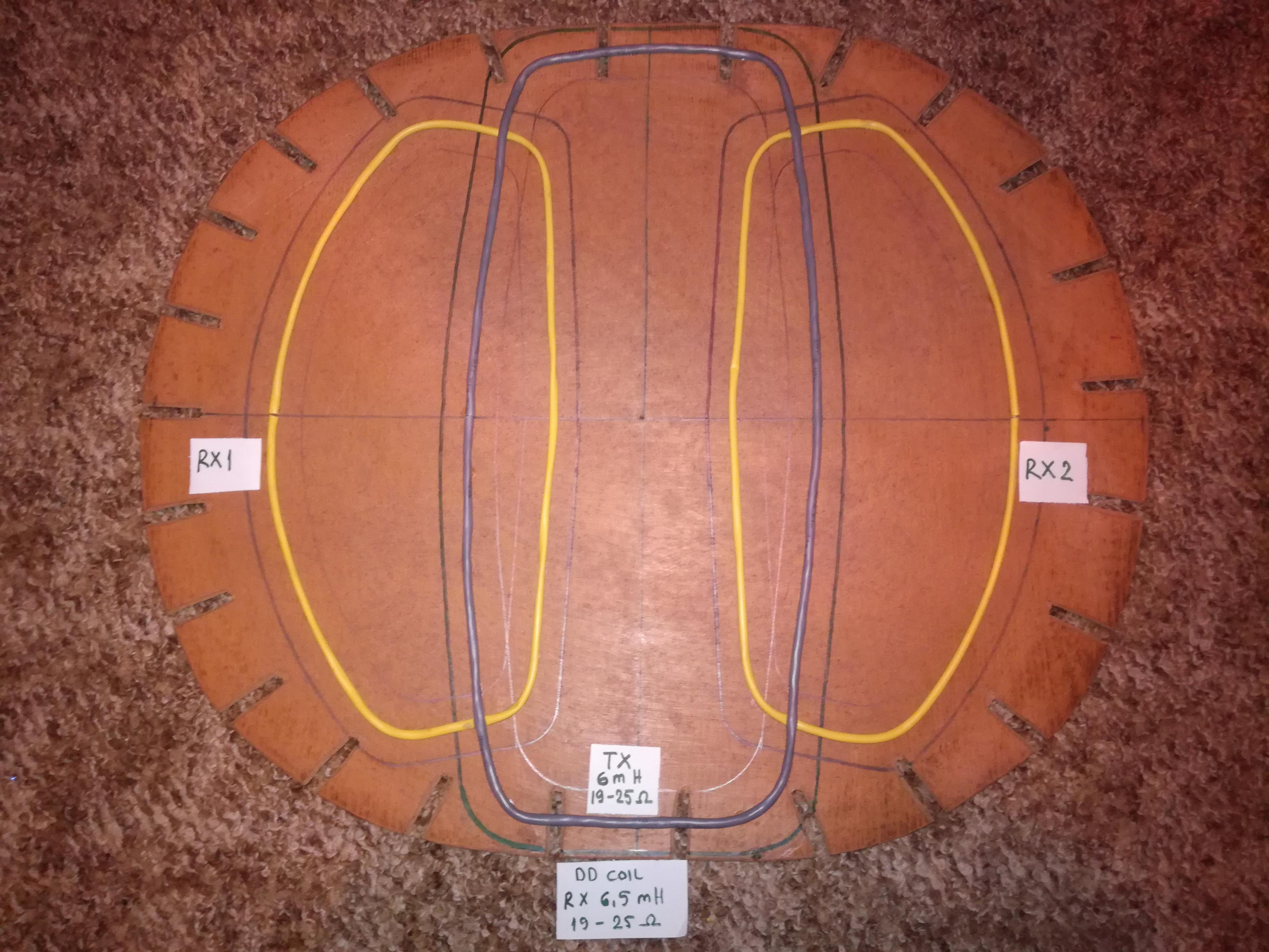

    I started creating a super D probe for IGSL.
    The dimensions of the probe are the same as the minelab 19 "
    I'm not sure how to connect two RX windings to one another. With DD coils, RX is 6.5mH and 19-25 ohm, but in this case there are two TX coils.
    If I use a 0.25mm wire, I should make two 13mH and connect in parallel, but then I would have a resistance of 10-12 ohm, or to make two 3.25 mH and batch serial, but then the resistance would be 40-50 ohms.
    The circumference of the TX winding is 120 cm
    The volume of two RX windings is 90 cm
    You might need to change the thickness of the wire.
    Do you have any ideas?
    Excuse me for bad English

    Search for "DOD" coils to find build info.

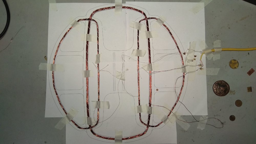

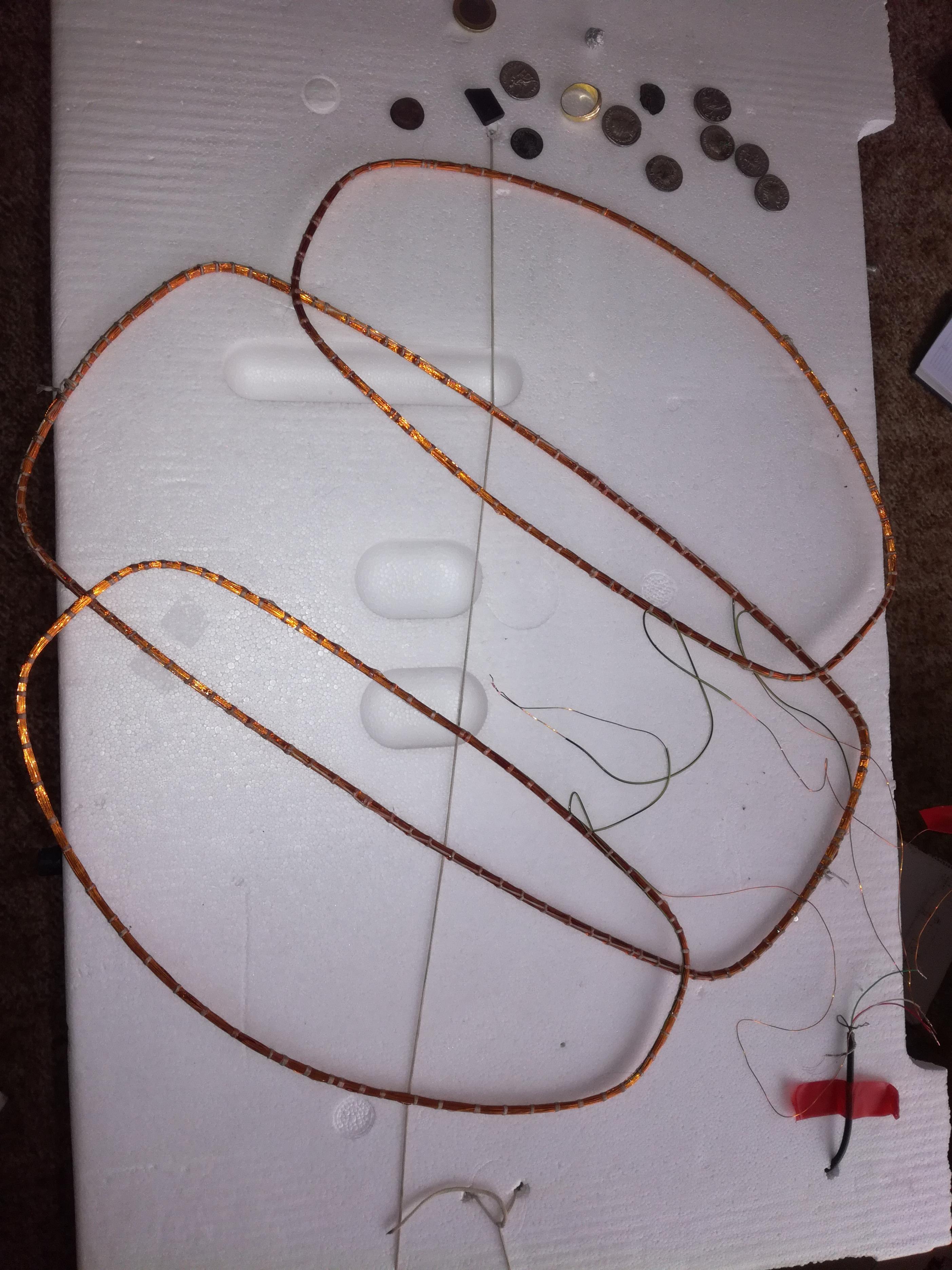

      Hope these helps you. I made a Super DD coil to try on my Mirage PI Detector but it's no completed yet.Marty

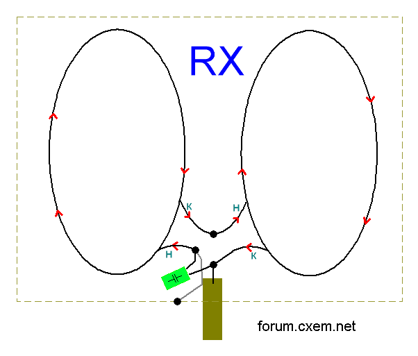

            @Pyramida,,,,The links and photo's I posted are for building a VLF coil,,,one transmit coil and two receive coils,,,for VLF (Minelab),,,all I was saying was that I built the same coil and wired one of my Mirage PI's to use a balanced coil configuration. One of the diagrams I posted gives you the answer to what you asked,,'How do I wire the RX coils?' - you have to wind them both in a clockwise direction,,,the 'End' wire of the rx coil on the left connects to the 'Start' wire of the RX coil on the right,,,,both coils should be 3.25mh each. Regards,, Marty

                        Hiya. If you're making the Super DD coil for the IGSL - Tesoro coil version, then you have to make 2 x rx coils,,,each rx coil is 3.25mh,,,and you make 1 x TX coil at 6.0mh,,,,The capacitor in parallel depends on frequency. You will have to try different values until you have the correct frequency. Regards,,Marty.

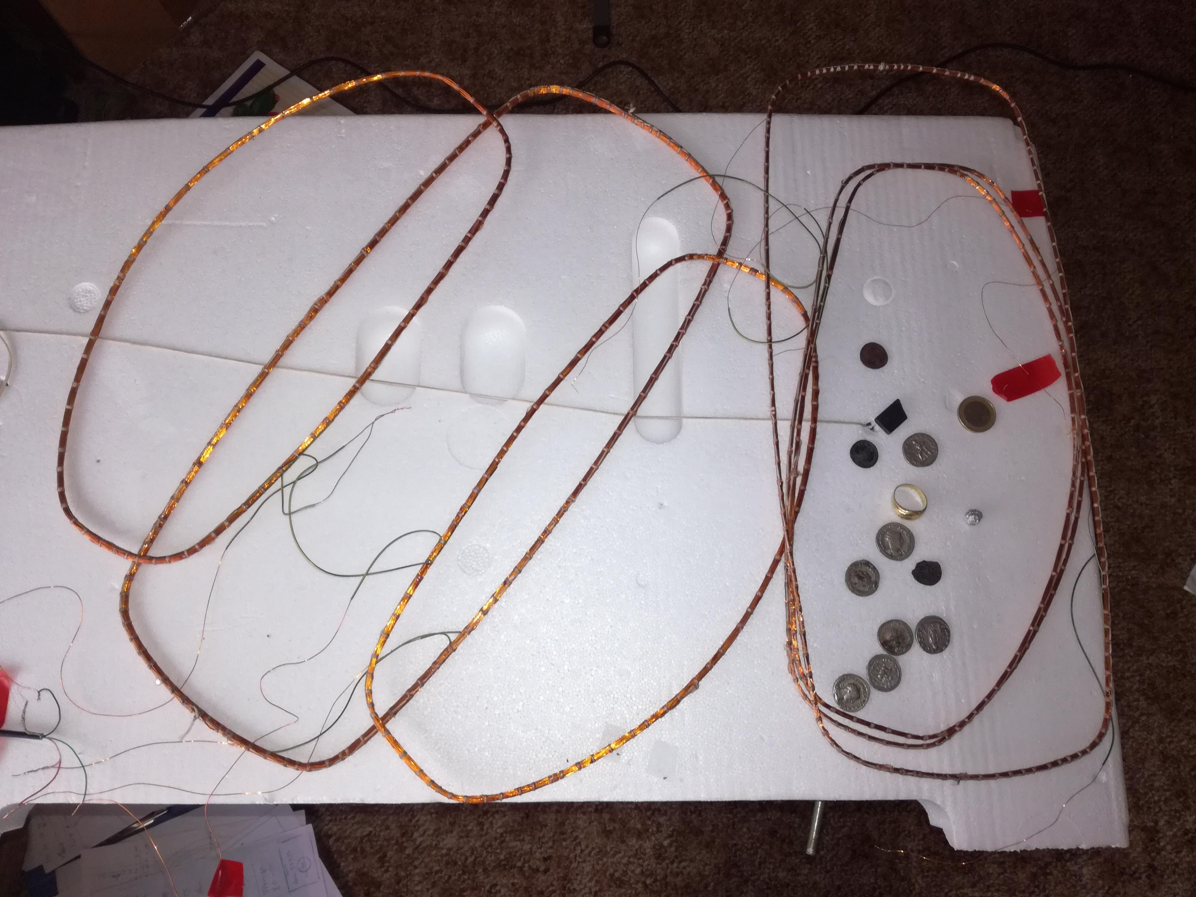

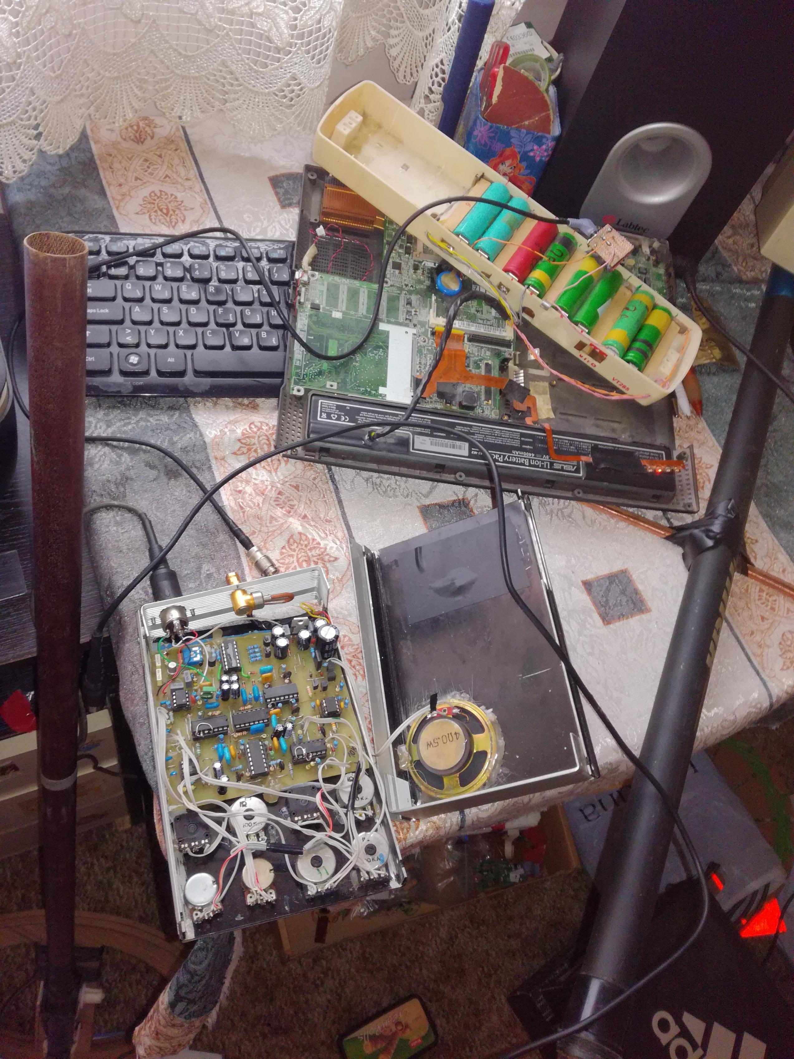

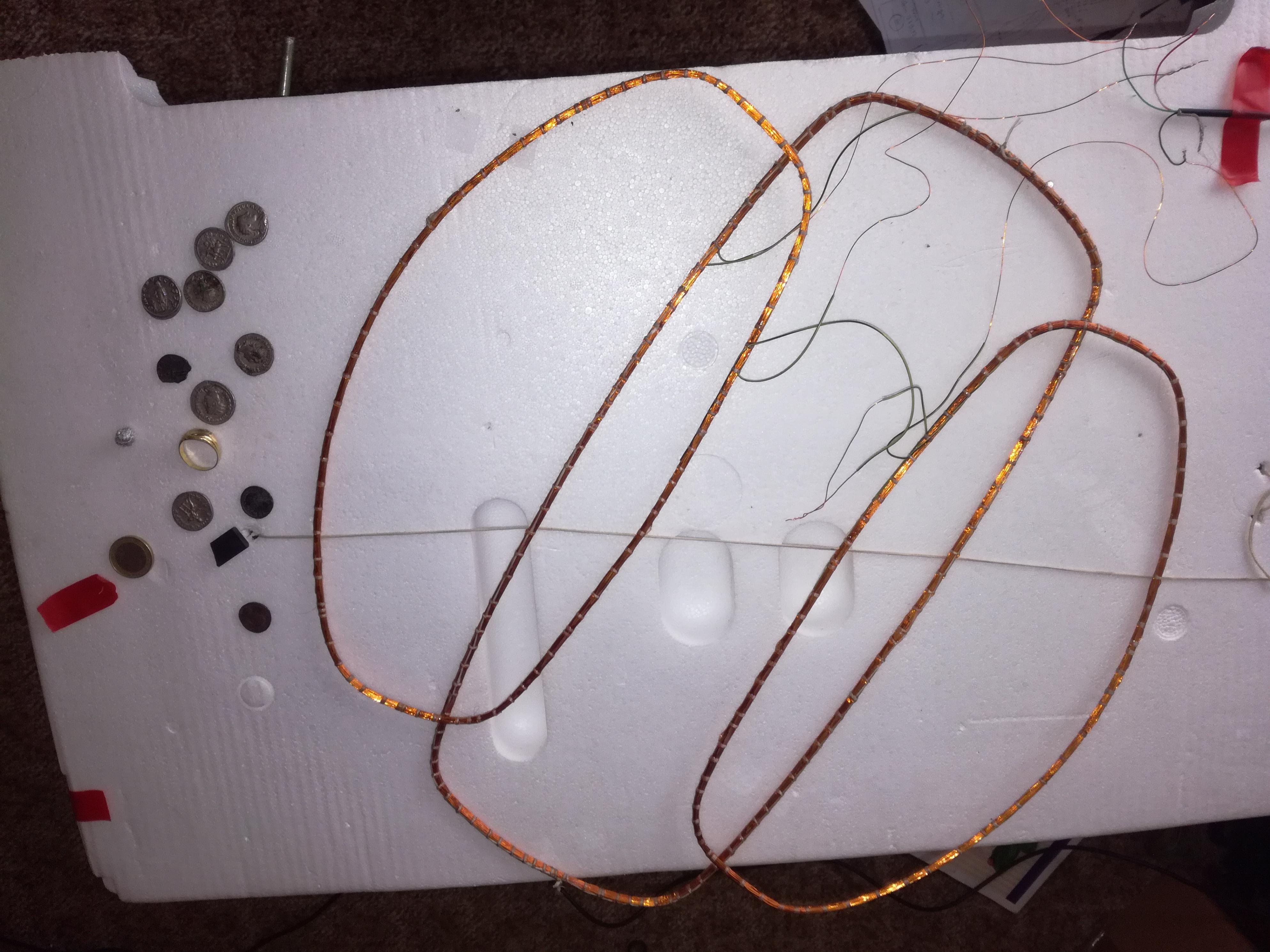

                              I made two coils of wire that I had at home.
                              They are wires of 0.25mm and 0.40mm. According to the calculation, there should be 0,30 mm wire for the Q factor, but I did not have it.
                              The inductances are exactly TX 6mH and RX 2x3.25mH, connected in series.
                              0,25 TX 6,02mH , 28,3ohms , Q44 2xRX 6,48mH , 37 ohms , Q15,88
                              0,40 TX 5,97mH , 12,4ohms , Q18,31 2xRX 6,54mH , 16,6 ohms , Q35
                              Air detection for both types of coil for 1e and silver coin is 40cm.
                              Then I brought a 12v direct to the oscillator instead of 8v and the detection jumped to 46-50cm !!! Zip lighter at 68-70 cm.
                              when you are very close to the probe you have 4 sounds and how you get off the number of drops, and in the end only one remains. This is very useful for determining the approximate depth
                              Coils are not protected and are very messy with long ends of the wire. They are zeroed to 0.04mV. In the room with lots of noise everything works steadily.
                              Now I need to find a 0.30mm wire and made shielded coils and test again.
                              Can someone say how much Q factor is best for this detector?
                              Do you have any idea of testing while I'm still in the detector?
