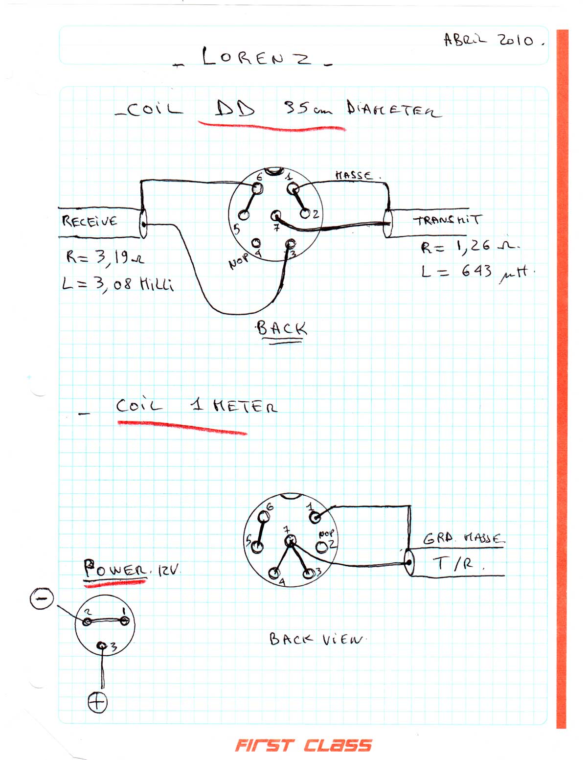

pleas i have deep max lorenze Z1
there is a picture of connector schema . but in back of connector a resistance between the 1 and 2 .
i found it without color code. i test it its domaged.
can anyone have a complete schema helps me?
i need also to create a Cable coil 12 meters perimeter if possible.
