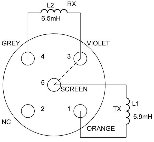

          Is there a standard wiring config. for these 5 pin connectors? (TSGL DD coil)
                The dotted line indicates that pins 3 and 5 are connected together in the search head. This is because the TX and RX loops share a common connection that needs to be connected to electrical ground.
Name:	Tesoro Coil Connections.jpg

                        Just a update. I did in fact receive the connector and Yep, it's da one. Super Happy Camper. Thank You Everyone. When you wire these up don't forget to put the Ground ( Shield ) related pins on the Negative legs of the coil.
