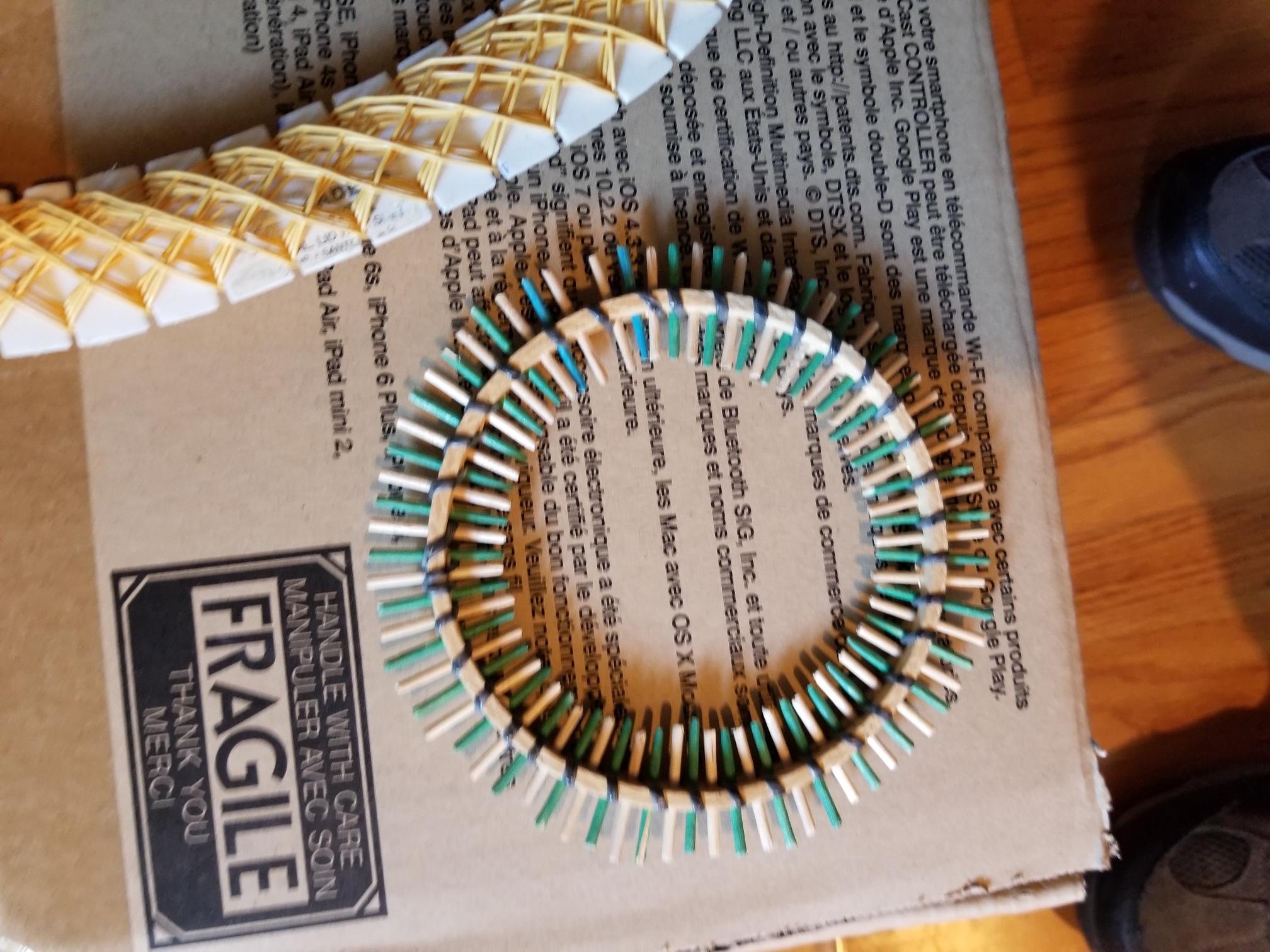

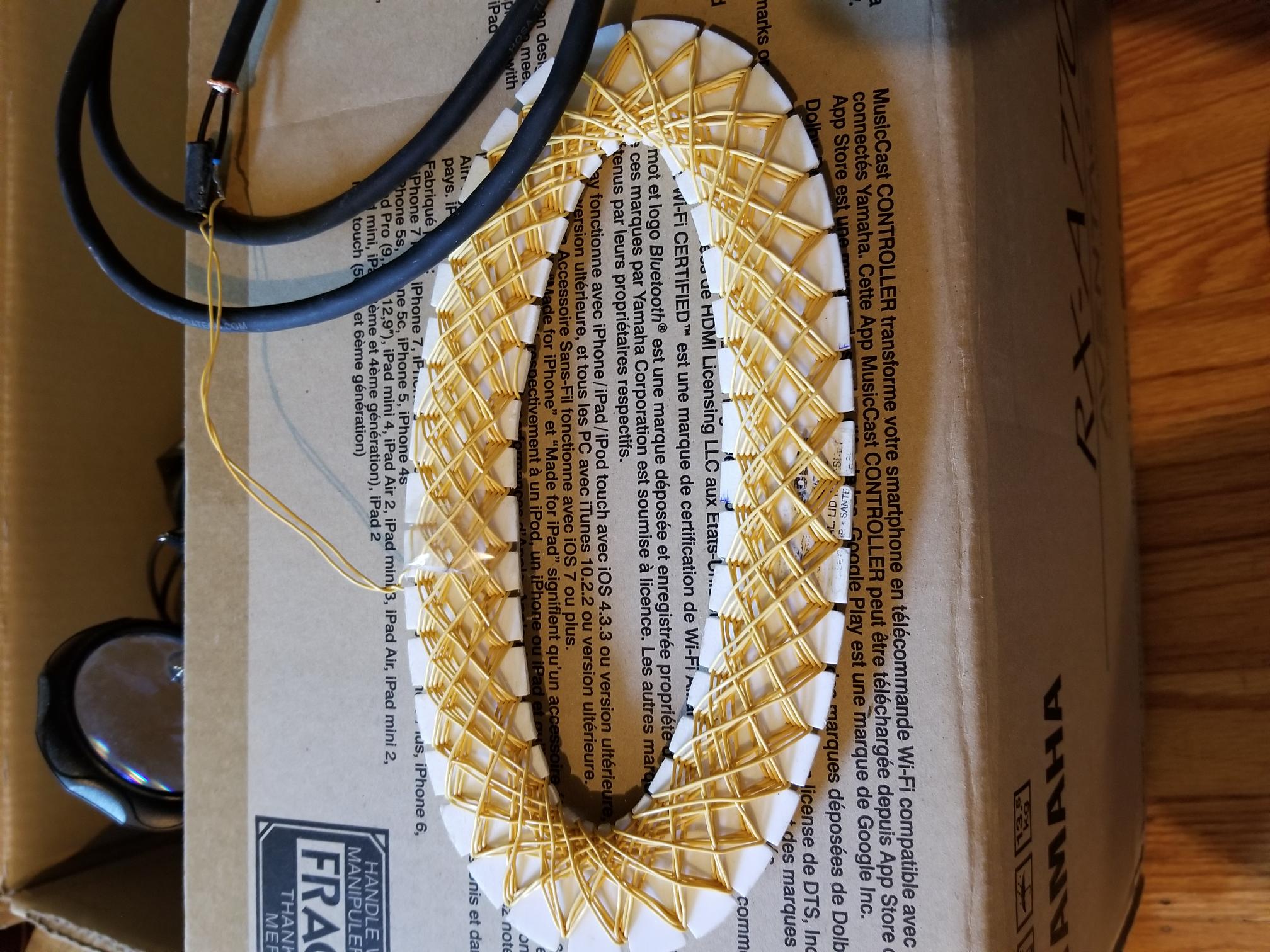

        I want to first say thank you it was your race track coil that has been a inspiration me to experiment with these coils.
        Ater biulding this one Click image for larger version
        Some of the problems you faced such as a tight inner radius at the corner became aparrent. Thats when I started thinking of a round form.
        The way the wires bunched to the inside of the corner and the pionts grew on the outer edge looses form.
        I dont know if it will really be any better than the traditional wind but one place I do think it is improved form the traditional form is at the slots themselfs.
        The wires pinch together there and stack tightly I think I have eliminated that. Once angain any rael benefit is still to be seen.
        On the second photo in the first post where the wires are parallel, that was a test wrap to see what it would look like if I did not skip a slot on the wind.
        Is this the parallelism you are refering to Or the inner winds of the finished coil?
        It took ten wraps before transition that way. So The last photo is the traditional 3dss wind but I skip back to another hole form like having all the slots on the traditional form and using them. this also gives two wire gaps between the layers as you transition sides.
        Do you think any of these changes are beneficial enough for me to continue in this direction?

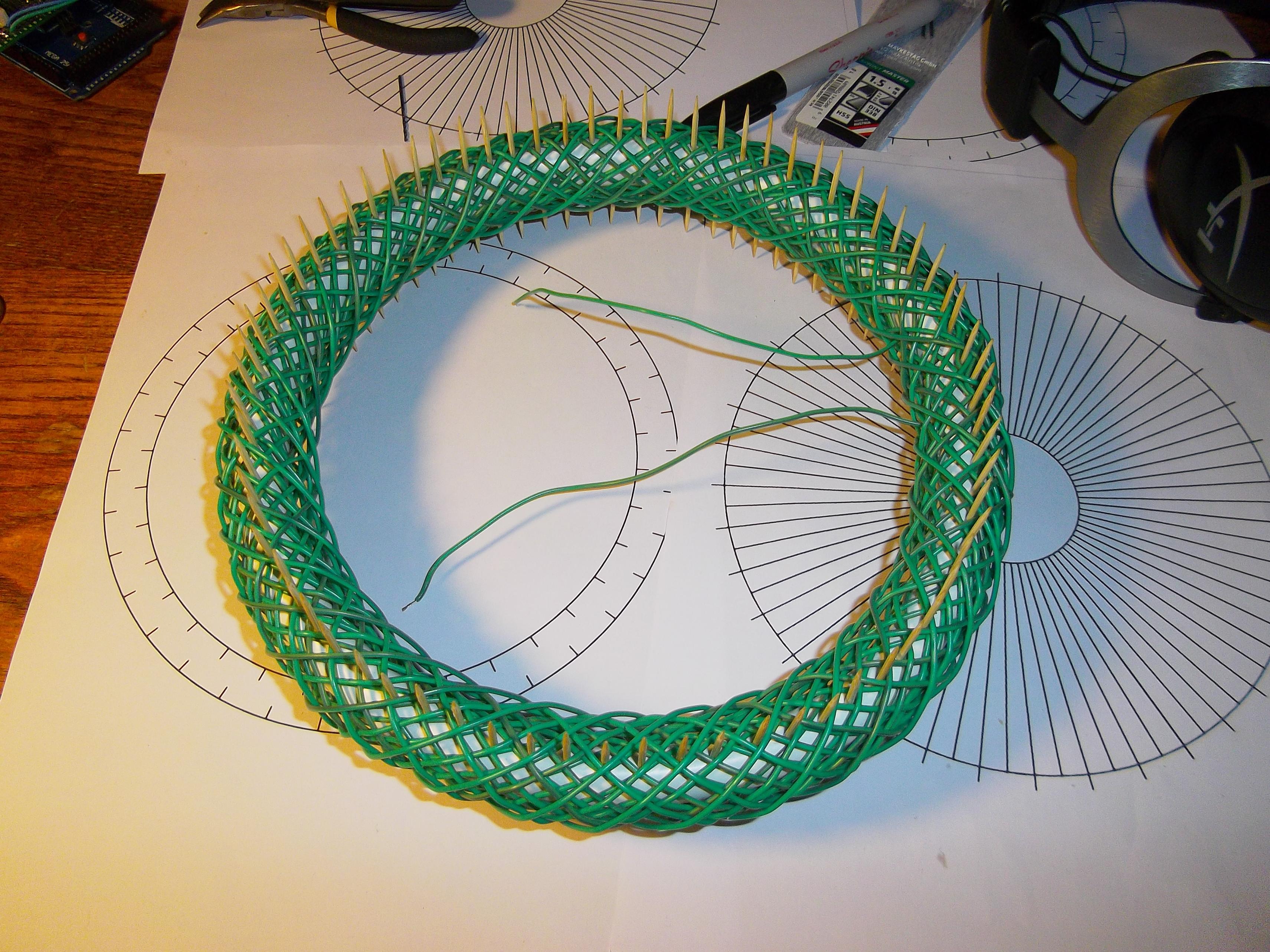

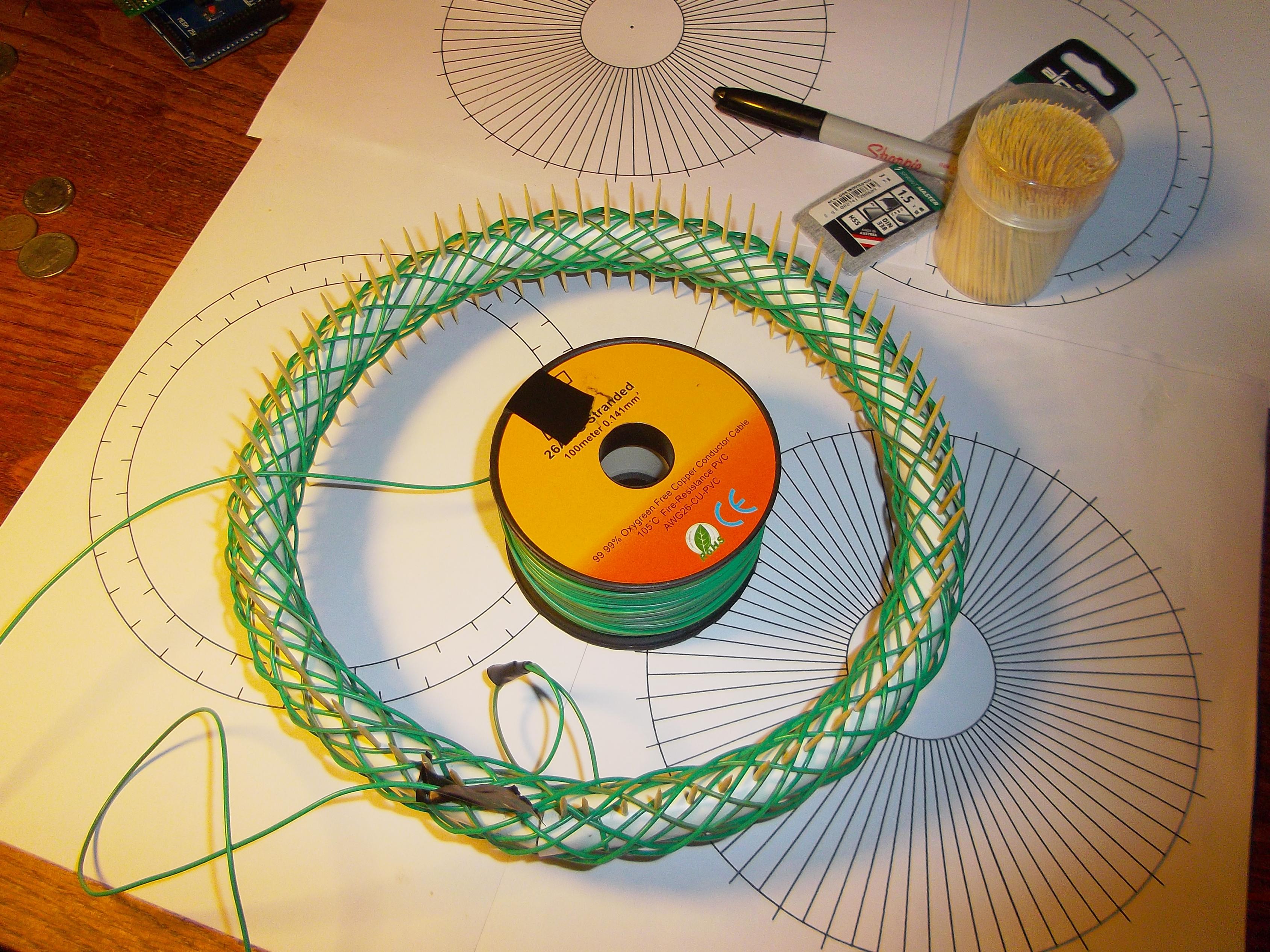

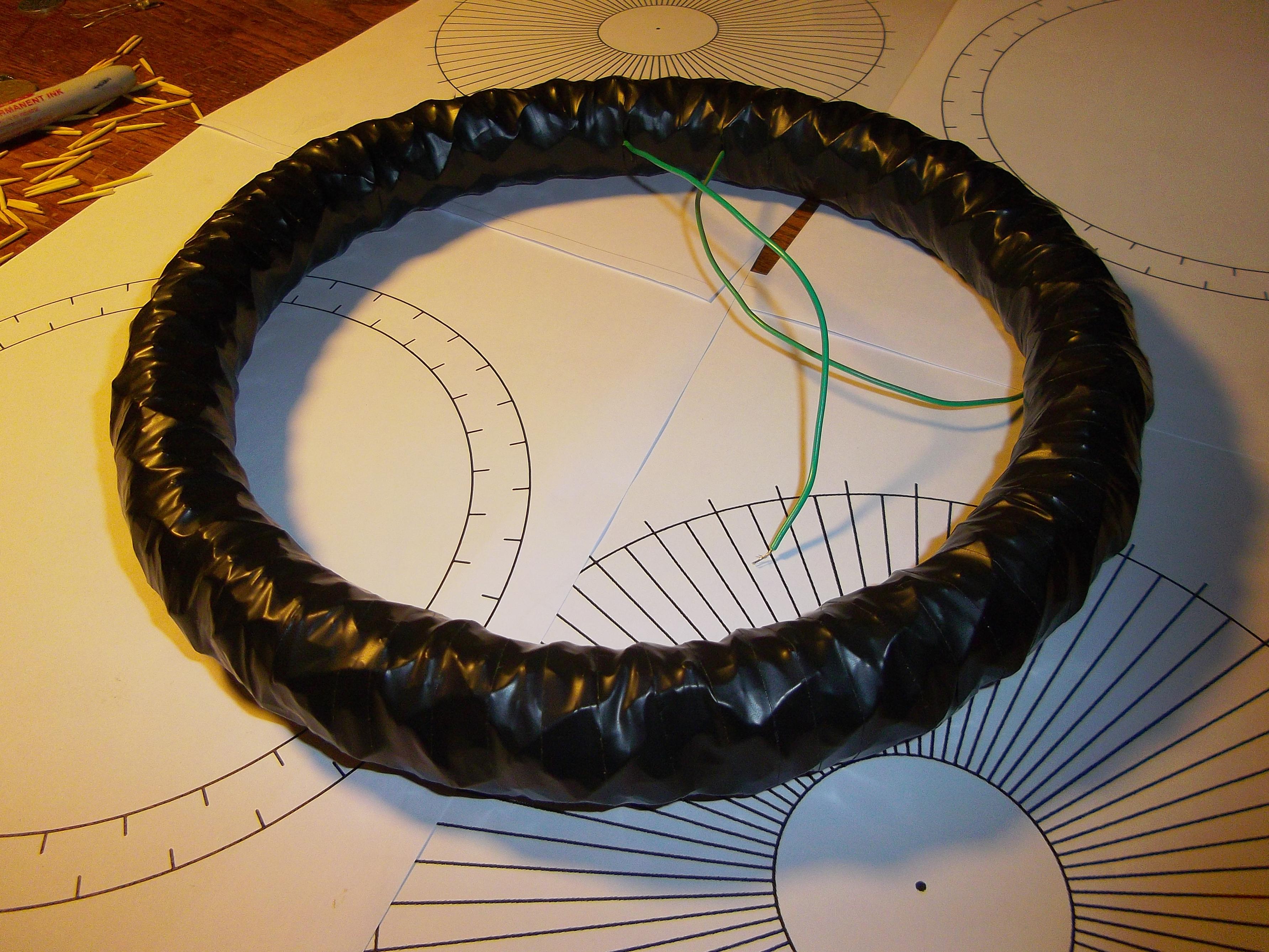

          Yes the parallelism I referred to is in the first photo. Is the pattern in the third photo showing all of the windings in the coil? In other words the parallelism noted in photo 2 is not underlying the cross hatch 3DSS visible outer windings? If so, I’d continue with your testing.
          By the way, the 3DSS RACE TRACK coil I posted some years ago was used yesterday to quickly find a piece of jewelry I made for my grand daughter in 6” tall grass in the back yard. It allowed rapid search of a wide area using my CHANCE PI DETECTOR. The race track coil used is actually faster than my 8” round coil of original design. The bunching in the corners of the racetrack coil was solved with slightly deeper slots and tying in the windings with floss.
          Dan

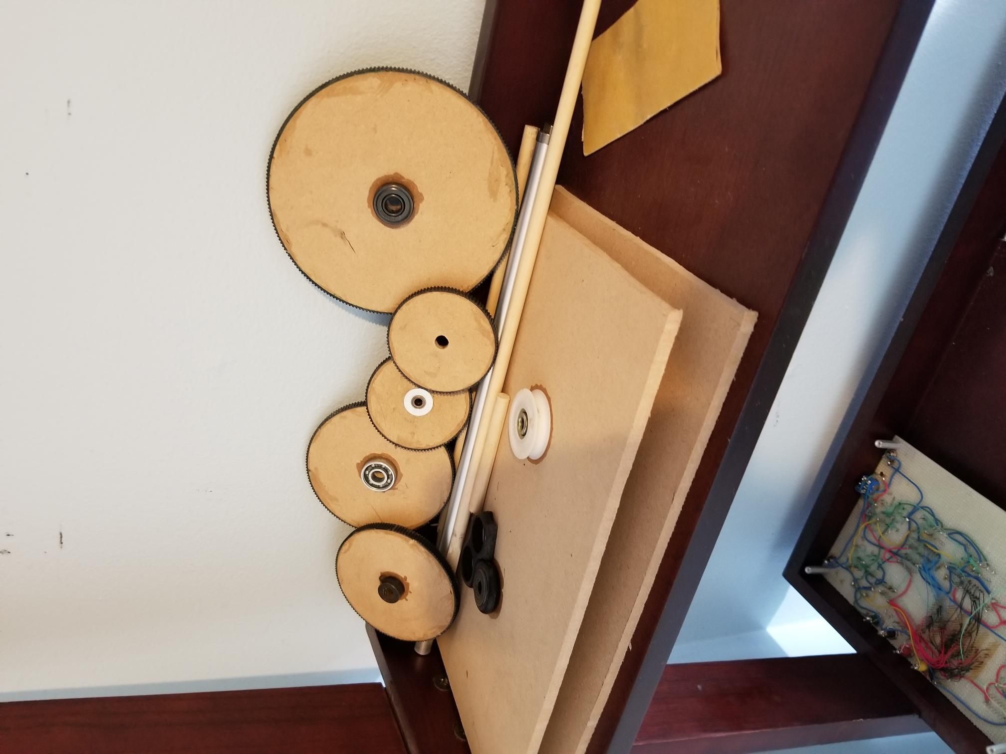

            I didnt really want to elicit a friend into my madness to help with the wire so I started a twisting machine, it will also wind flat coils when I am done DD flats is next on the experiment list.
            Here are the gears for the forward and reverse gear box. Click image for larger version
            Thanks again.

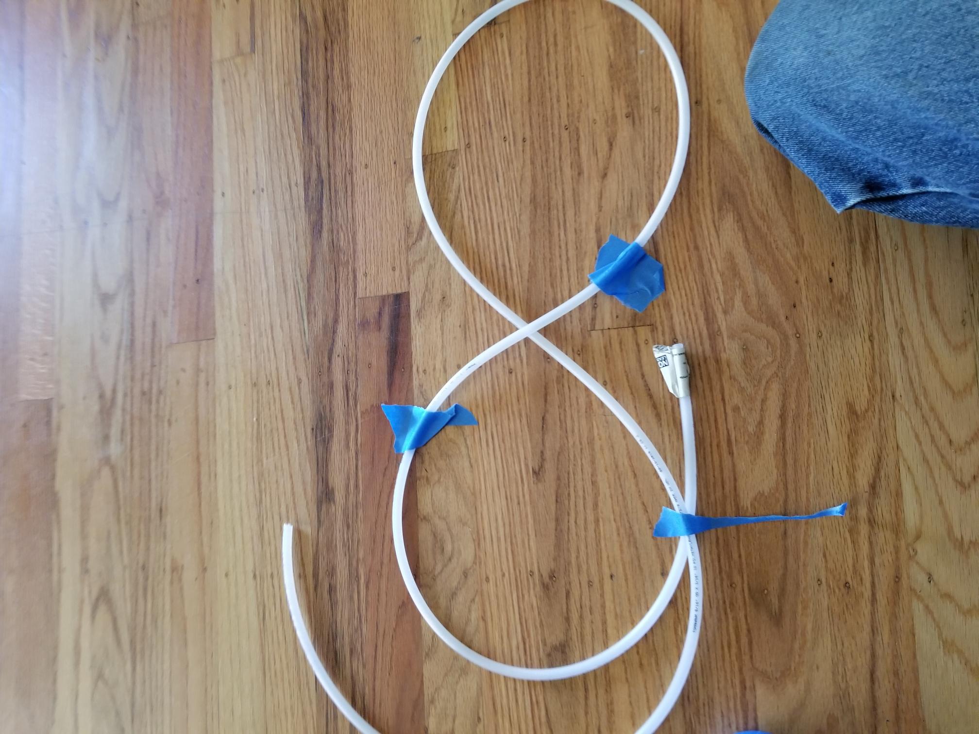

                              Your coil in the first post looked very nice and inspired me to have a go at it.
                              While making this I learned a lesson of my own - don't trust cable rolls to be one continuous piece. The 100 m 0.141 mm2 PVC roll I bought was in fact made of multiple segments like 30 m. Luckily that was just barely enough for my coil.
                              Anyways I filled a 16 mm plastic electrical conduit with sand, taped off the ends with aluminium tape, heated it to 85 C with a heat gun and bent it into a round shape around 8-9" in diameter. Then drilled 74 holes through the form, put a toothpick through each and started wrapping the wire similarly to the original post (I believe).
                              Here's the coil with 15 turns wrapped:
                              And with all 35 turns:
                              After wrapping with tape and cutting the sticks:
                              Now for the results, not as great as I expected really. Mega328 component tester measures inductance at 360 uH. Multimeter gives resistance 3.6 ohms. With my analog scope and x10 probe I measure SRF to be around 820 kHz without coax, which indicates a capacitance about 105 pF. The self-shielding properties of this design are evident though - on 10 mV / div the noise difference is noticeable on the scope when switching the leads. I have yet to finish the mechanical construction of a detector to test this coil in action. And the construction of the coil too of course - especially the mounting and a protective layer.
                                Won't the Aluminium tape that you taped the pipe ends with act as a target? Regards, Marty
