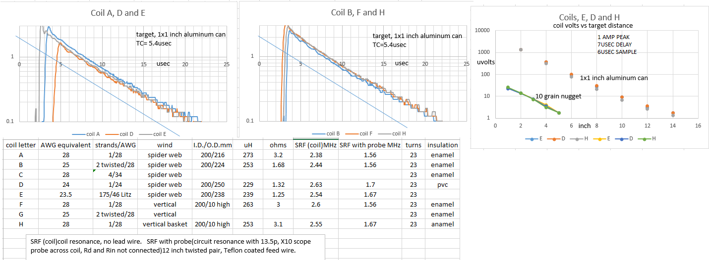

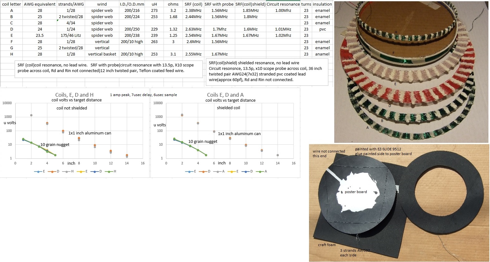

              Test I did awhile back that included a litz coil. Litz coil allows shortest sample delay. Other than delay time they were similar.

                Did you have the capacitance of each of these coils Curious as to the differance betweend B,D,And E?
                      Not shielded capacitance calculates, A=12pf, B= 17pf, C=16f and D=16pf. Might be less, think the method I used for measuring SRF measures lower than the method I use now. C=1/(4*pi squared*L*SRF squared)
                        E not C
                          Hi Green
                          Thanks,
                          Interesting, If im looking at things right the litz coil is at 16pf It apears to be slightly faster than the coil a at 12 pf and response to the nugget is slightly better at distance for coil E.
                          Its hard for me to see the colors they are so close.
                          I know you were evaluating the coils at the same # of turns. It would be interesting to see performance at the same inductance for these coil types.
