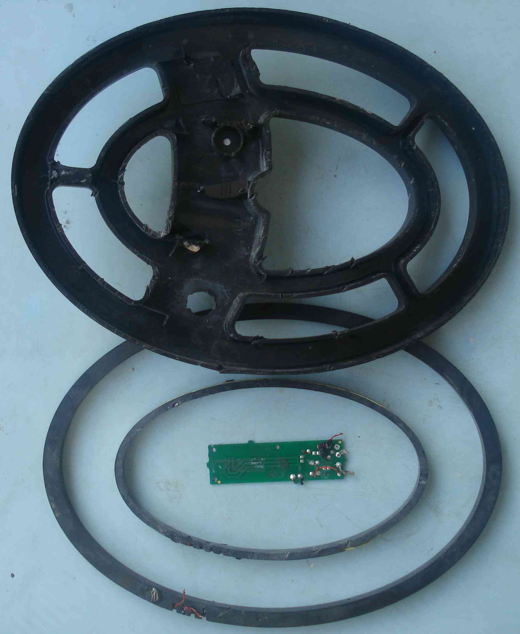

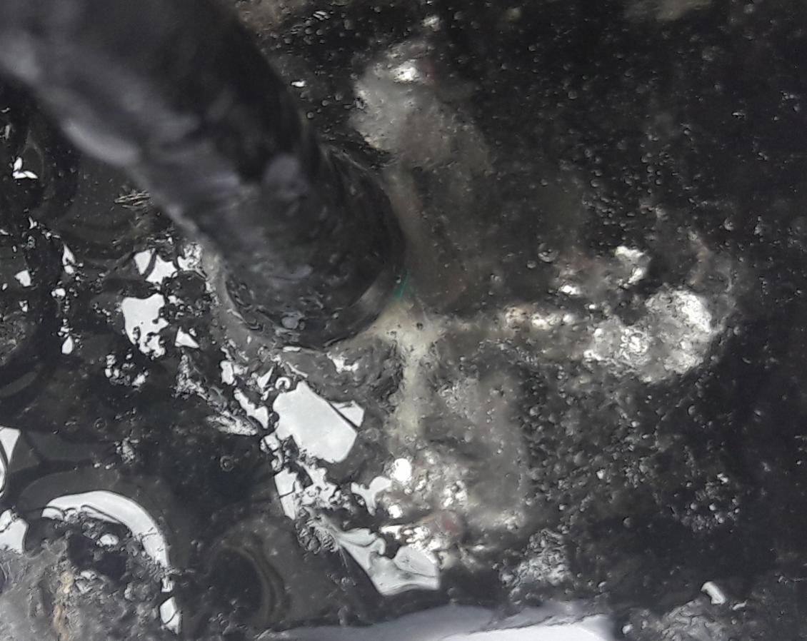

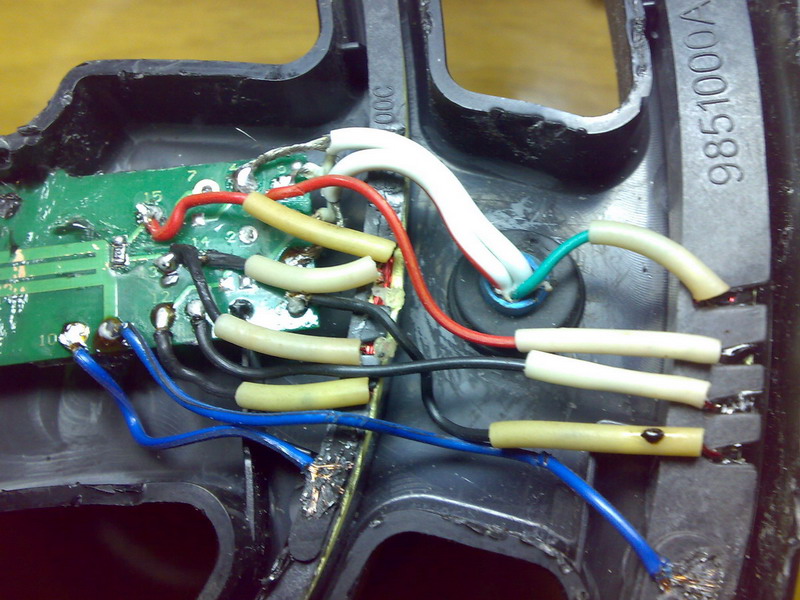

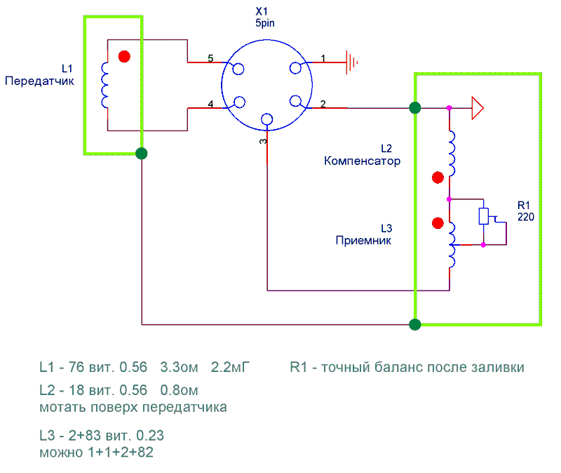

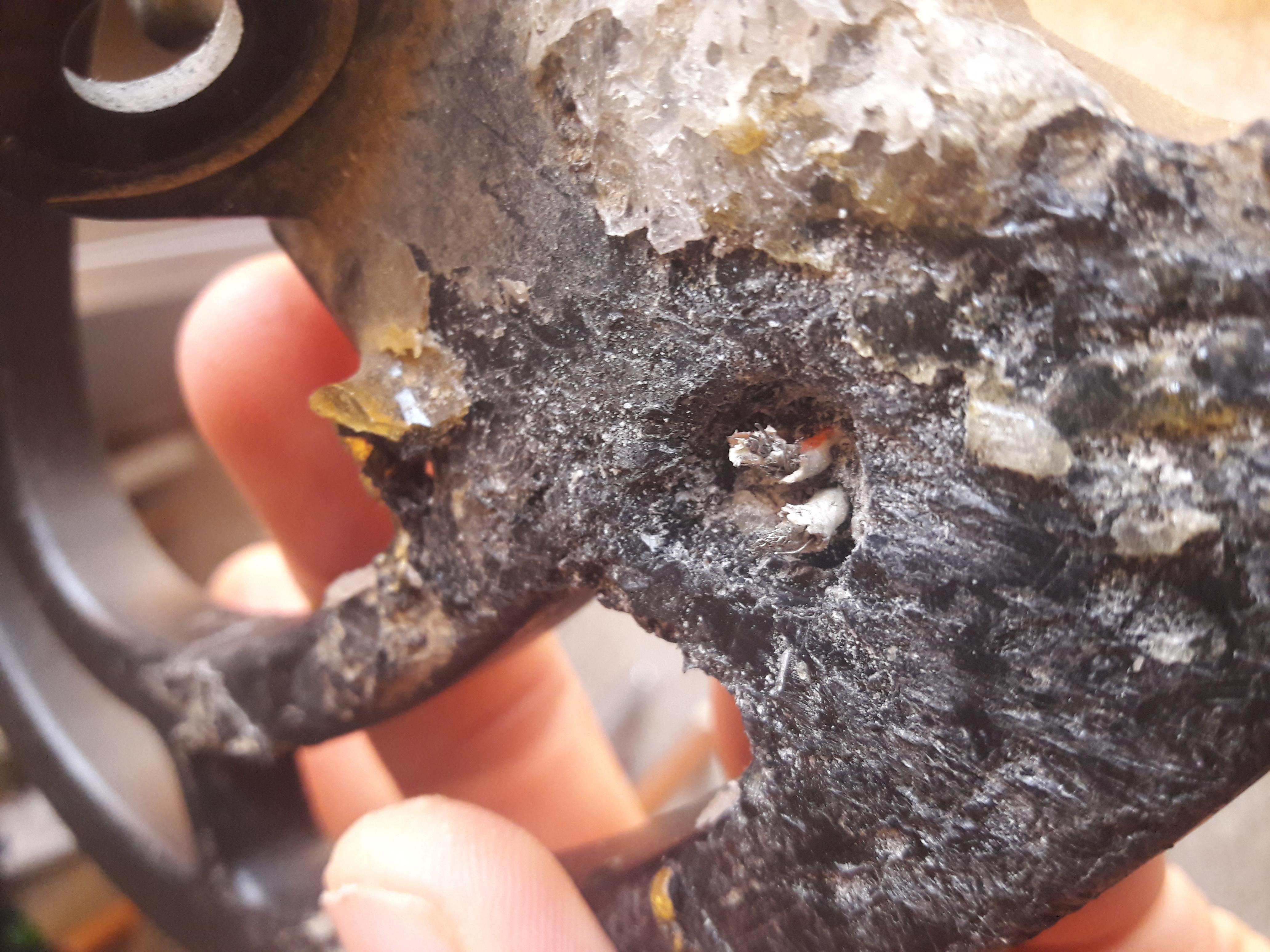

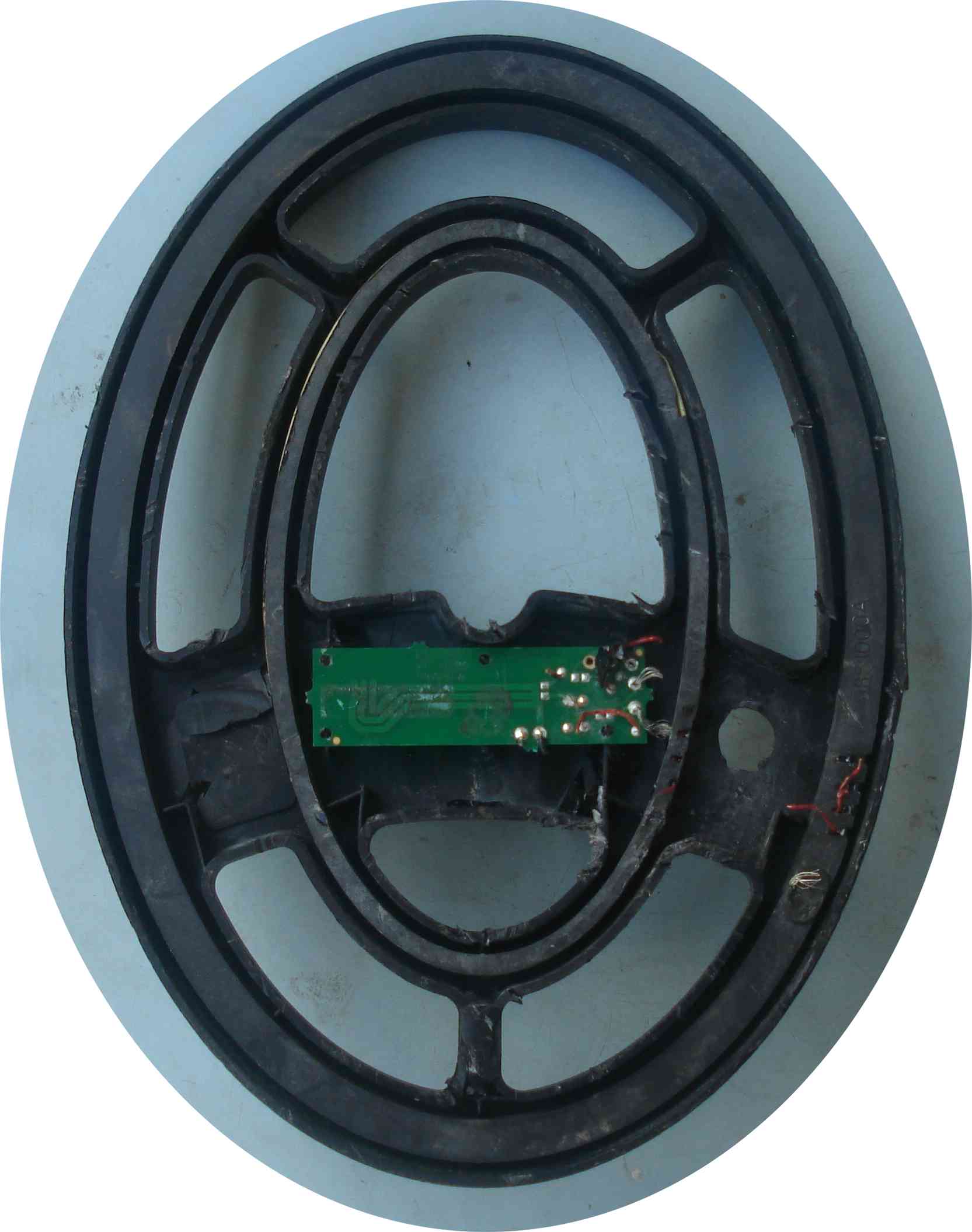

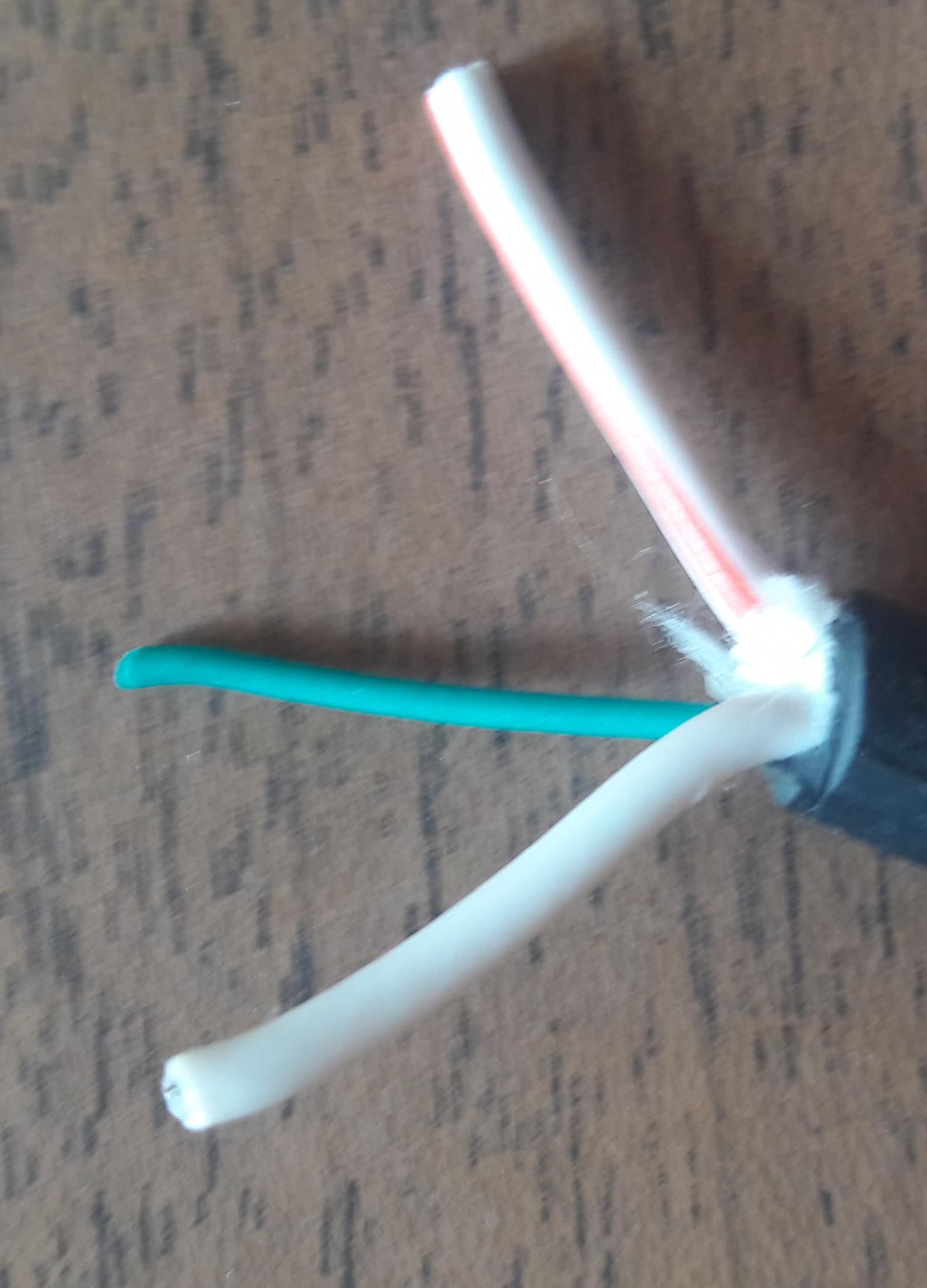

    Hello i broke the cable of my ace 250 coil can someone tell me if the green cable is connected? i only see two wire. Look for a photo of the coil before being filled with epoxy
    hello

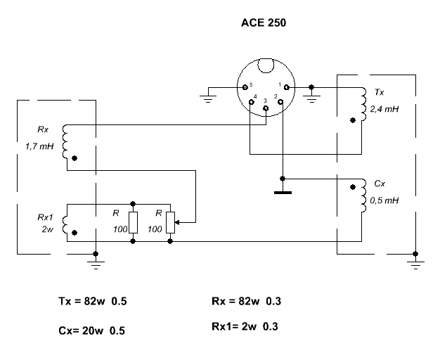

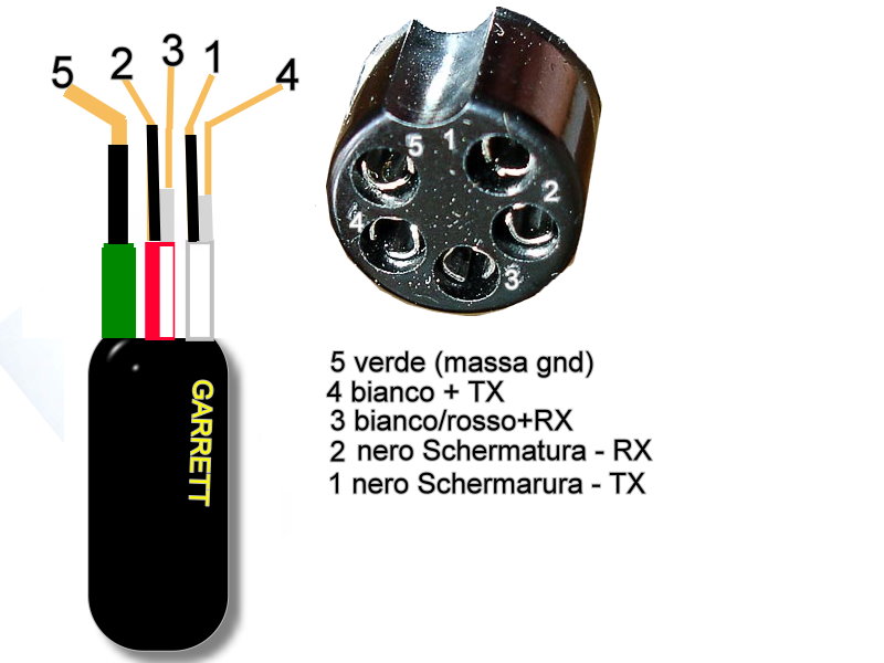

    do not have wires' colorification for the coil, just schematics.

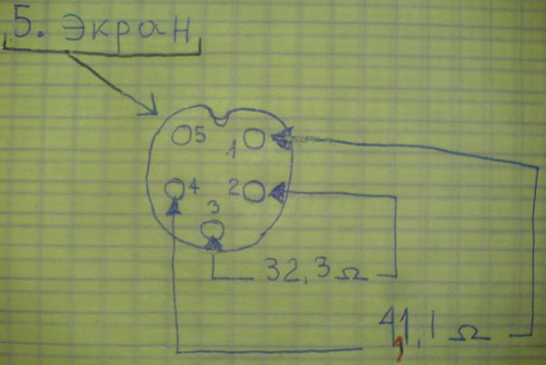

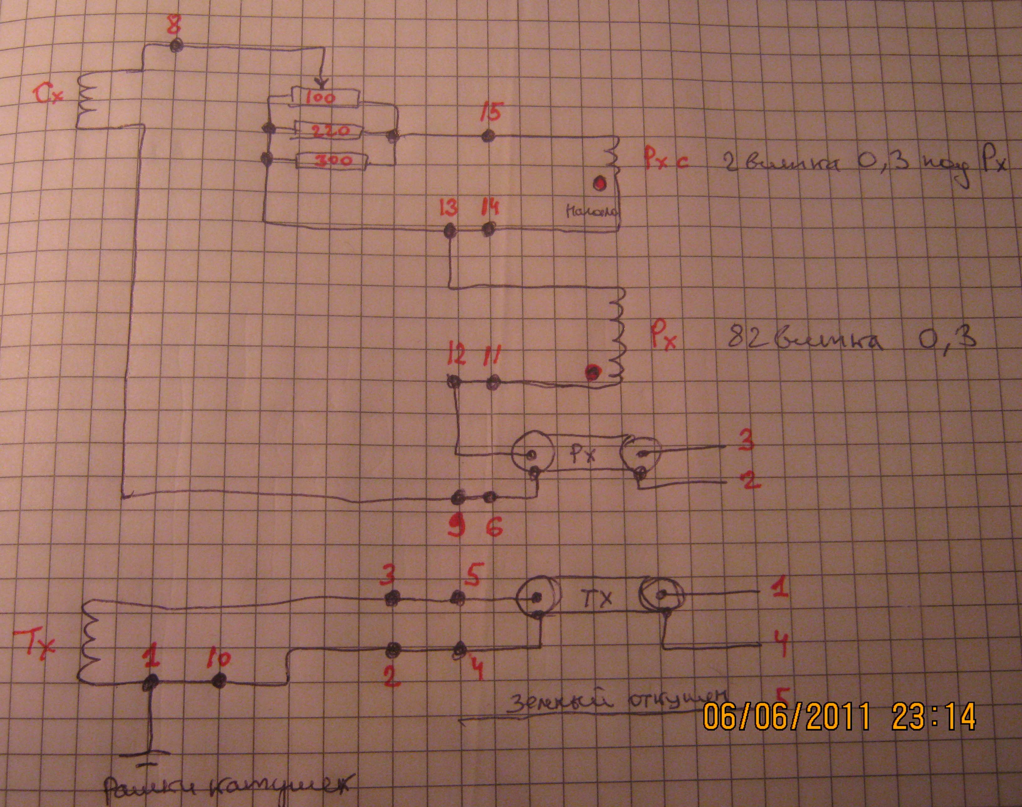

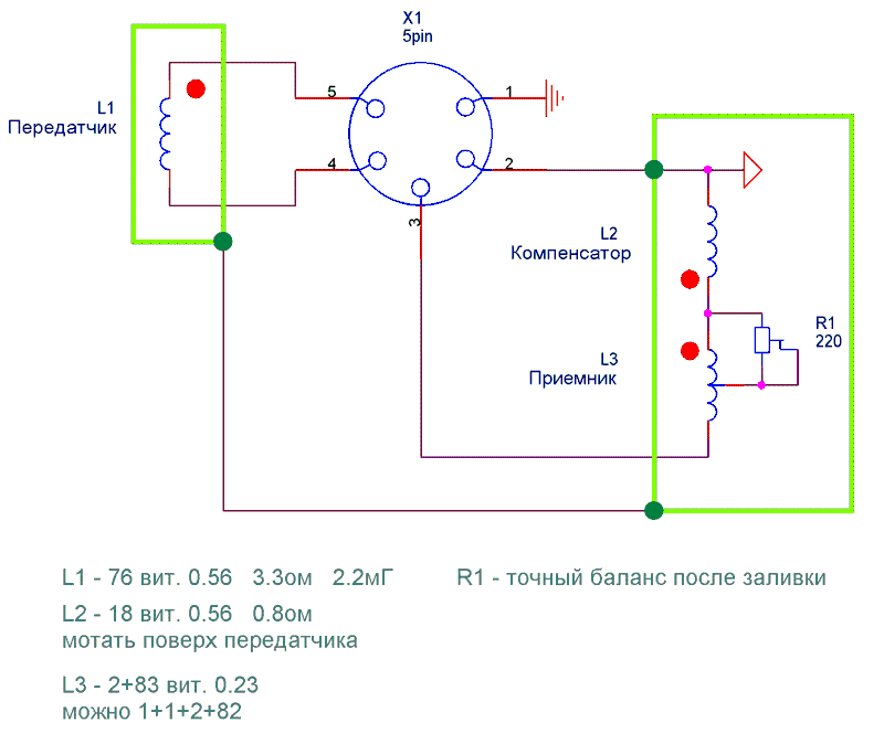

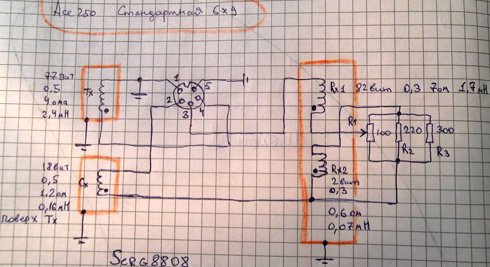

      Nice photo thank you very much kt how do you advise me to fix it I can't read the diagrams, I thought to try to reach the green cable with a hot knife but I'm afraid to cut them or connect the green cable to pin 1?or another pin?
          The green wire is not connected to the coil in the video or i'm wrong?
            open a socket and give pics.
            - unscrew off a small screw on its housing
            - unscrew off two screws on cabel yoke
            - turn over the housing on some angle
            - you must free connector part from housing part now
              I repaired the coil now it works fine could you tell me how to connect a potentiometer to the headphone output to adjust the volume? ,I saw some videos on the internet but they work for the speaker volume

                      for DIY lovers here are the photos
