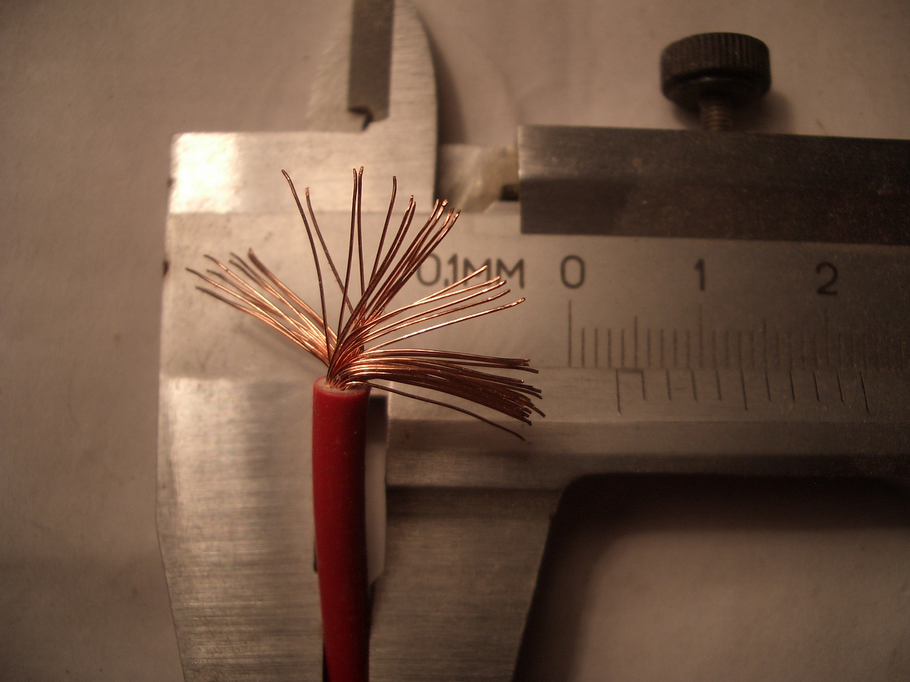

          silicone is heavy and no sence use such wire. you can use it just for deeper coil, not so fast needed, for DELTA PULSE.
          i used a wire in fat isolation. 1.5mm is small, i used 3.5mm diameter.
          notice - i bough it in ordinary shop, without those amazon bla bla bla High Quality Ultra Flexible Soft Highly Efficient.
          capitalistic world again with its all hyperbalization words. if you buy thing you see just giglet in your hands and nothing more.

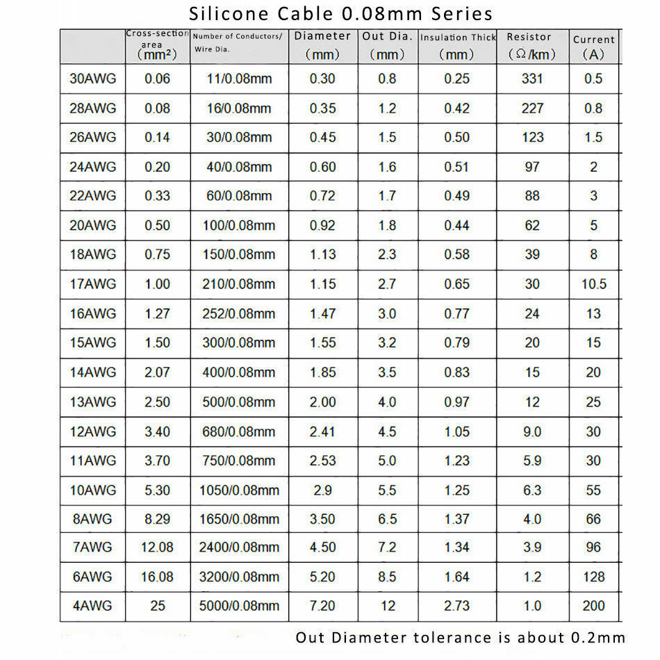

                  I had seen this silicone wire a year or 2 ago myself. It is available from several Ebay sellers in different AWG sizes and shorter lengths (...30, 40, 50, and 100M) if anyone wants to TRY it at a lower price. I've been thinking about trying it myself.
                  Here is an example seller (I have no affilliation - btw): https://www.ebay.com/itm/8-30AWG-Silicone-Cable-Flexible-Wire-UL-US-0-08mm-Series-RC-Cable-Lead-White/153436660832
                  Also, a chart I found for the wire: Click image for larger version
                  Obviously, the key points for our use are the tinning, and increased strand count properties that deviate from the AWG standard in composition (but not size).
