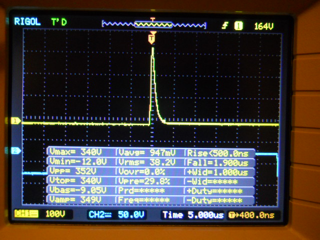

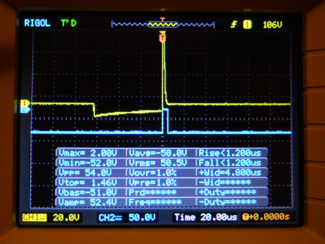

                    Its been a while since I had it on the scope but its fairly fast.
                    Old picture dual field on a stock MPP
