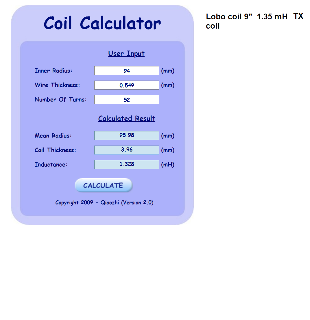

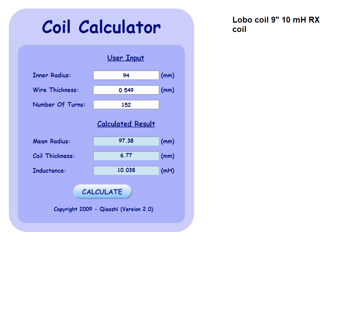

    i have Remington Industries PN155 24 AWG Magnet Enameled Copper Wire
    and if i remember correct it have the thickness of 0.549mm
    now i'm ready to use the coil calculator on this page.
    To figure out how many numbers of turns i nede for the TX and RX Coil
    Lobo wants :
    Lobo coil 9" 1.35 mH TX coil
    Lobo coil 9" 10 mH RX coil
    i upload 2 pictures of my coil calculations

    if you pros see that im not thinking right pleas let me now so i can correct it

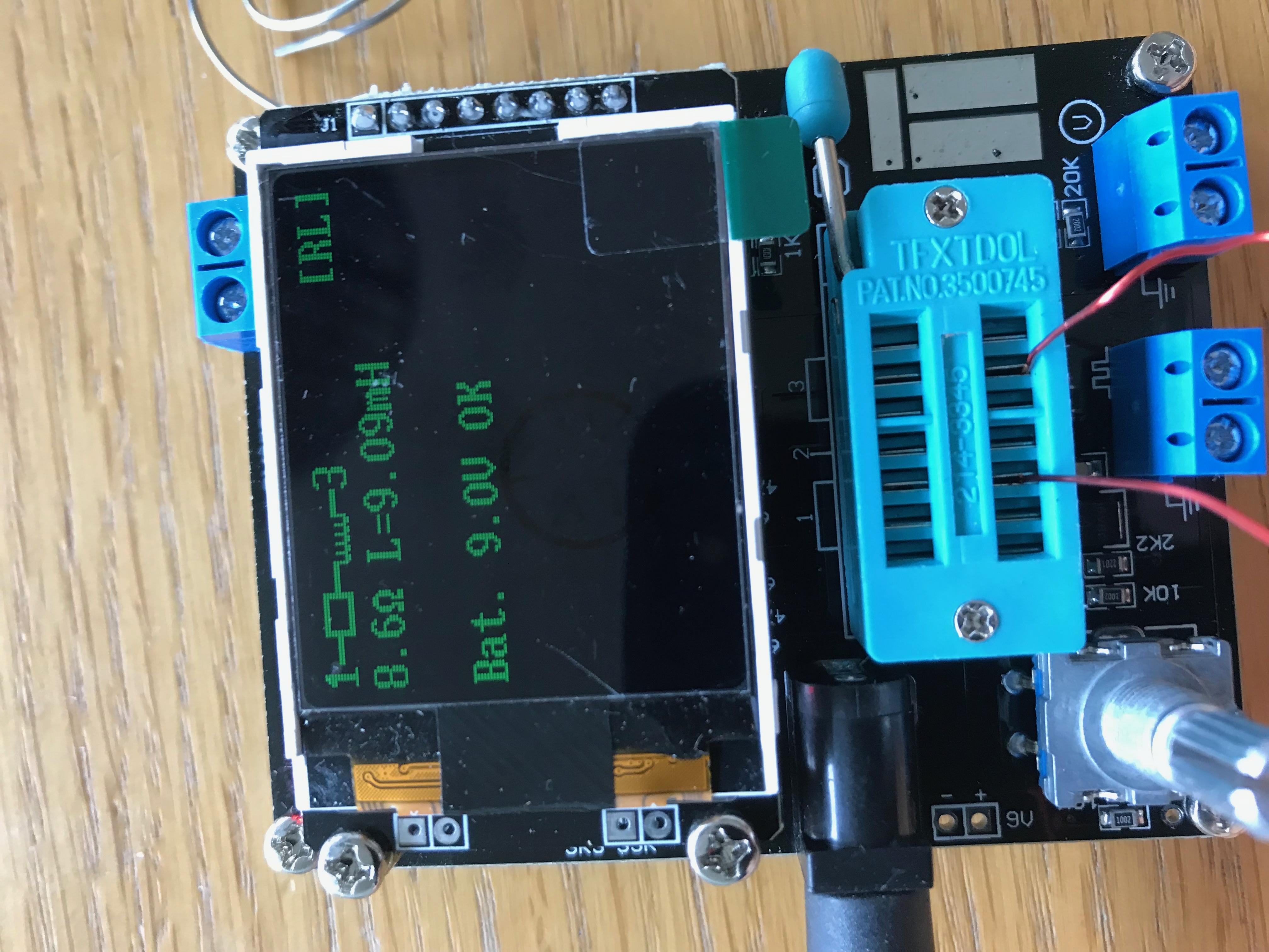

    i have 155 turns , and im measuring it and get 8.6 ohm and 9.09mH
Name:	Bilde_1 2019-08-12_15-23-10.jpg
    Im getting close to the mH but Ohm is way off , whats wrong is it the AWG ????

        you are right , thats what i tough to , but since i started this way i have to make EPOXY coil and make the shape my self .
        But what about the resistance ?? is it important to hit both the induction and resistance ??
        or is it ok whit just hitting the correct induction
