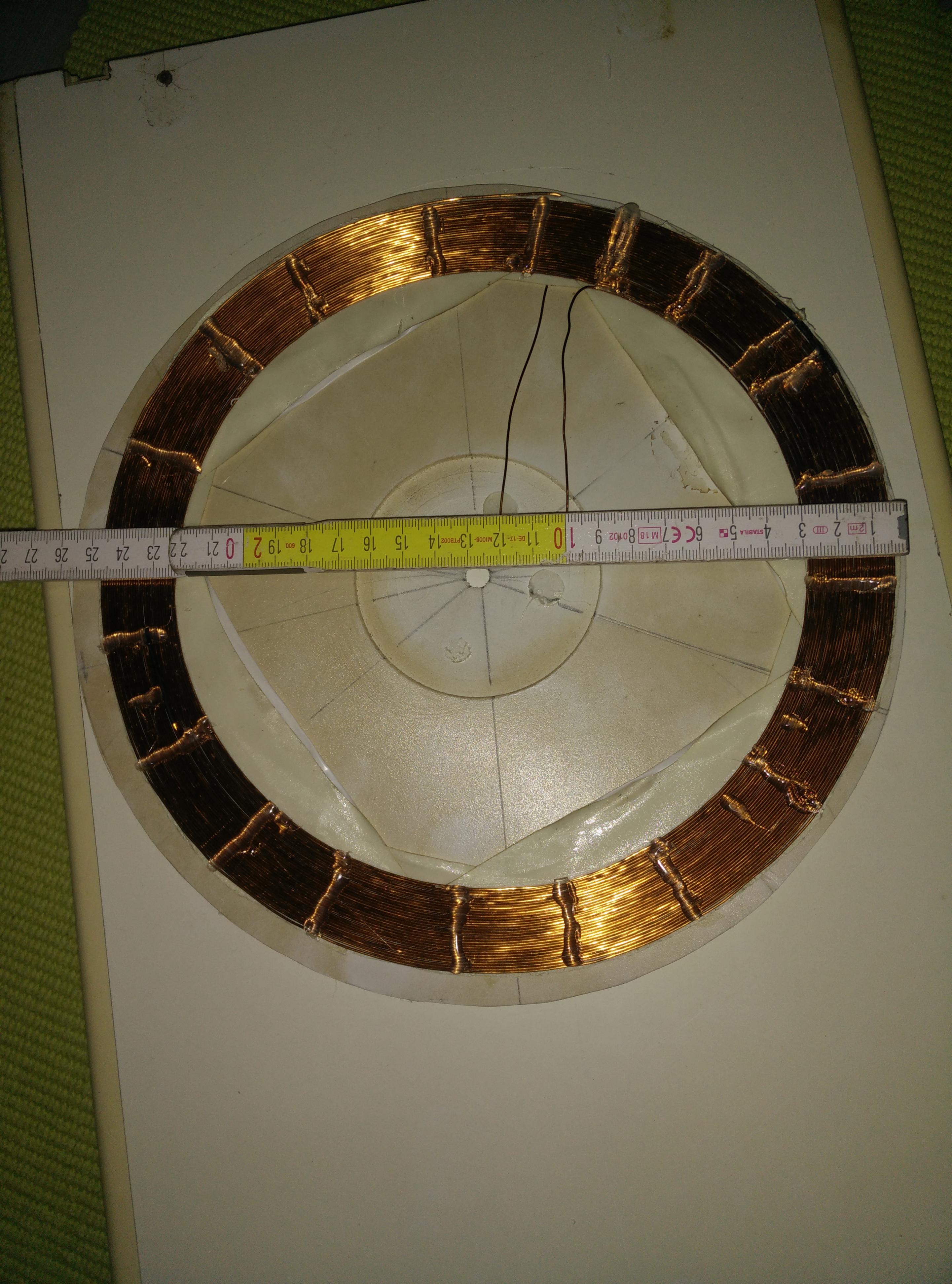

    As an alternative to the epoxy resin to fill the plate, is it possible to use the bostik liquid rubber?
    Pi coil.

            where i recomended fillind a coil by epoxy or by a material? where in which post?
              I don't know where you recommended it, I'm interested in knowing if I can fill it with liquid rubber instead of epoxy
                you have leave a gap. AIR GAP. between the wire and enclosure. thickness of it 3-4 mm.
                wind your coil by paper rope. after it cover by scotch tape in N layers, for sealing,
                epoxy must not fall on wire.
                then cover by what you want.
                also, you must wind new coil, on fiberboard. you do not have a plastic, plexiglass
                or another material for the base.
                  the base is in polystyrene is not the one you see in the picture, anyway thanks for the indications
                    any material have dielectric constanta and if you use it you get a capacitor. just vacuum has 1.0 and then the air.
                    thats why you must think how to do a coil right. PHYSICS OF 8TH CLASS OF A SCHOOL.
                      Pi coil.
                      The only way to know is to try it. Besides electrical effects (dielectric issues) there is also expansion/contraction. Might also be heavy.
