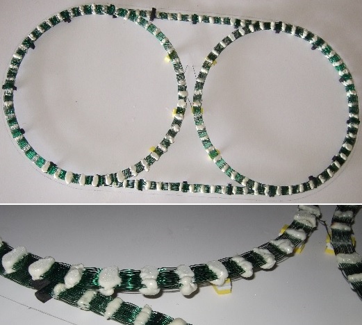

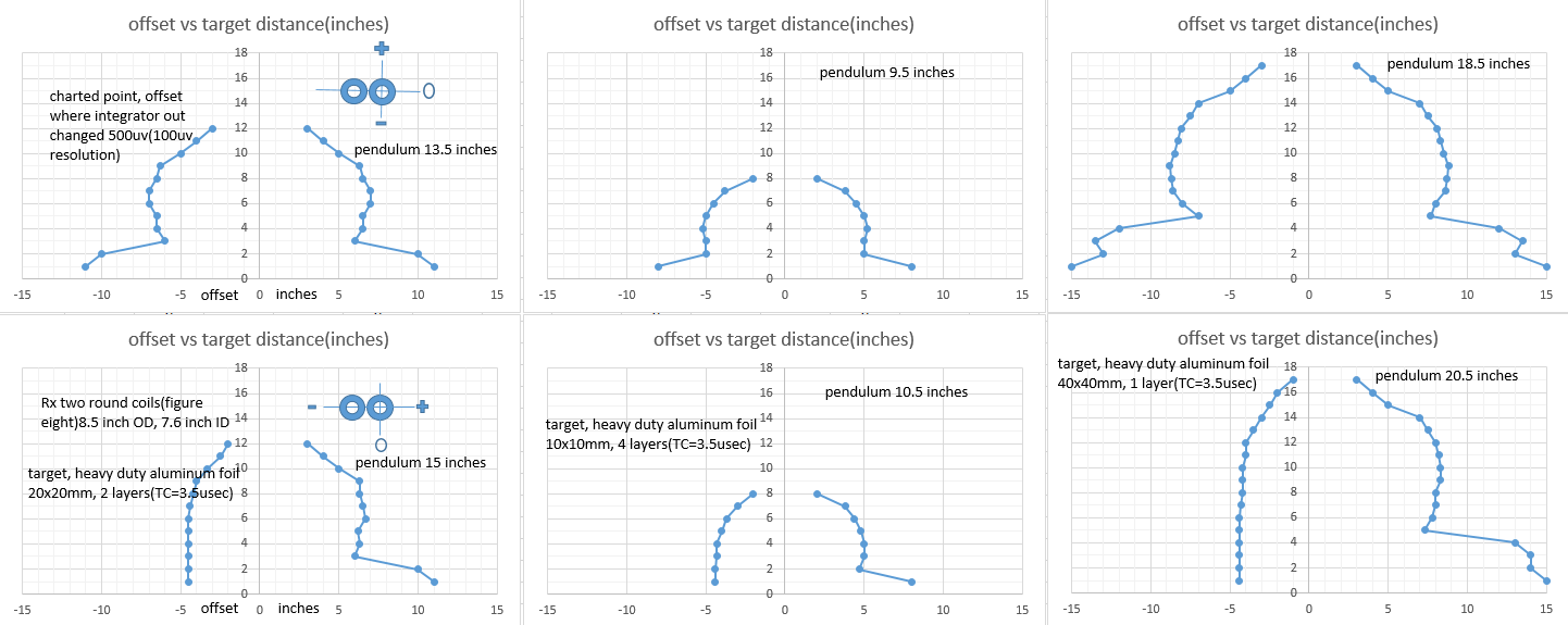

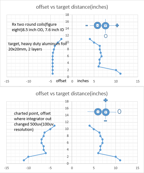

        Some tests I did awhile back. Target was positioned 1 inch above and outside the coil where moving it inwards made no change. Target was moved inward until a 500uv change in integrator out was seen. Recorded distance offset. Repeated for other distances above coil. (coil test, figure eight_2)pendulum number is the distance the target was detected swinging from a pendulum. Detected outside the coil, a lot outside when target was 1 or 2 inches above coil. Rx coils are opposite so a absolute value circuit is needed to detect both Rx coils. Rx opposite so there is a null in the center. Picture of coil before foaming and shielding.

          The coaxial and figure-8 styles are IB and can be used with either VLF or PI. On the SMPI, you would continue driving the TX coil and then add an RX+/RX- coil pair driving the preamp. To do this, you will need to remove the TX coil drive to the preamp. The RX coils will need to be individually damped. It's all conceptually simple but tricky.

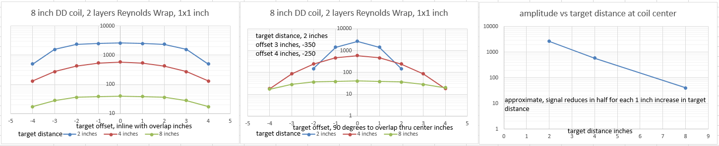

                              Anyone test a DD coil for side detection? Some test data I did awhile back. Didn't test for side detection, would except zapped my test circuit.
