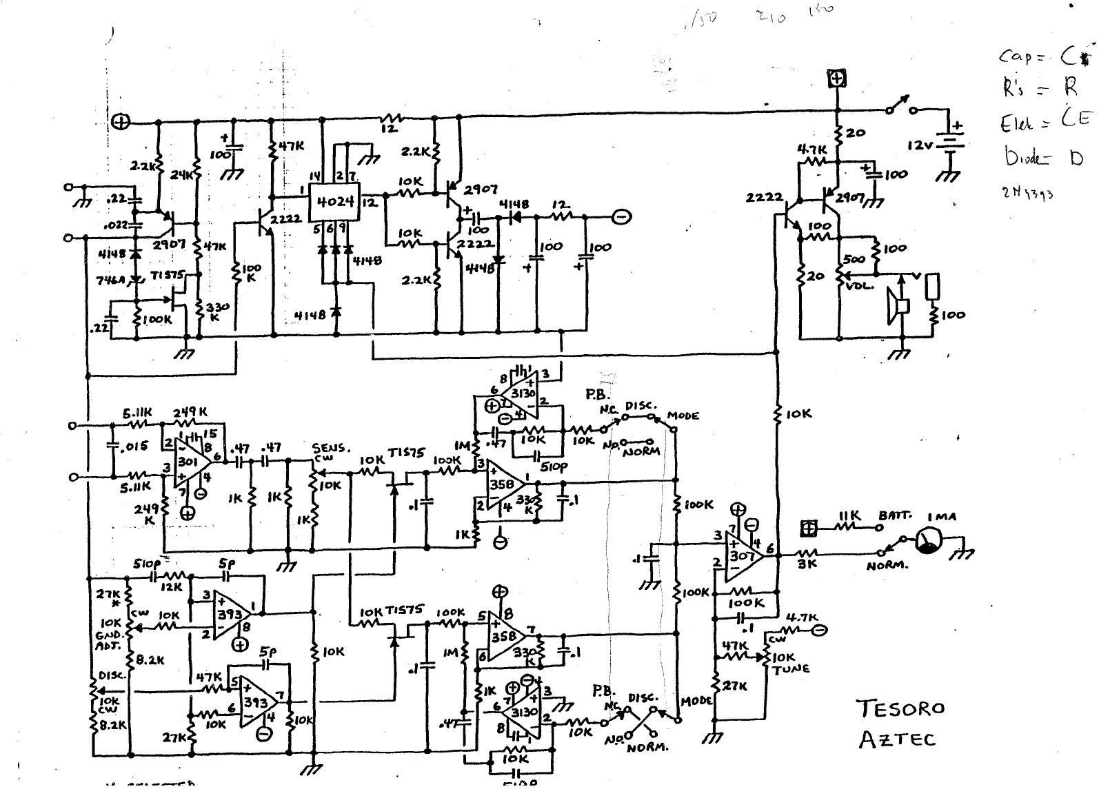

        There is one strange issue that you are sure to encounter when you are dealing with tesoro circuit like TGS and the likewise TGSL.
        That has to do with grounding the Rx coil or not. I recall Dbowers and others having a lot to say on this issue. In the stock factory coil, the Rx coil is grounded.
          However, in the Tesoro Aztec circuit, the Rx coil is left floating. The issue is discussed at length here:https://www.geotech1.com/forums/show...ght=ungrounded
            this is just not showing the ground, not an example. William Lahr's every schematic has 1...2...3 mistakes as rule.

              I agree, it could be an omission on Lahr's part BUT:
              If you are familiar with the thread "grounded or ungrounded Rx coil" , then you will know Dbowers had best success with UNGROUNDED Rx coil on WET GRASS.
              Same for me as well.

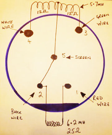

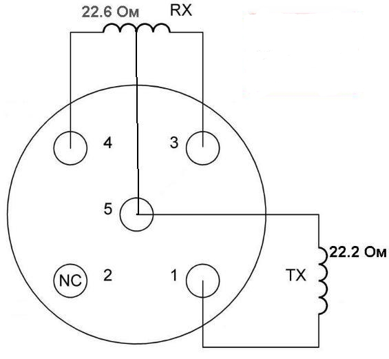

                    on pics right ground connection of TESORO RX coil you do not want to notice.

                      It seems that all concentric designs which use the buck coil feedback method, the Rx coils are ALWAYS grounded at one end, within the coil housing.

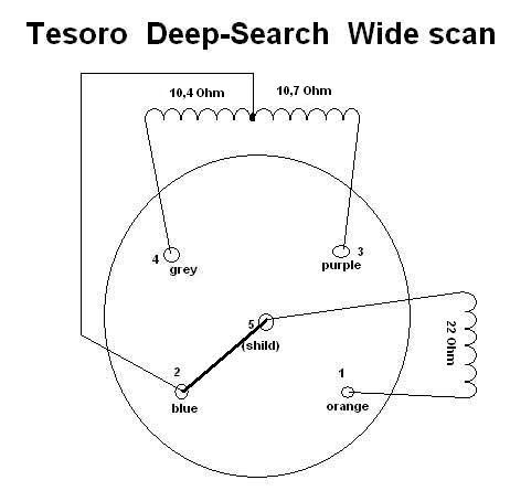

                      A Widescan coil on a tesoro with its front end preamp topology might be another issue. THAT IS WHY TESORO WIDESCAN COILS ARE CENTRE-TAPPED RX COILS, WITH CENTRE TAP TO GROUND!!!!
                      If you make ordinary DD coil for tgsl (non centre-tap), and you connect one end of Rx to ground(the end that connects to the non inverting input, as shown in the schematic), you will get terrible falsing on wet grass, as others have noted. I don't know why, but the concentric tesoro coils have no such problem. Maybe it is the shield or the cable???
                        oru bl ))) and where your theory 'floating RX coil' is here if you SEE YOURSELF THE CENTRE TAP GROUNDED???

                            First, I am saying that a NON-CENTRE TAPPED RX coil in the DD style, does not work well if grounded according to the scheme. It falses on wet grass, Why, I don't know.
                            Second, ALL TESORO DD COILS, aka WIDESCAN, are having a CENTRE-TAPPED RX COIL which is grounded by the centre tap connected to the shield.
                            DO YOU THINK THIS IS JUST A BIG COINCIDENCE???
                            I DO NOT.
                            ALL TESORO WIDESCAN COILS MADE TO BE USED WITH THE TGS/ROYAL SABRE/SILVER SABRE and such models ARE HAVING A GROUNDED CENTRE TAPPED RX COIL.
                            Conclusion: if making a DD coil for your TGSL, make a RX with a centre tap!!!!
