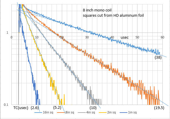

    Haven't seem much if any with the comparisons I've done. Would a 1, 2, 4, 8 and 16 inch square piece of aluminum foil chart the same decay slopes with a 1.6 inch and a 8 inch diameter coil? Would a piece of aluminum foil 1 inch wide by 1, 2, 4, 8, and 16 inches long chart the same decay slopes with the two coils? Would expect each larger size to chart a TC twice the lower with the square target with the 8 inch coil. Wondering if the target being 10 times larger than the coil would have an effect.
    Yes, though I haven't figured out the math. Ideally, target tau depends on skin depth and the thickness of the target and not the physical size. But obviously, if you test 1, 2, 4, 8, and 16 inch squares of foil they will have different taus. This suggests there is an edge effect. You could test this by taking a 1.6" coil and measuring the tau of a 4x4 and 8x8 foil square. They should exhibit the same tau. But not so with the 8" coil.

        8 inch coil

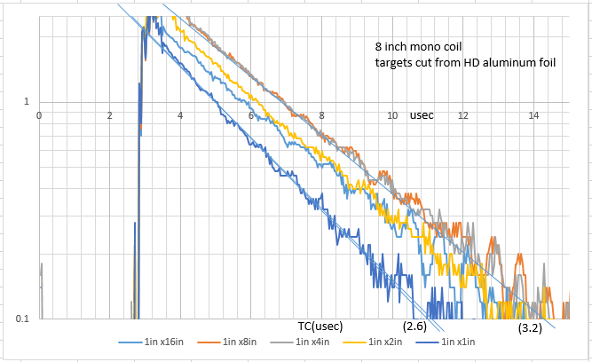

          8 inch coil with 1inch wide targets. More noise than I would like. Not much change in TC between the targets.
          Will do the 1.6 inch coil tomorrow.
            Nice charts, Mr.Green. And exactly as I was expecting. The squares having a TC proportional to the edge length, as we've determined in the other previous modelling/testing threads . And the 1 inch strip having a TC dominated by the narrow width, as the eddy currents don't flow up and down the length of the strip well, mainly circles / squashed circles, with length similar to width.

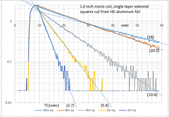

                Test, 1.6 inch coil with squares. I'll do the 8 and 16 inch squares again to see if they repeat when I do the 1 inch wide strips. Looks like TC doubles when width doubles at least to target 5x coil diameter. Does show target doesn't go to infinity at least for this example.

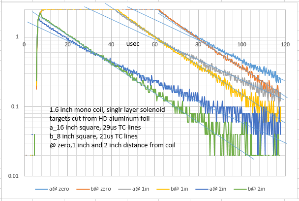

                  I'm expecting that you will have the test targets closer to the small coil, to get a more measureable signal ? This may increase the coupling between the coil and the target. The coil is damped, hence it will also damp the target eddy currents, slightly. So perhaps the measured TC values will be a little bit shorter?
                  Pure speculation, of course.

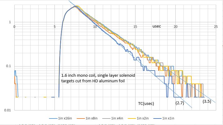

                    Test with 1 inch wide strips. Still need to check repeatability of the 8 and 16inch squares.
                      That's about what I expected, although the target has to be bigger than I thought before the edge effect diminishes. The best place to look up the math for this is in eddy-based non-destructive testing.
                        tried the 8 and 16 inch squares at zero, 1inch and 2 inch distance from coil.
                          Aren't the eddy currents supposed to follow the pattern of the excitation field, ie the monoloop.
                          How does a 2x2 show relative to a 1x4, and a 4x4 to a 1x16. It is clear that the more lateral and longitudanal surface area, ie a square, allows greater eddy current flow than a 1x.... merely because of the flux pattern of the monoloop. The mesh of the square being greater than the determinant sum of the meshes in the strip.
