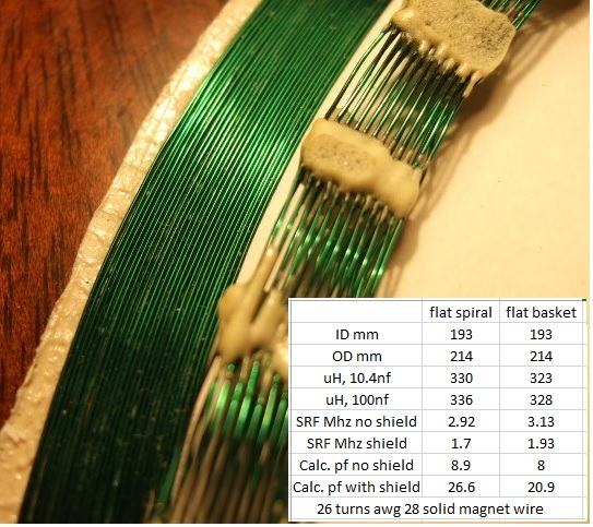

      I measured a 20cm spiral coil. Graphite shielding added less than 20pf

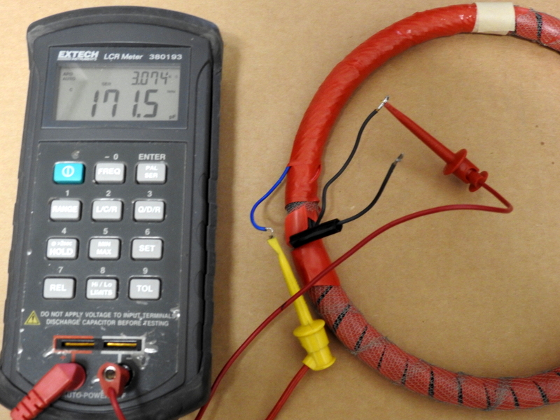

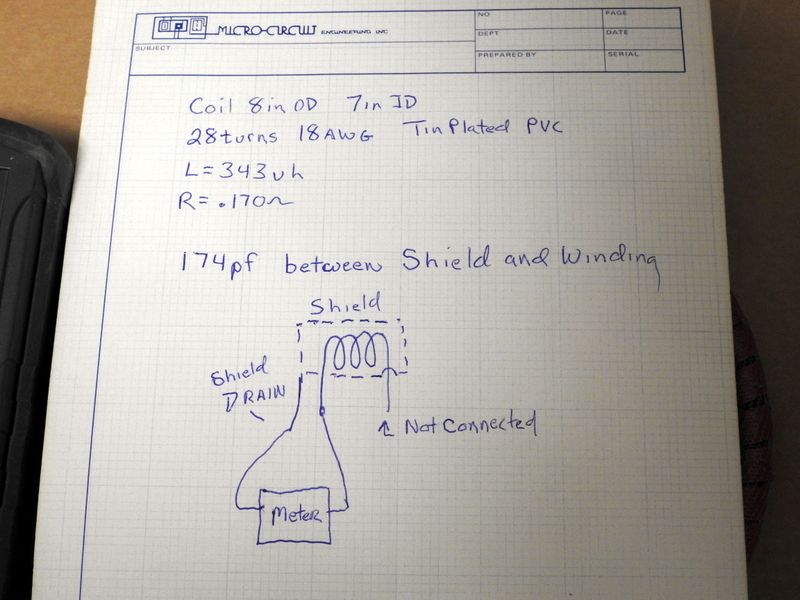

                    The way I do it is disconnect the coil winding from the shield lead. Connect one lead from the capacitor meter to the shield and the other lead to one side of the coil. In the photo the blue lead is the shield drain and black are the coil. Not sure if this is the proper way? Need to verify by doing a self resonance test.

                        how can I measure without a shield?
                        you can show this as a drawing.
                        thanks
                          Thankyou Altra
