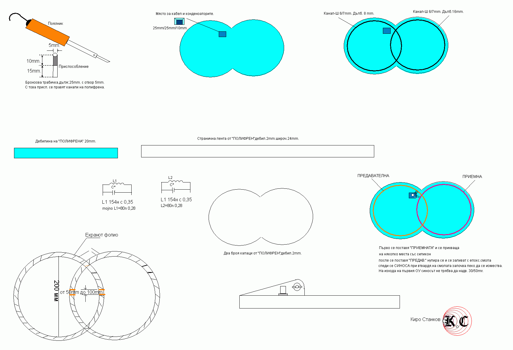

    The OO coils are commonly used in Bulgarian VLFs ("Grozdanka" and "Gadulka", and so on) which were very popular in the 90s. and still are by some older persons.
    There are OO coil shells on ebay, you can get them cheap. Not sure if this will bring any improvement on the PI technology, I mean as far as I know the depth (and instability on the OO Vlfs is
    high voltage TX and fine tuned resonance coil which causes instability with temperature shifts so nothing too much to do with the shape). Also huge drawback is the shape in my opinion. I had Nexus Coronado last year with 2x20 coil and ground coverage vs coil weight is probably the worst in the world, not to mention it was very unstable but that's another story.

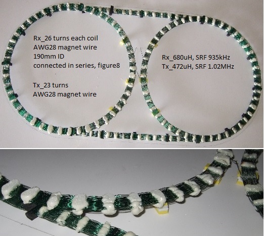

      Not sure what you mean by "OO". Including a picture of one of the coils I use for testing and the PI detector I'm playing with. I get better detection distance with it vs the mono coils I tried. Reduces ground signal and noise pickup vs a mono. Two 30in diameter coils side by side would make a very large coil.

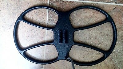

        Picture of an OO coil:
          Thanks, will that coil work with a PI?
            antenna
              This OO looks like an Induction Balanced coil like a DD or Concentric of which do work with PI detectors. Big difference is Inductance of coils and NO resonant Caps. Then simply adjust over-lap to obtain a null during TX ON pulse.See my thread on the HH2 for some details on IB coil for PI.
                Yes, if the PI supports IB coils. The advantage of an OO coil is that it minimizes lift-off effect which is a problem mostly with VLF designs. It may show up in PI if you are trying to aggressively sample right up to the TX edge.
                  Does an OO have an advantage over a DD?
                    Probably not. The sharp corners on a DD create small intense areas in the field that produce lift-off in a VLF as the coil is lowered to highly mineralized soil. The same thing happens with a PI but I doubt you would see it unless the sample delay is down to 1-2us. I could be wrong, I've never tested for this.
