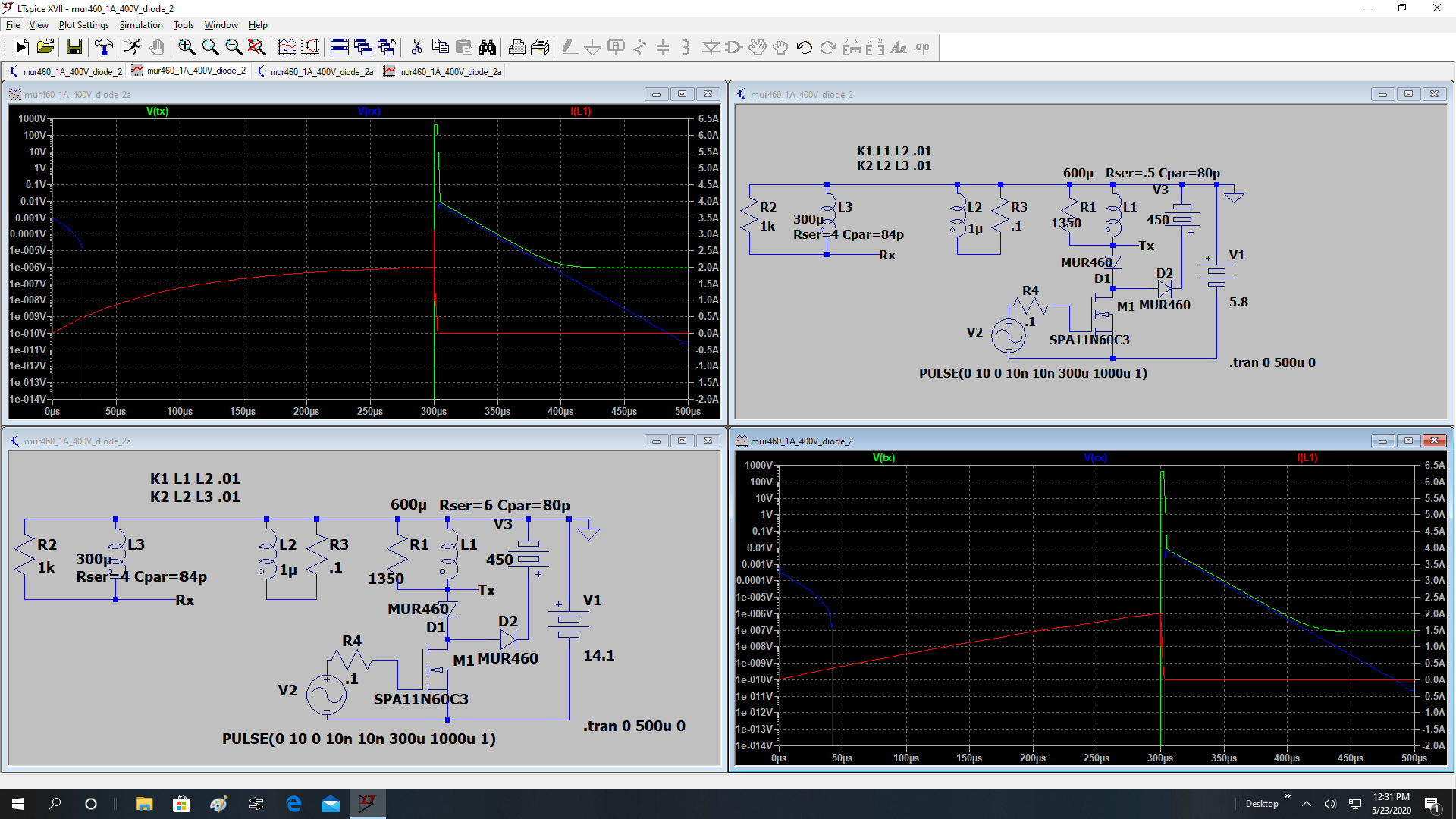

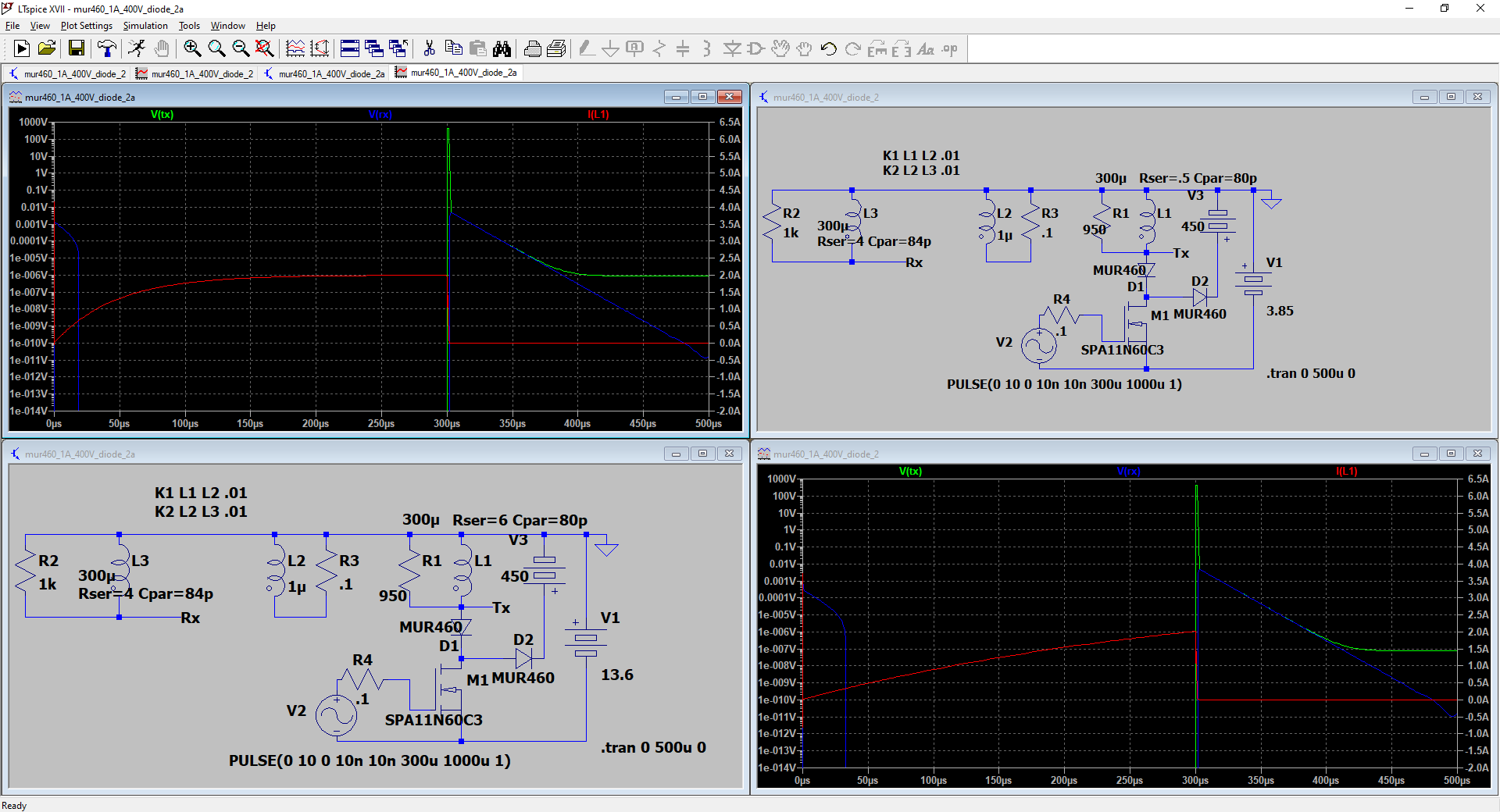

Tried simulation with spice. 0R5 and 6R coil resistance with 300uH and 600uH coils. Adjusted supply volts for 2A peak current. Was surprised at difference in volts for what appears to be same signal strength. Maybe I'm doing something wrong? 600uH coil appears to have twice the signal strength the 300uH coil has.
