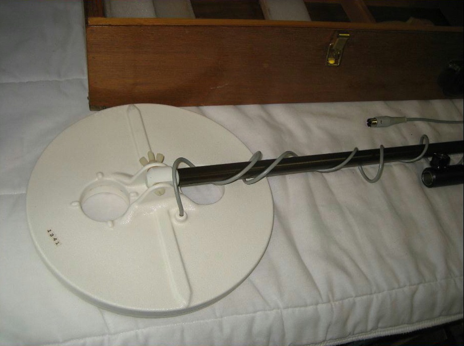

            Okay, got a photo of the Jack Roach Figure 8 coil, which he contracted with Semtech, and it came out as Semtech Metal detector SI model, with two holes. Top hole is Non-Ferrous target, hole nearer the case unit is Ferrous target hole. When George Payne came out with 1975 Whites VLF then Semtech ceased production and sales as the hand writing was on the wall.
            I wanted to post a photo, but I cannot figure out how to add a photo into it and gave up... Something does not appear and let me attach a photo.
            Melbeta
              No idea, don't think I've ever seen one.
              I wanted to post a photo, but I cannot figure out how to add a photo into it and gave up... Something does not appear and let me attach a photo. Not sure what I did, but somehow it attached. How do I clear all of the past photos from uploader???
