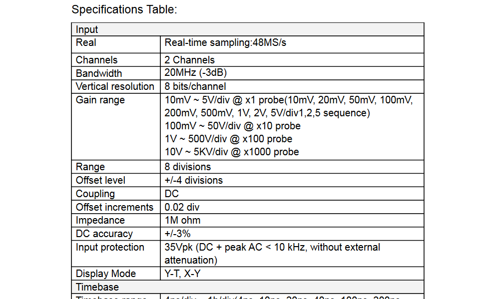

          hi, thanks for all of your replies i have taken the dampening resistor off the pcb and put it in the search head it works fine a pre decimal 2 shilling at 12/13 inches,had another look at the variable resistor ,duff preset, thats what you get for not checking before soldering, i have downloaded instructions for the 6022be Click image for larger version
Name:	Screenshot_2020-06-16 GUIDE FOR THE USER - Hantek6022be_Manual pdf(2).png
ID:	357588 it says gain range does that mean min to max voltage with probe settings many thanks for your advice looking forward to your reply.
