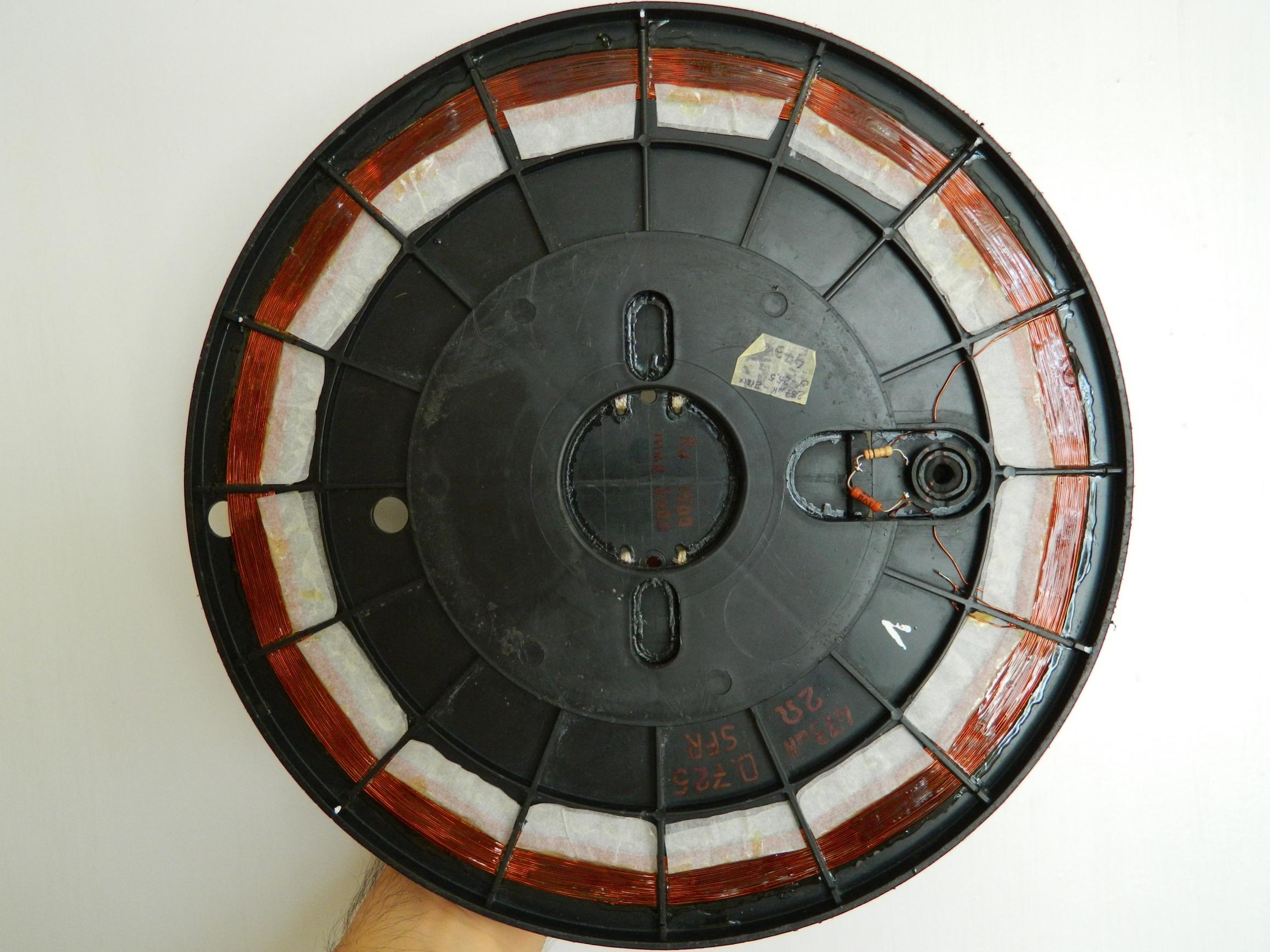

                  I need some more help, guys. I'm trying to detect non-ferrous material golfball-sized and larger, at depth...maybe 24" deep. This material, is a high-conductor. It gives a low tone on my TDI SL. I'm going to make my own coils for the Delta Pulse. All things being equal, do I want a high inductance around 1,000uH, or low...350-500uH, to optimize my detecting. I'm thinking of a 20-24" coil. The 1 meter coil that came with the Delta is 600uH. It detects a 1 kilo hunk of this material at 17" in air. I'd like to do better.
                  I appreciate any help.
                  Jim
                    Jim

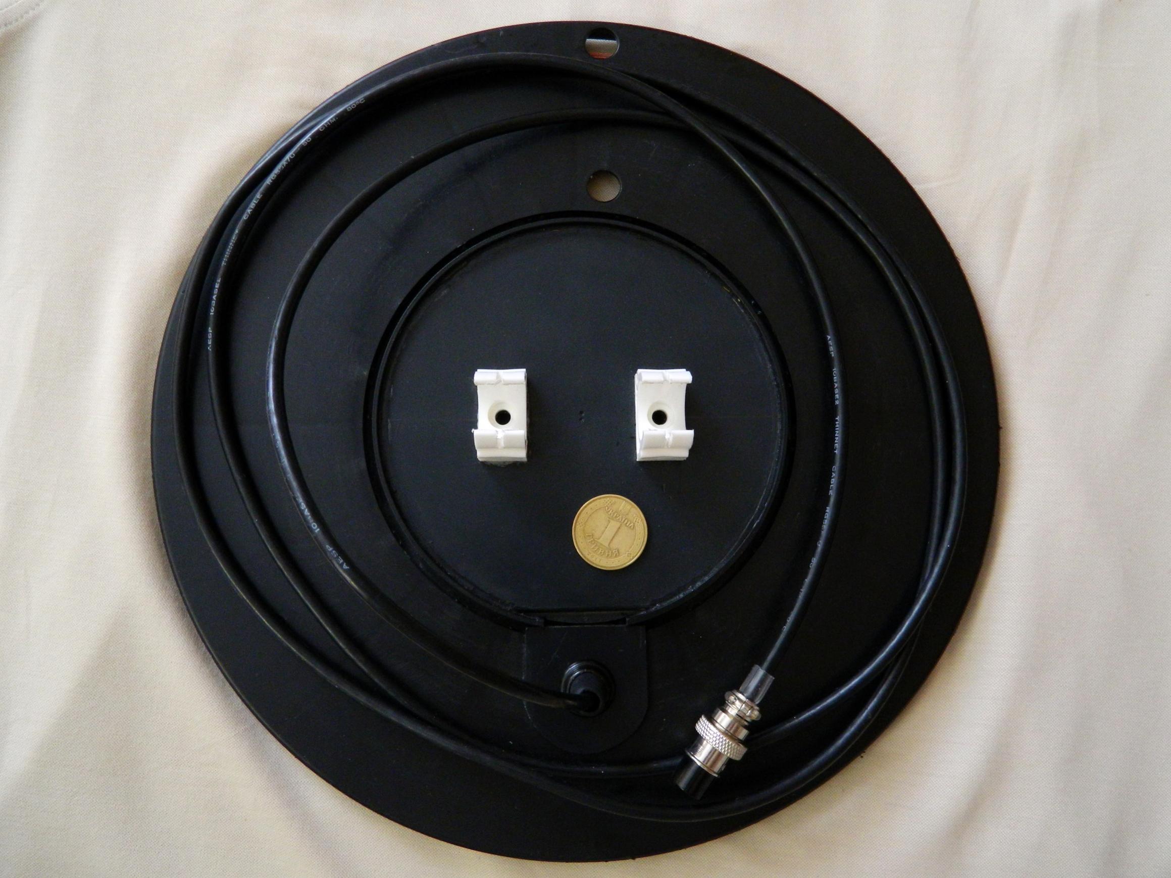

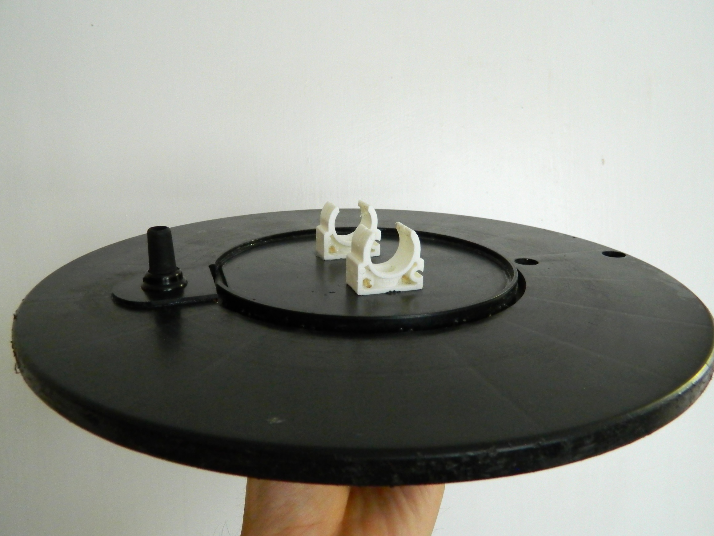

                    Quite deep target fo such size. You can try to made flat coil 450-500 uH + 2 ohm resistor in series. Than Increase pulse width until power supply curent reach 120 mA. With these settings i detect 1 grivna coin up to 45 cm, yes, in the air offcourse. My coil are 27 cm in diameter. I can make foto of my coil, but little bit later.
                      Here is my coil foto. Inner diameter -24 cm, outher - 27,5 cm, number of turns ~27. I use 0.55 mm wire, but 0.4 - 0.5 mm will suit better.
                      (Inductance 473 uH, resistance 2 Ohm, coil only SFR 0,725 kHz, damping resistance 890 Ohm)
                      With this coil coin detecatble at 45 cm in the air, so i think with 17" coil you can detect your target easy.
