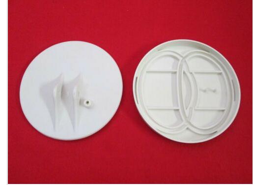

    I was wondering if i use this coil mold in the shape its in, as a DD, will i at least get a 5 inch knife edge since it is a 5inch round coil, or will i just get a DD that works as concentric.

    The sensitive area is where the two coils overlap.
    With the most sensitive where the overlap is widest.
    If that coil shell is 5 inch diameter on the outside then the sensitive width looks to be 1.5 inch
      Thanks, so that is why DD are elliptical, and so long, so you end up having a long narrow knife edge in the middle where the space is the same, i will pass then, but it would make a nice shooter DD small round coil maybe.

          yes, if you notice in your pic that the DD round has a lot of equal space in the middle, the pic i posted does not because the plastic divider cant be changed, so there's only a small window or space in the middle, it might make a decent DD coil in a mono shape though,but would act as a concentric, but would pinpoint well. but when using DD on my vlf i get a knife edge to cover more ground, so don't have to overlap so close, that's why i was asking, but the pic i showed, i cant make the space in between the coils, the same distance from edge to edge as in your pic.

            That looks like a Butterfly coil. You won't get a "knife edge" from top to bottom as the sensitive area will be under the overlap.

                I was thinking the over lap wouldn't work as i wanted to,

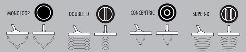

                        https://www.geotech1.com/forums/atta...6&d=1598413327 Can someone explain what the pictures are showing. Appears they select a target just detectable at near coil diameter and show detection distance or amplitude when target is not over center of coil?
                          It is the shape of the magnetic field of the Tx coil.
                            ITMD draws magnetic field of the Tx coil different(page 44).
