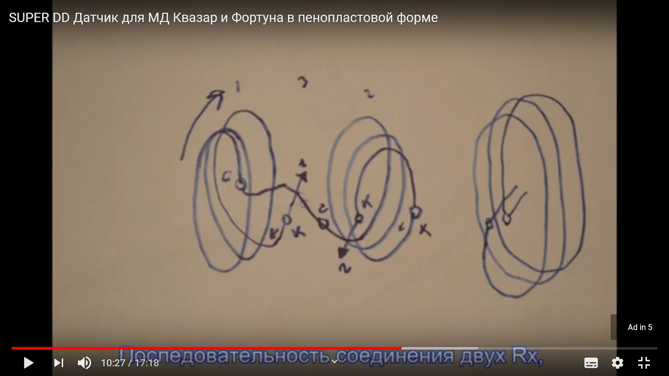

                Thanks, following this drawing for winding the coils not sure if its correct, will find out the hard way I guess

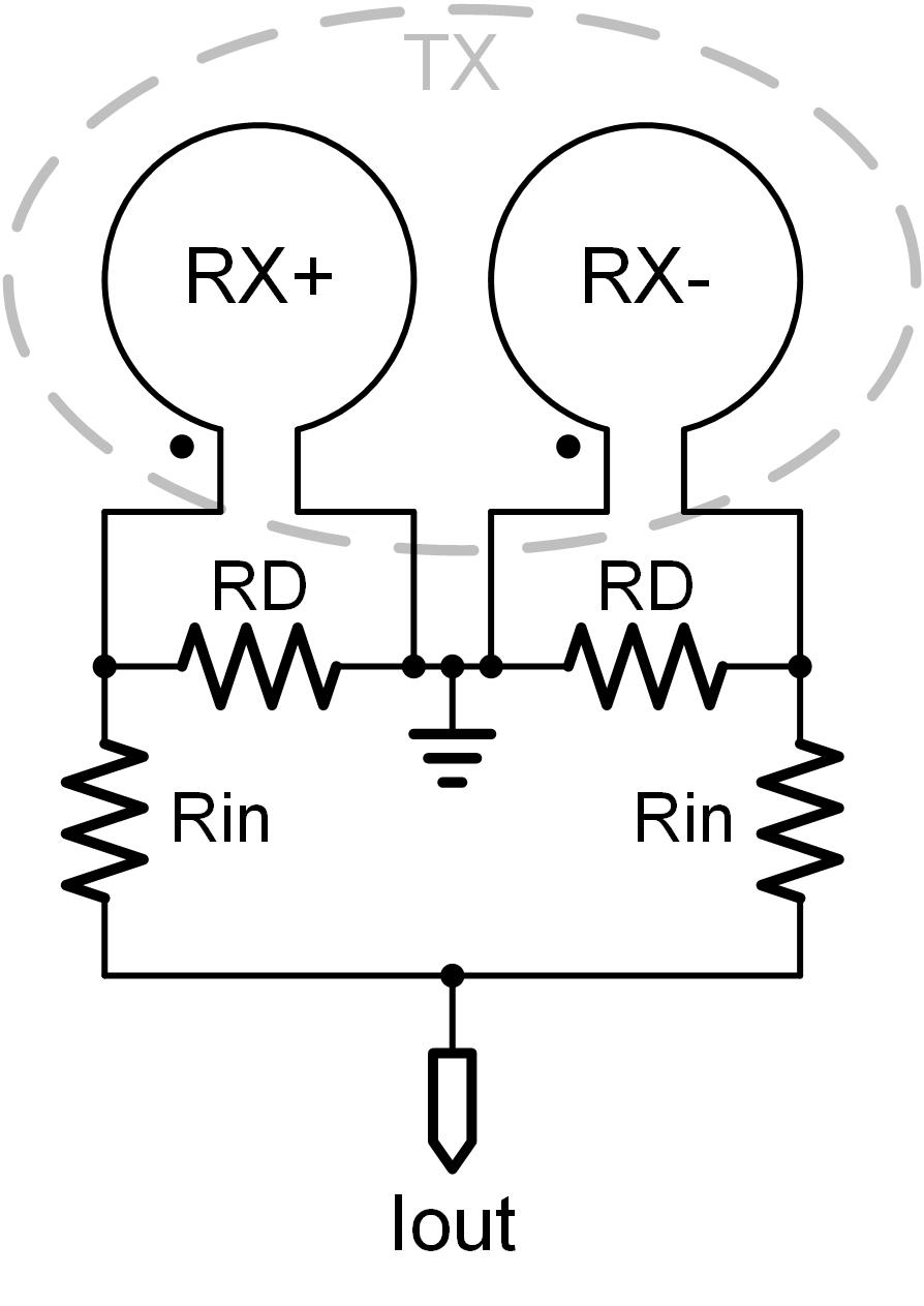

                    Both Rx coils are wound the same. Connect in series, end winding of each coil connected. Start winding of each coil for coil. Probably need a damping resistor across each Rx coil at coil, something higher than critical damped(maybe 1.5 to 2 times critical?).
                      You might need to individually dampen the RX coils before summing them.

                          Got a bit distracted yesterday, my DOD has to fit inside a 12' housing so its a small scale project, I will probably try it on my PI4 modded to take a DD, damped and wired as per Carls drawing for first try, each coil damped with 390 Ohms and 1K series resistors
                            Well so far the TX measures 320uH and the two RX coils measure 333uH together

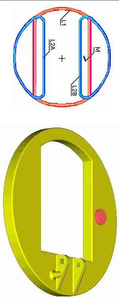

                              I recently cut a defective GPZ 7000 DOD 14 inch coil open and found the following;
                              GPZ 14 measurements with full cable
                              Receiver 6.2 Ω 427 uH
                              Transmit 0.38 Ω 312 uH
                              There is a small printed circuit board in the center of the coil where the coil cable is attached. It has a 1k resistor across each receiver coil.
                              The two receiver coils are wired in series (signal and inductance adding). They are connected to a small coax that goes to the electronics box.
                              The two ends of the transmit coil are not in a coax. They are a twisted pair going to the electronics box.
                              There is a rectangular Ferrite housing surrounding the printed circuit board, for EMI out/in?
                              The entire coil assembly is shielded with two paper sheets painted with graphite on one side only. The graphite coating has a resistance of 150 ohms when placing the probes 1 inch apart. At 6 inch separation it measures 240 ohms. One sheet is on top and one on the bottom. Each sheet has a small bare wire taped down across the graphite surface. Each sheet is over lapped around the perimeter by short 22mm cuts/tabs to allow easy bending and fitting then taped by masking tape to hold them in place. The clean side of one sheets tabs laps over the painted side of the other sheets tabs in a manner that the graphite tabs from one sheet does not short out to the other sheet. This allows the overall shield to act as a Faraday shield. The two bare wires are connected to a single ground wire that runs up the cable to the electronics box.
                              The transmit coil is approximately 4 mm above the receiver coils. The transmit coil is approximately 1 cm above the bottom of the coil housing. This spacing is to reduce the magnetizing of nanoparticles in the ground.
                              The transmit coil is wound with a large diameter Litz wire. The receiver coils are wound with very small Litz wire.
                              The entire shielded coil assembly is suspended at the top center by four soft rubber cushion mounts in a manner that prevents it from touching the inside of the entire coil housing. This prevents most false target affects from bumping into rocks and brush.
