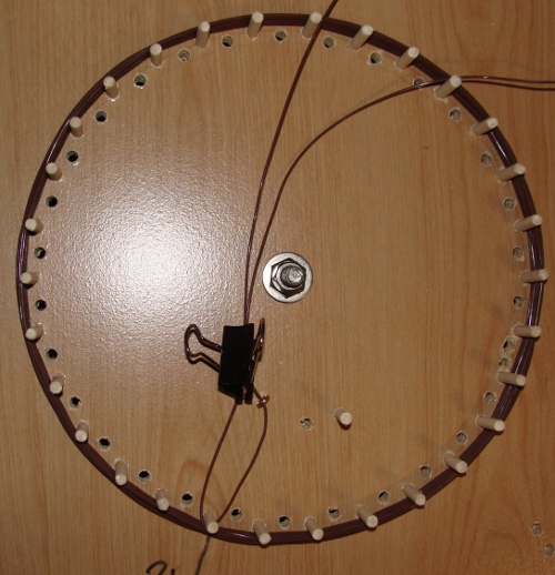

      Just made my first coil, using the calculator in coils forum, 9 inch, 22 turns of .22 awg insulated wire, copper 300 volt, pvc coated.came out at 1.1 ohms, 280 MH,going on a surf pro. Have to tighten up and wrap
        [ATTACH]53427[/ATTACH]
        Just for the future what you have written is milli henry with the M, the unit is u for micro henry, so it would be 280uH
        Also if you want a bit more accuracy with the Qiaozhi calculator, when using thick insulated pvc wire like that use the outside diameter of the wire for the wire size .
