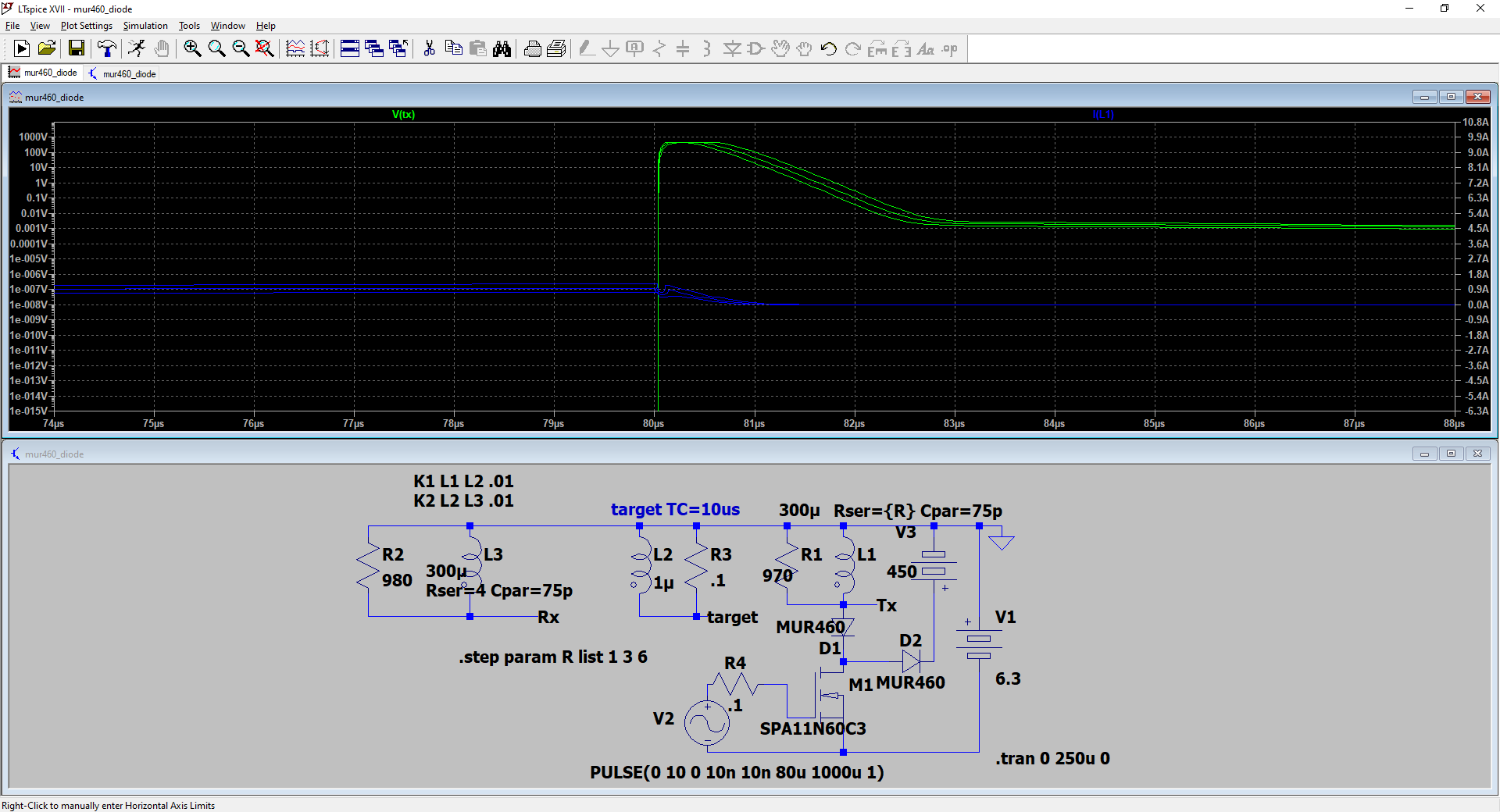

        I would suggest learning spice if you haven't already. Can change component values. Step a component value to see change. Lot quicker than building a circuit and should be similar except for noise level. Simulation target TC=10us(US nickel)

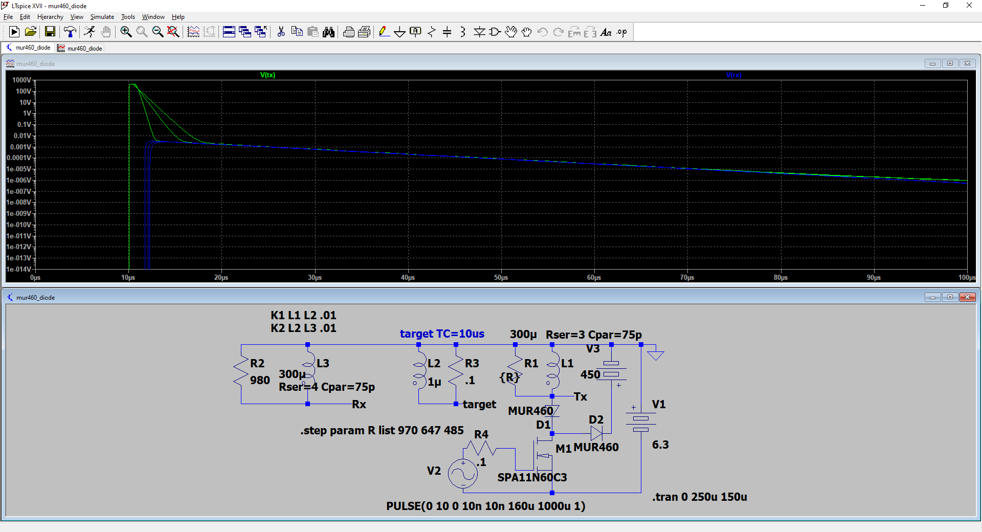

              Wondering why increasing coil resistance would increase signal, tried with spice simulation reply #18. Didn't increase with what I tried, maybe missing something.

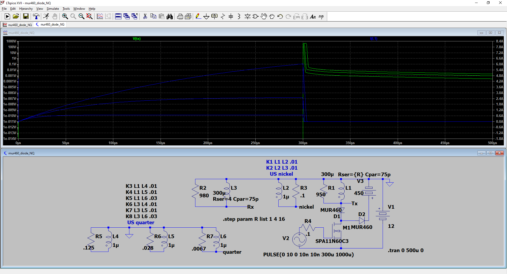

                      Added a US quarter to simulation. Adding resistance still lower signal. Maybe I'm doing something wrong?

                            Increased PS to 12V. Tx on time 300us(current flat tops with higher coil resistance). Lower coil resistance still higher signal.
                              Labeled R7 L6 quarter, not correct. Look at Rx for quarter decay, Quarter is combination of the three RL circuits.
                              Quarter simulation https://www.geotech1.com/forums/show...210#post258210

                                Couple reasons higher coil resistance could cause higher signal. Circuit doesn't like higher Tx current for some reason(simulation doesn't care). Higher coil current takes longer to decay, not enough delay time(sampling when amplifier saturated). Any others?
