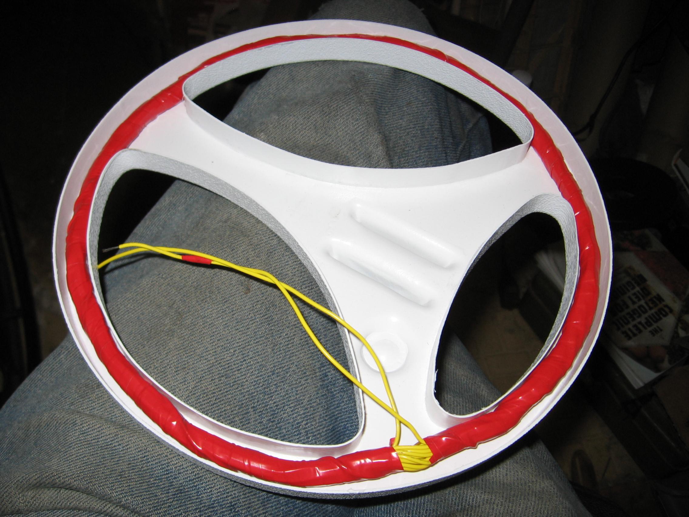

      just bought some remington wire,22awg,made a 9 inch coil, 280 mh, 1.1 ohms resistance,
      Tried to follow your fast coil build bbsailor

        after tightening up with electrical tape
        .320 mh
        1.1 ohm

          Matt,
          I believe your coil is 280 micro Henries or uH. Making a fast coil requires doing a collection of things that all point in the same direction to allow the coil to see lower capacitance within the coil windings, coil to shield capacitance, MOSFET COSS or output capacitance, coax wire capacitance that connects the coil to the PI circuit board. When a coil sees less capacitance a higher value of damping resistance can be used because there is less energy in the flyback pulse oscillations that can be damped quicker thus a faster coil.
          When you are able to get the delay below 10 uS, you need to be sure that the coil wire is not retaining any eddy currents beyond your desired delay time as at minimal delay settings the coil wire might be seen as a target if it holds eddy currents too long.
          Try to use a polyethylene spiral wrap on your wire to keep it tight and try to use Scotch 24 wire mesh in a single layer around the coil. Do not overlap the wire around the cross section of the shielding wrap to prevent any eddy currents from developing in the shield wire itself. If you do overlap a little, just place a layer of electrical tape over it to prevent forming a conductive loop. Just leave a shield space where the coil wires enter and exit the coil winding.
          What PI machine is the coil planned to be used with?
          Joseph J. Rogowski

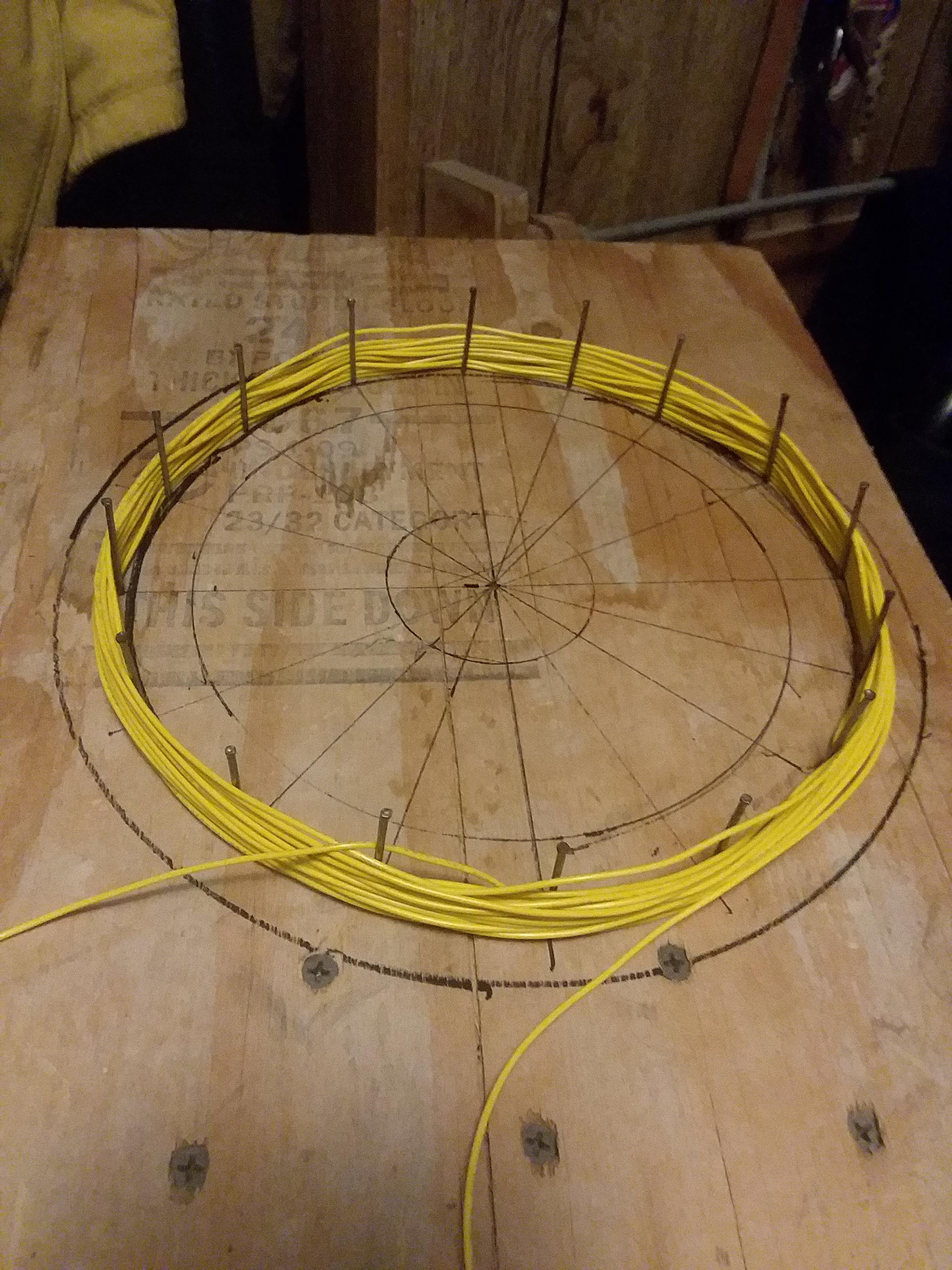

              Just as a follow up...
              I used the coil calculator, and input the diameter of the wire ONLY, not including the insulation (although now I'm reading that some people are saying I should include the insulation). I have a shell from Mr. Bowers that's close to 8" and planned to fit the coil inside. Anyway, what I currently have is a coil about 22 turns. I don't have an inductance measuring tool (although I'm waiting for an inexpensive lcr I bought on Aliexpress), so the only thing I know of that I can do is to measure resistance, and also to see if the coil works! The coil seems to work - picks up my hand with a thin wedding band at least from about 5-6". But the resistance seems high to me - it measures about 5 Ohms; the ones I made from magnet wire are only 1.5 Ohms. I'm not sure what to do at this point...I don't want to burn it out. I guess I'll check the calculator again with the total diameter of the wire... If anyone has any suggestions I'm all ears...

                The thinner the wire the higher the resistance depending on the length, turns etc, but I've done a quick calc based on an outside wire dia of .68mm, 8 inch, 22 turns, calcs to about 270uH, so close enough for testing.

                  Thanks. The lcr I bought is this one:
                  But I'm not sure what that all means with regards to the resistance being at 5ohms...Isn't that too much? I don't want the mosfet or anything else to burn out...I'd like to aim for a semi-fast coil, and I would think that using this wire isn't going to get me there...? Wondering if I should go back to the magnet wire...
