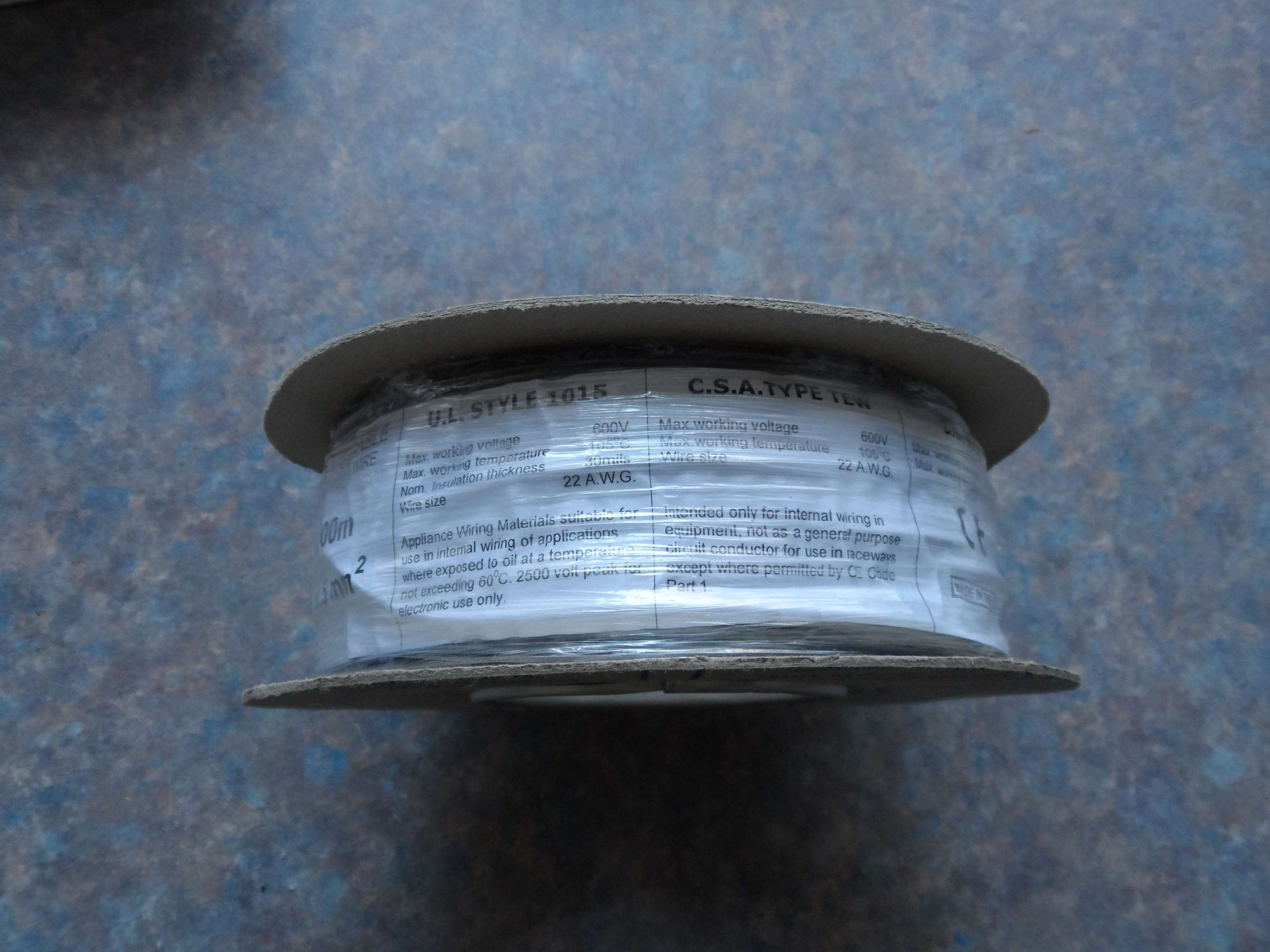

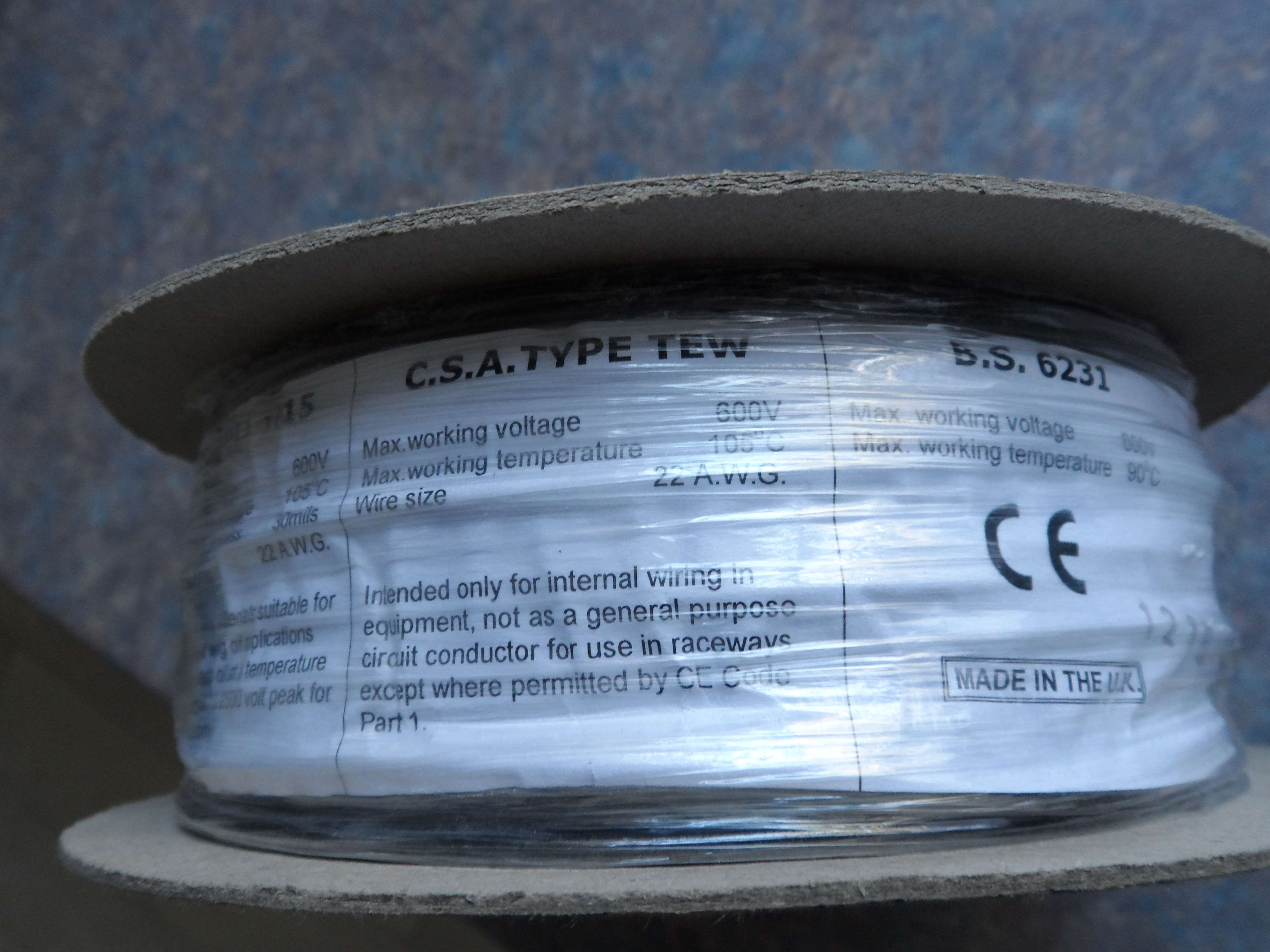

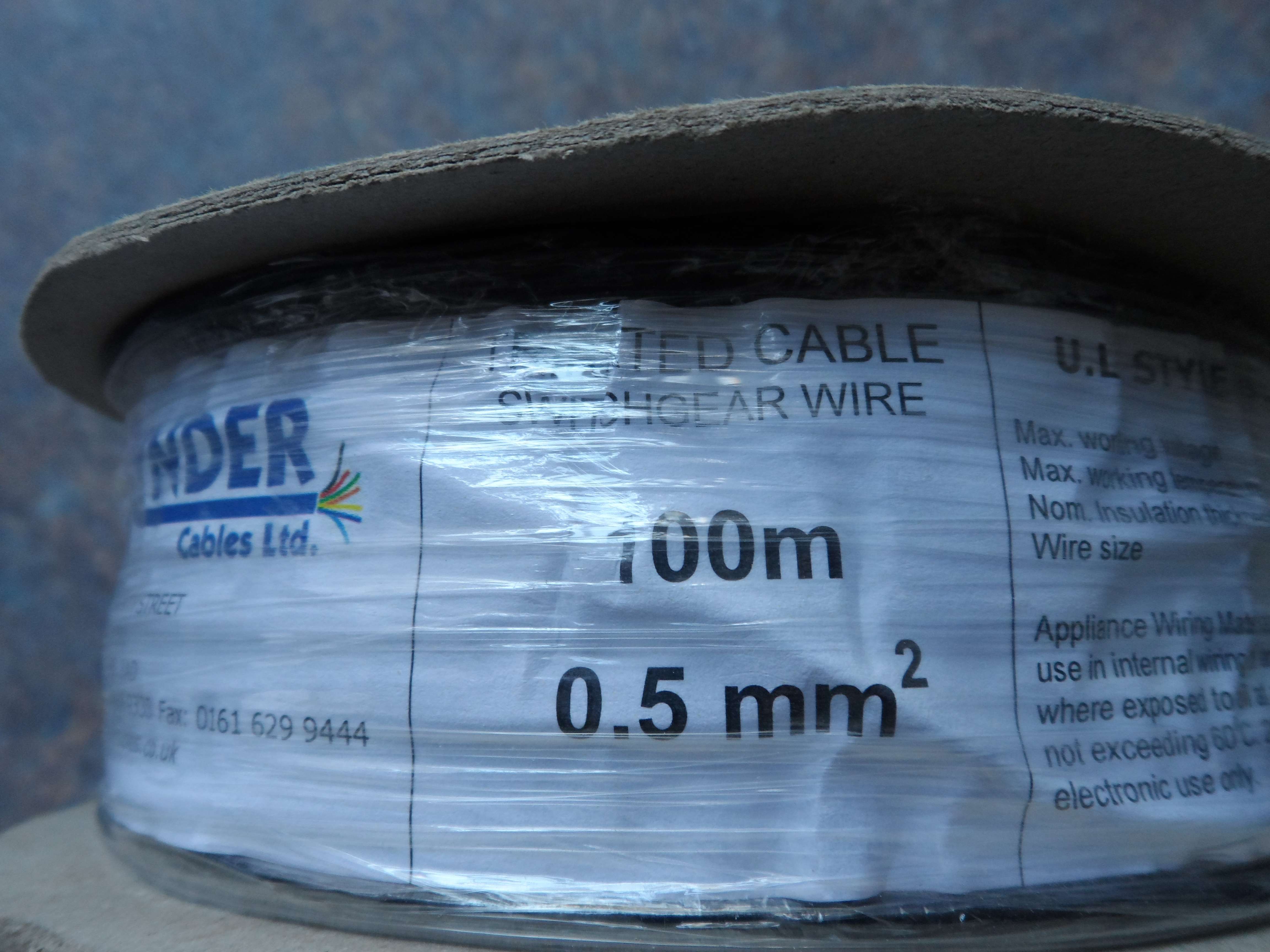

            Hi Martin, Sound! If I can can permission on that Farm then maybe we could meet up and detect it sometime when all this Covid crap is under control!,,Lol. Exchange a few ideas too! What is the Tufnol you mentioned? Is it the coating on the wire or for Vacuum forming? Yes, I noticed your (safety warnings! I always take heed to people who know what they're talking about! I've done all sorts in my time, I'm a joiner and disaster recovery technician by trade, but I make my living as a professional vocalist. I did a 3 year stint in the R.A.F in the 80's and I teach Wingchun and Jeet Kune Do classes (Unpaid) just because it's a big part of my life and I love it. I used to have a main hobby before Detector building, which was breeding and training Birds of Prey but I don't have the space for it now,,,just Gung fu and Detectors!,,Lol. I've not found that link for you yet but I'll keep searching for you. If you're ever up this neck of Yorkshire I have a spare reel of the wire I use (brand new) if you ever want to call in for it,,,free of course,,a new friend gift. I know we're still under restrictions with the Covid but you're welcome to a reel of it if you want. Regards, Marty.
              Hi Martin, I took some pics of that new full reel cos' it still had the details on. It's from a company called 'Lynder'. See attached photos. Regards, Marty.

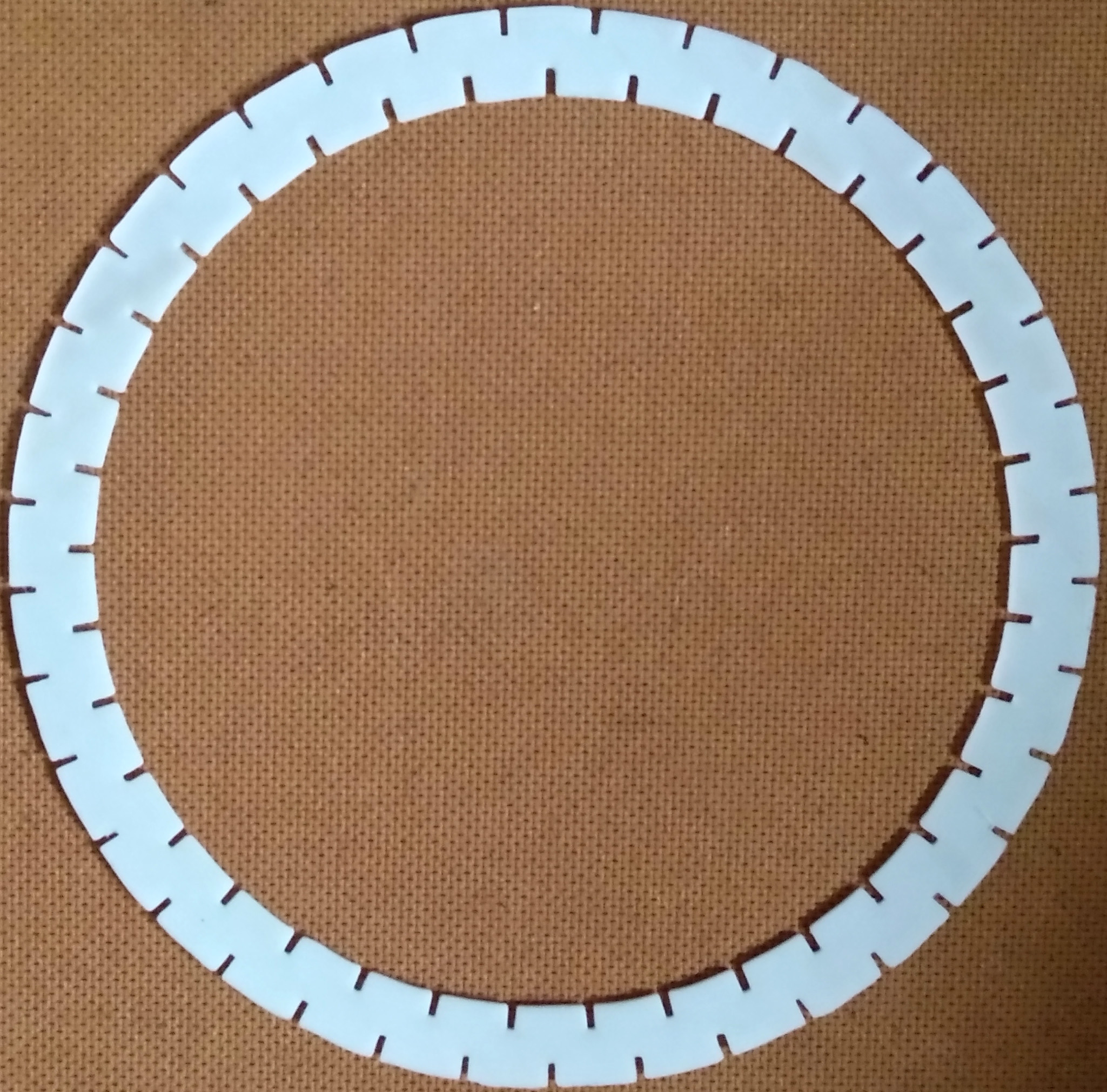

                            Regarding the Russian thread that is cited in answer #5, since I am lazy to make the mold for the coil by hand and also do not have suitable material on hand to do it, I have decided to build a 3D model to be printed. I share it with you in case it helps someone.
                            A zip with several files is attached. The gcode is optimized for Ender 3 and the obj is oversized, so if you use the obj, don't forget to resize it to suit your needs.
                            Note: Let no one expect a work of art, but it is functional
