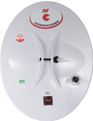

        i've gotta Minelab 15x12 Elliptical Mono Commander Coil , i'm gonna try to wind a coil for my white's SMPI original , what do you guess ?
          I've personally had good success with 0.1mm*100, silk served. While not absolutely identical, this is what I've found to bring results closest to the ML PI coils I've had available to test. Could probably even be better with 80-90 strands, but I haven't tried that.
