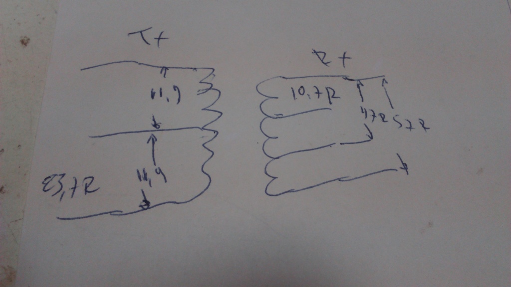

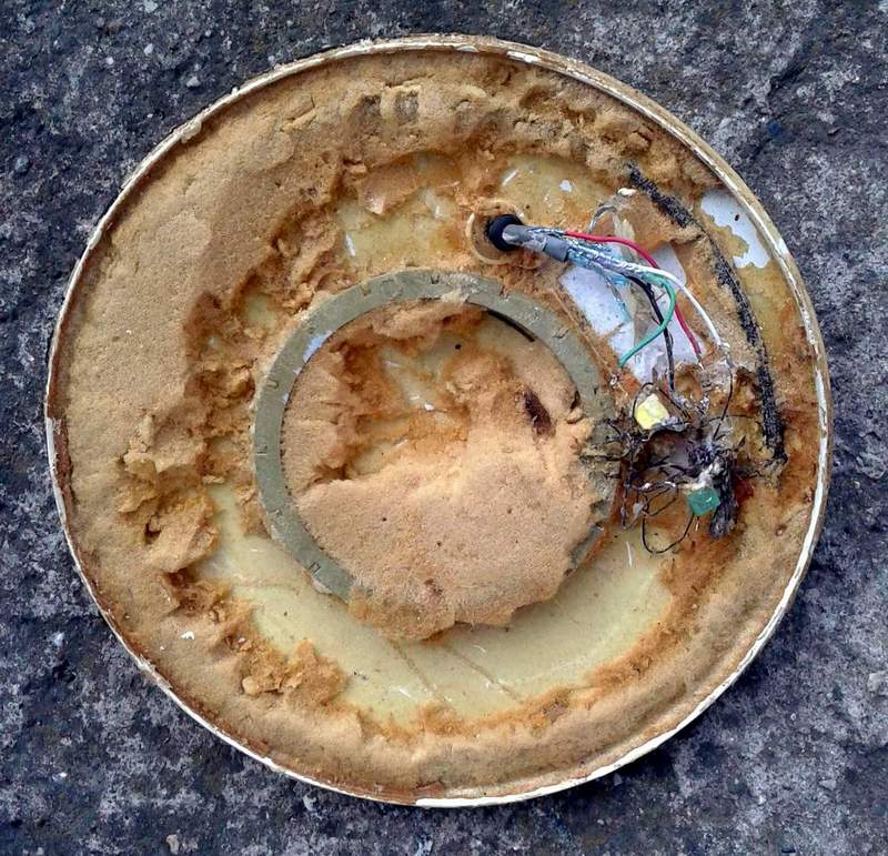

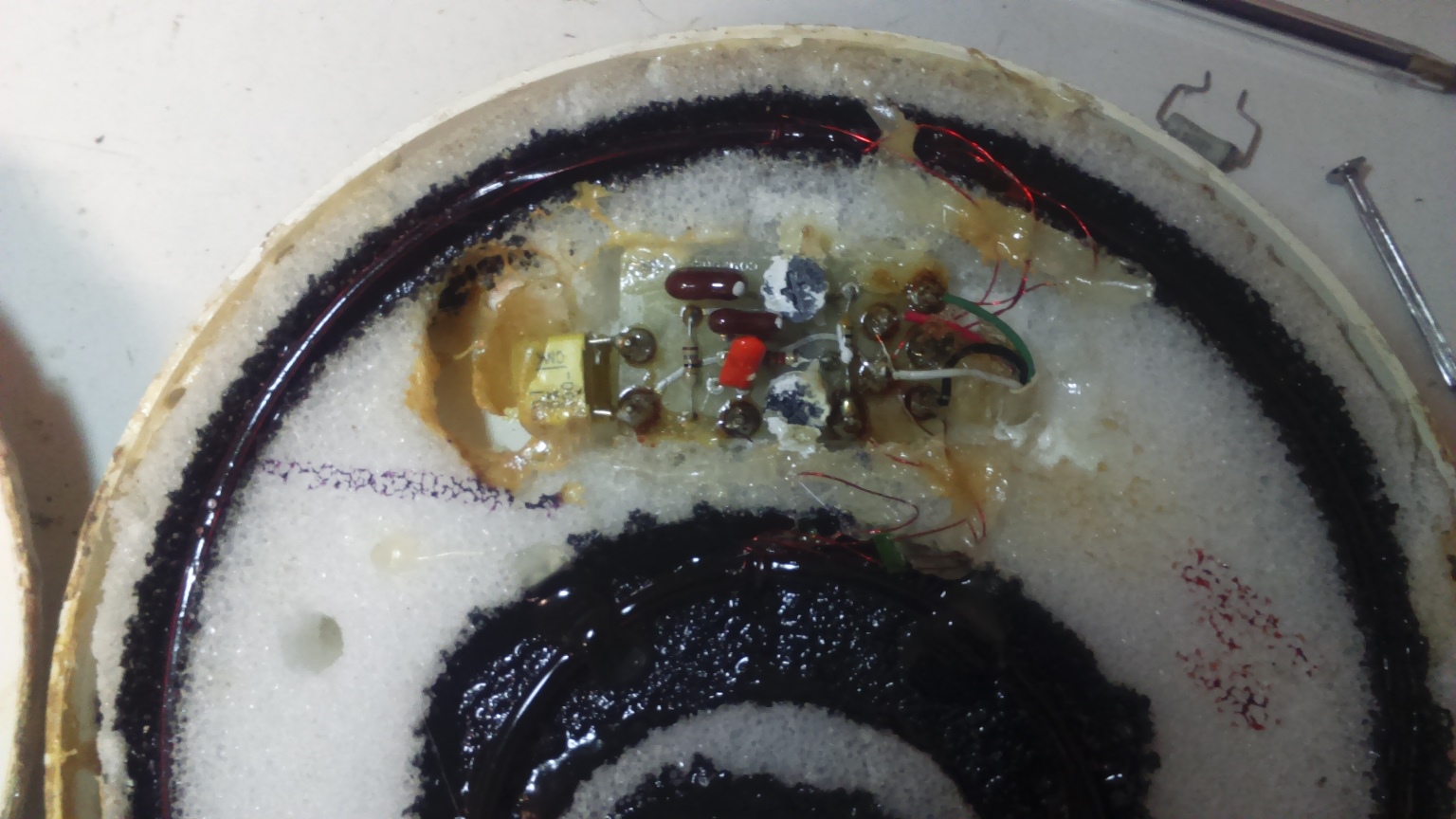

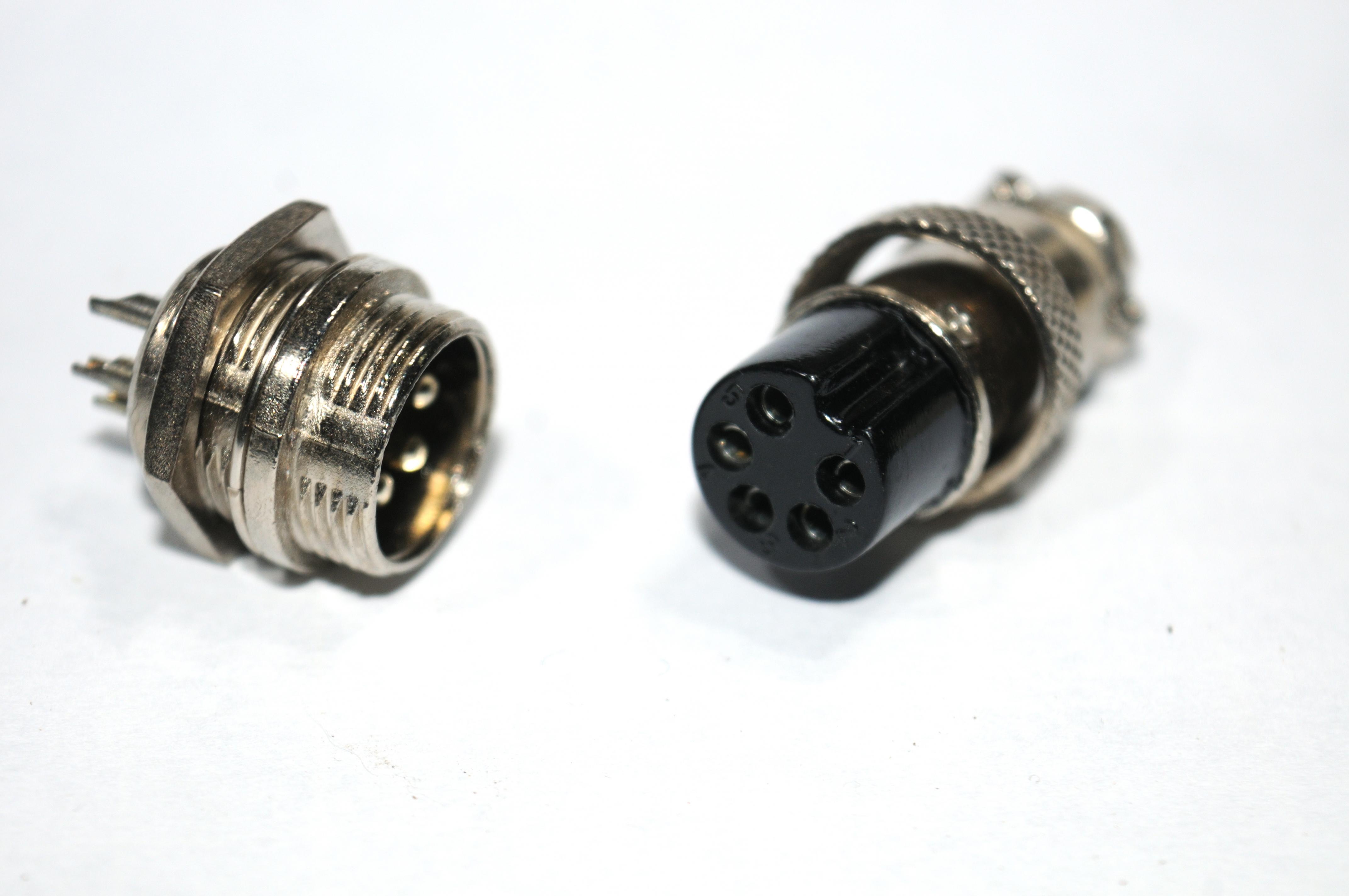

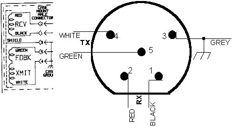

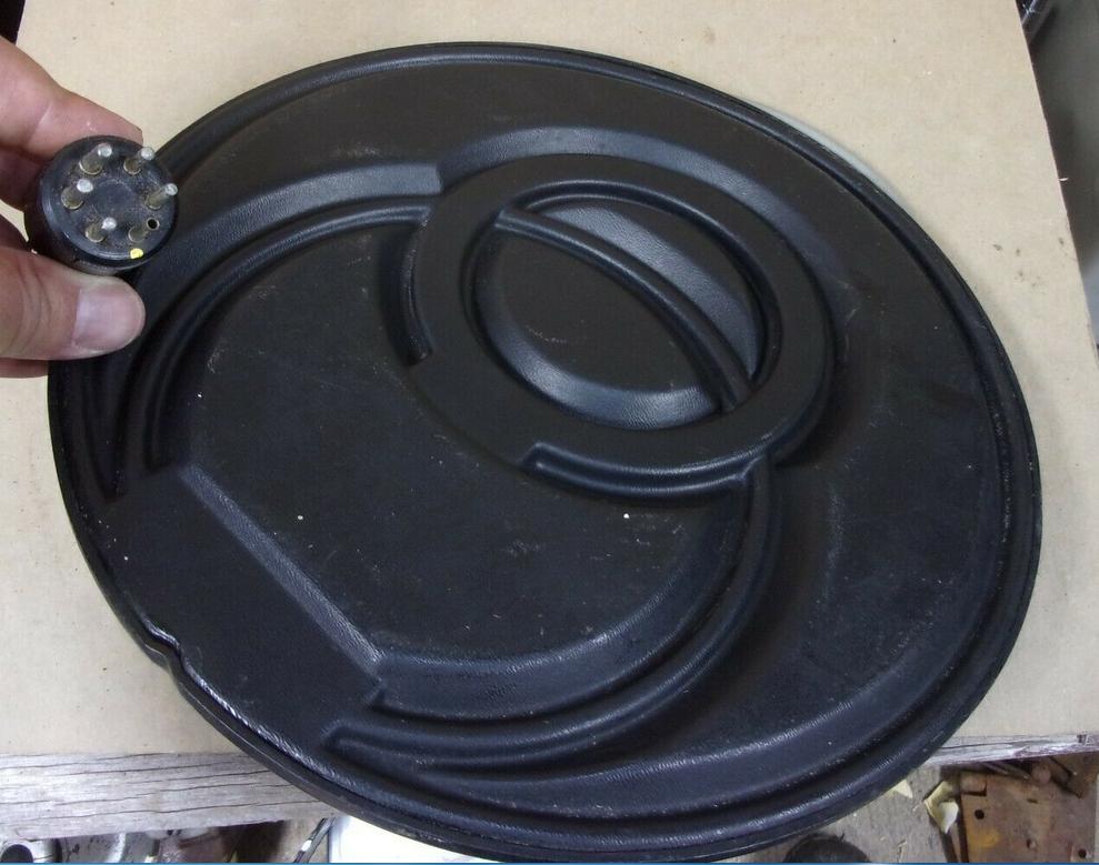

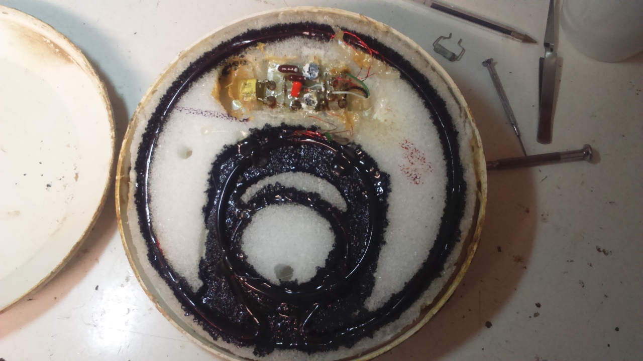

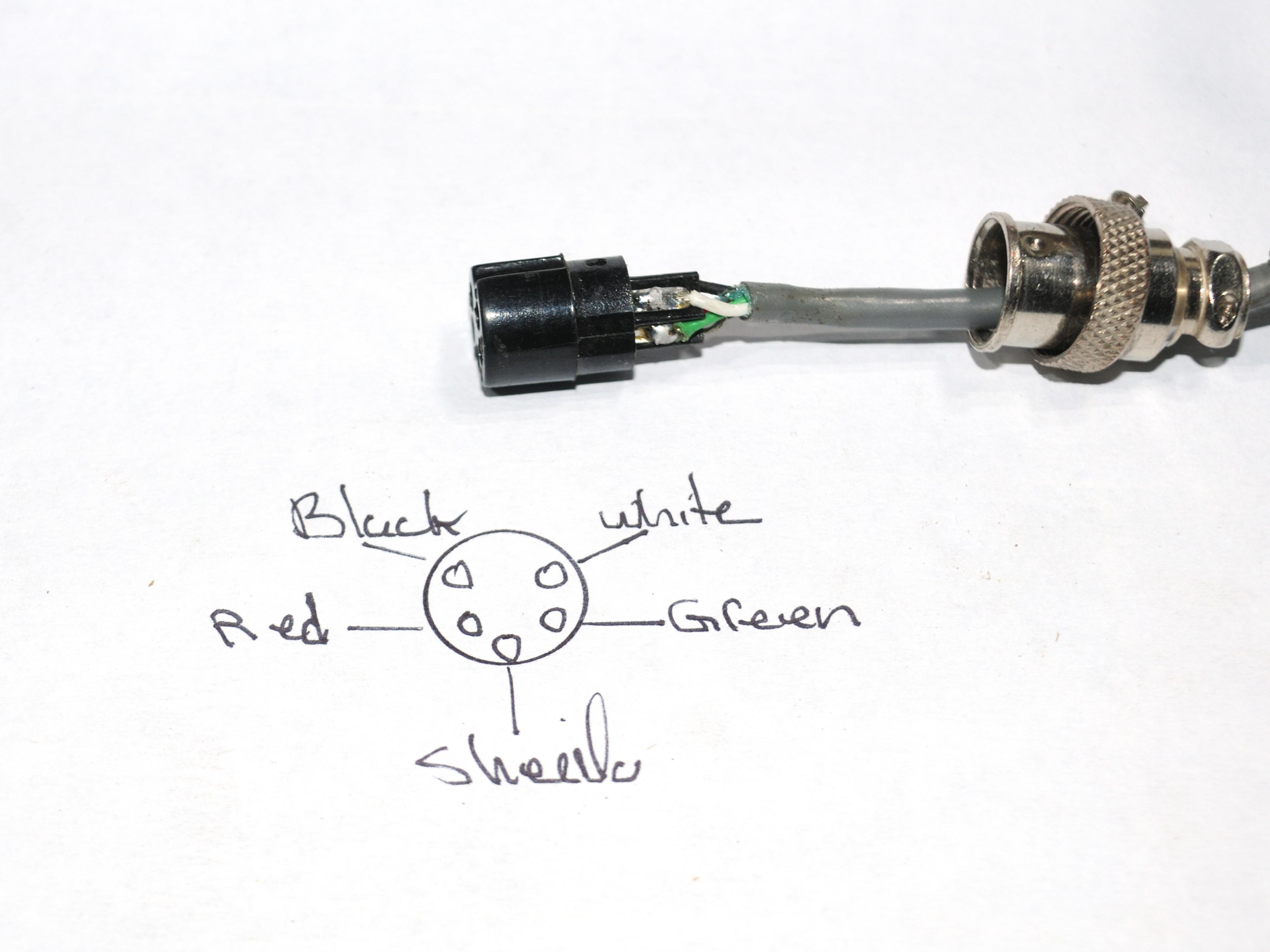

Need to test a 8in coil to see if it's good . Plug is 5 pin , which plugs should show continuity ? Just got this coil in today and it looks brand new but after plugging it in I have no response to metal at all and the detector hums at threshold- thats it . Detector looks like it received very little use but I have something amiss somewhere .
Vintage White's 6000 series II Coil Test
Originally posted by ric44 View PostNeed to test a 8in coil to see if it's good . Plug is 5 pin , which plugs should show continuity ? Just got this coil in today and it looks brand new but after plugging it in I have no response to metal at all and the detector hums at threshold- thats it . Detector looks like it received very little use but I have something amiss somewhere .

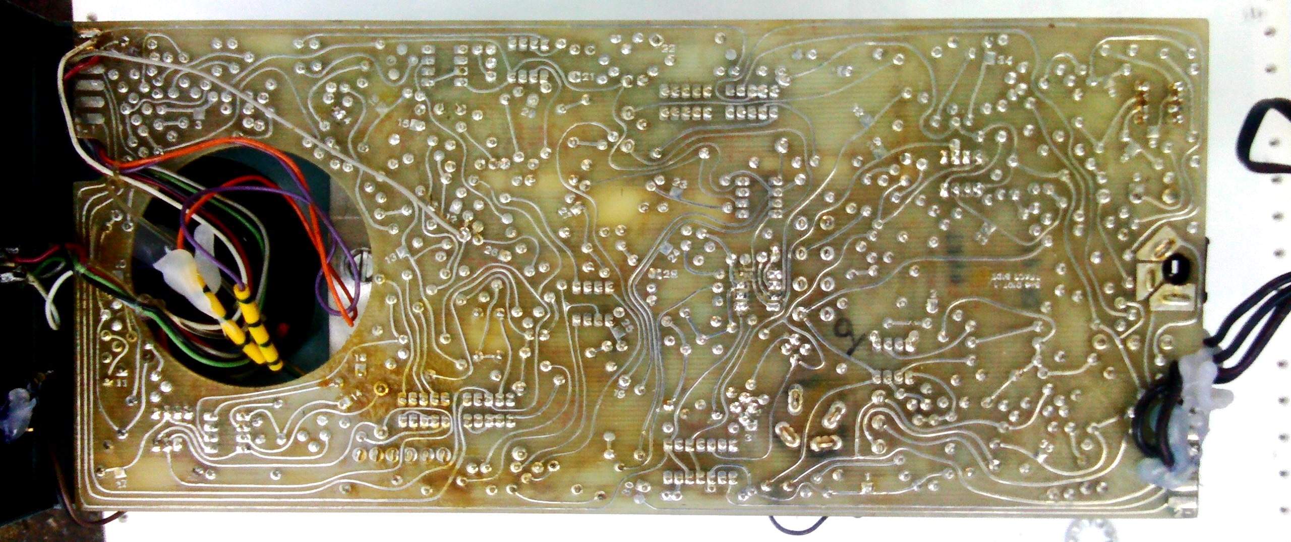

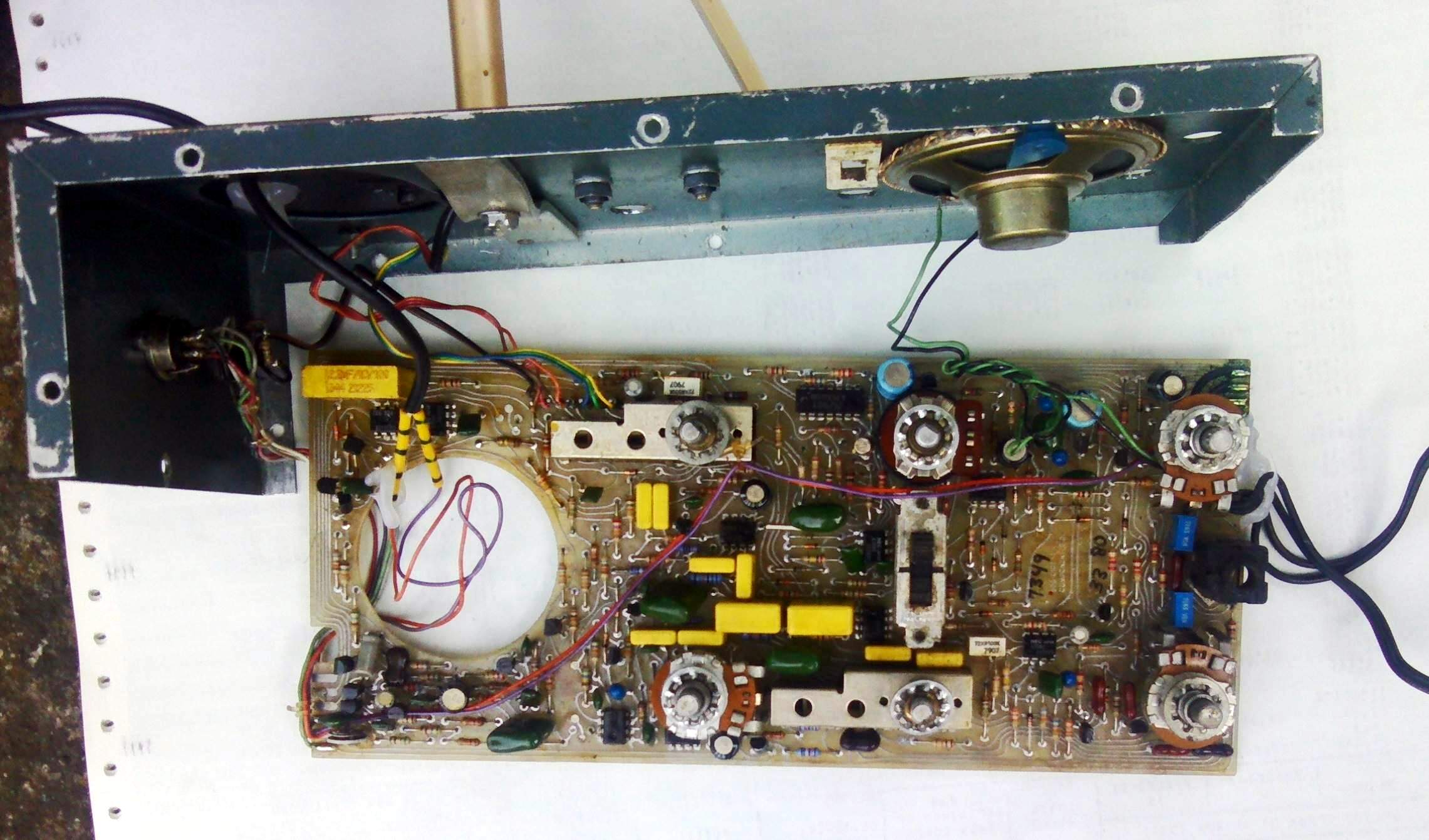

All I have is this.Attached Files
