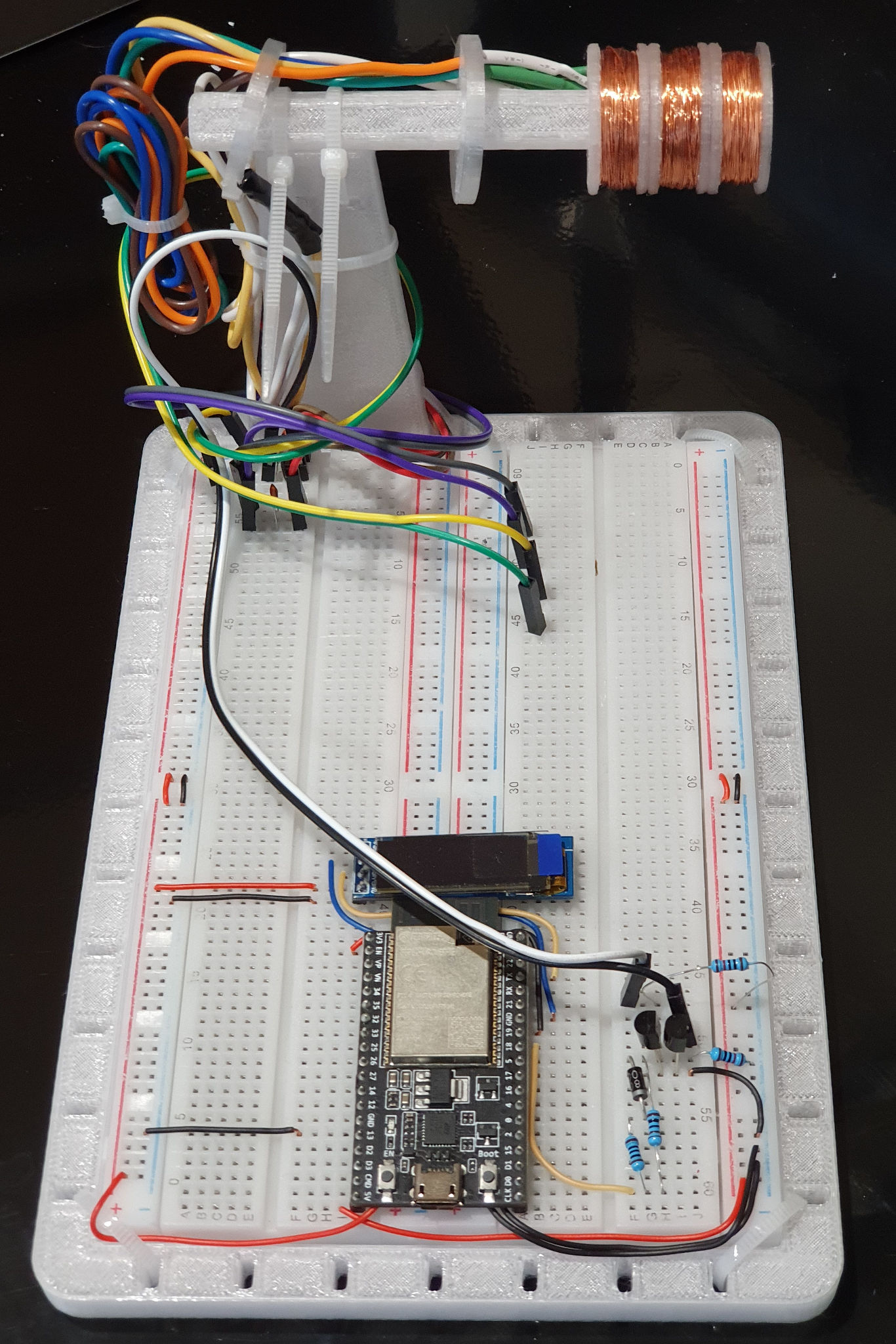

              Here are some images of my prototype so far (though as per previous posts I may be heading in the wrong direction, would love to try and re-create the coil concept described by Carl for the SunRay or the Whites TRX pointers).
              This is my prototype:
Name:	Breadboard Pinpointer Coil Prototype.jpg
              The coils are on individual bobbins with an opening in the core for a standard 10mm ferrite rod with flats. I tried on that originally, this pic shows it with a 3D printed plastic rod that is the same shape/size (to test in more of an air core scenario)

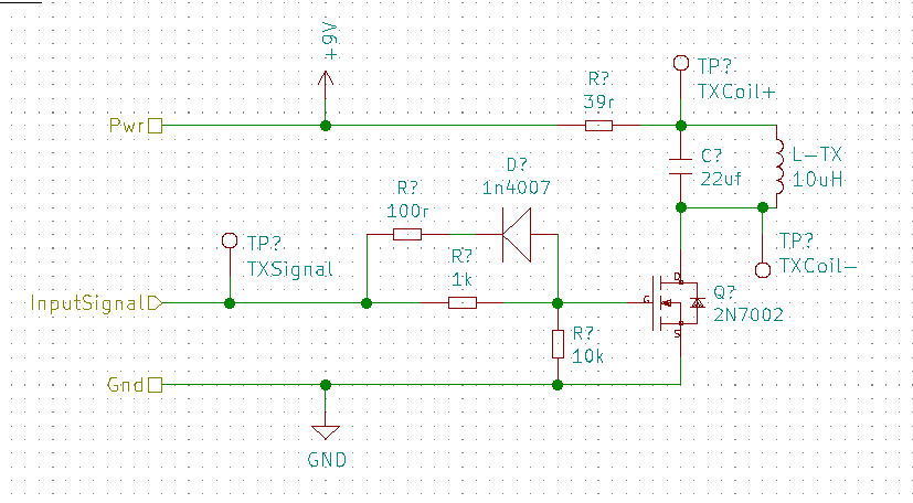

              And here is the schematic I'm currently experimenting with to drive the TX coils (right now I'm just looking at the RX coils with my scope directly):
Name:	TX Driver Circuit.png

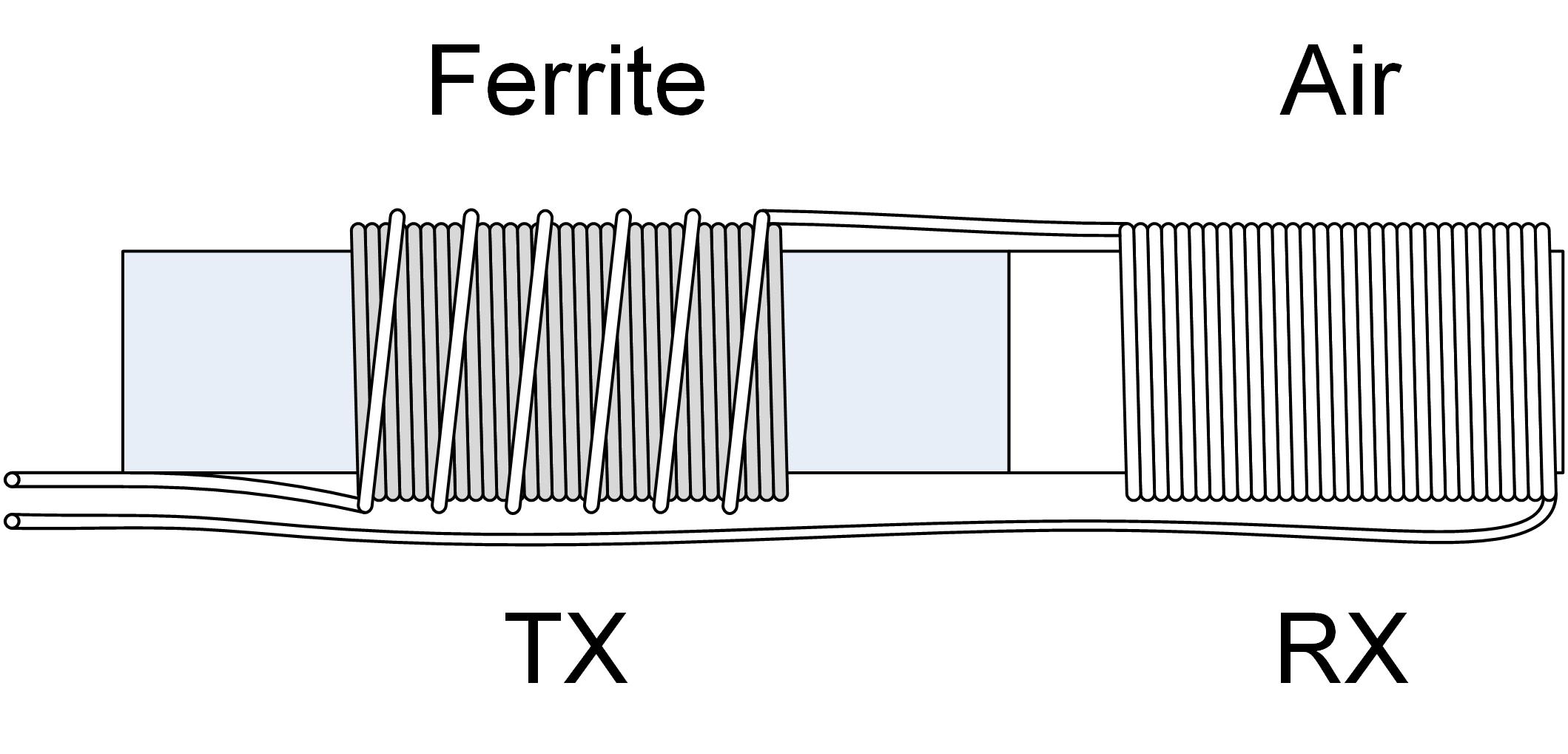

                  A picture is worth 1000 words:
                  I don't recall exact parameters but I think the TRX had 100 or so turns on the TX and several hundred on the RX. The RX wire was pretty thin, maybe 35-36 awg. Coil spacing was probably 1/2" or so. Don't recall the number of reverse windings, maybe 5-8. The coil assembly was slid inside a short piece if 1/2" fiberglass tubing (made by the same company that made the White's lower rods) and potted with epoxy. After complete assembly of the circuit+coil, a piece of shield tape was maneuvered on the coil tube to tweak in the IB and affixed. Again, I don't recall the kind of tape.
                  The Sunray may have been shielded, I don't think the TRX was shielded. I don't remember. I think the TRX uses a 6mm ferrite, the Sunray was probably a lot bigger. The TRX was epoxy-potted for stability and I'm sure the Sunray was foam-potted for the same reason.

                      You need very close coupling between the bucking coil and the RX, so that you don't have to put much TX power into it to cancel the main TX field. Either wind bucking on top of RX, or if they are alongside, have very little seperation ( 0.5mm ? ) between them. The TX and RX need to be reasonably far apart so they don't couple too strongly, though you can't have them many cm apart, because that would mean one of them was miles away from the target, not good for target detection.

                      Ok, so in my setup I had [END OF ROD] | [RX Coil] | [TX Coil] | [Bucking Coil] | [Rod Tail]
                      In my setup I was going with RX+/TX/RX- setup (so Bucking = RX inverted polarity)
                      When using Ferrite rod, I found I actually had to keep the TX/RX coil "touching" (no gap), but had to move the bucking coil further away in order to achieve balance (had to move it like 1-2cm away from the others). This is likely due to the effect the ferrite has on the inductance (closer to the middle of the rod increases inductance), and the wierd things it does to coupling...
                      But with the "plastic rod" (air core) I had them all smashed together as in the photo to get the coupling so that RX ripple is below the threshold of the probe on my scope... But unfortunately that still means that signals below about 5mV are in the noise floor, and so sensitivity wise, I couldn't detect a coin unless it was practically touching the RX coil...
                      I think looking at something like Carl described for the SunRay, where it is RX Air, TX on Ferrite, and bucking coil wound outside the RX.

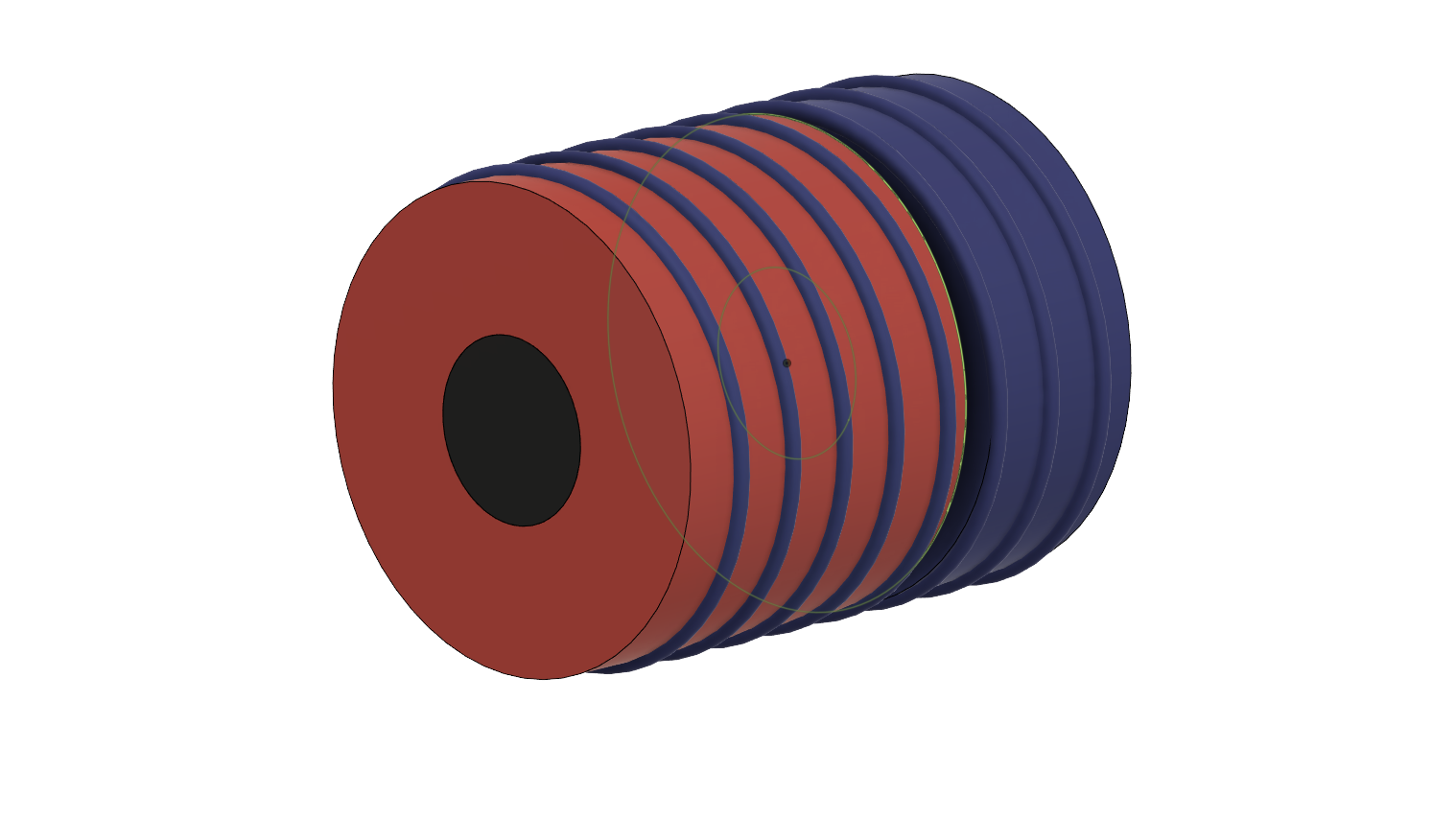

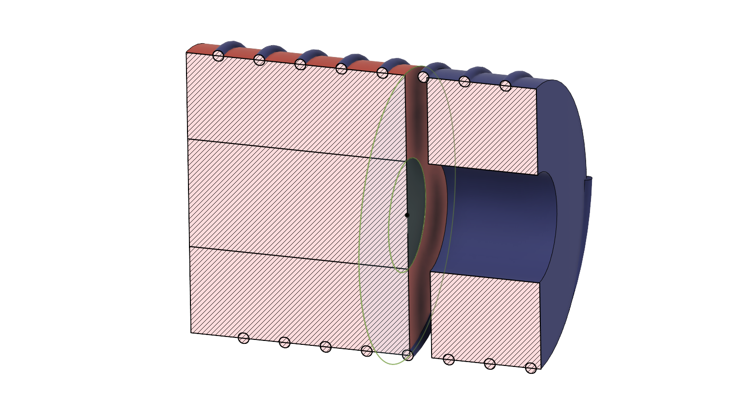

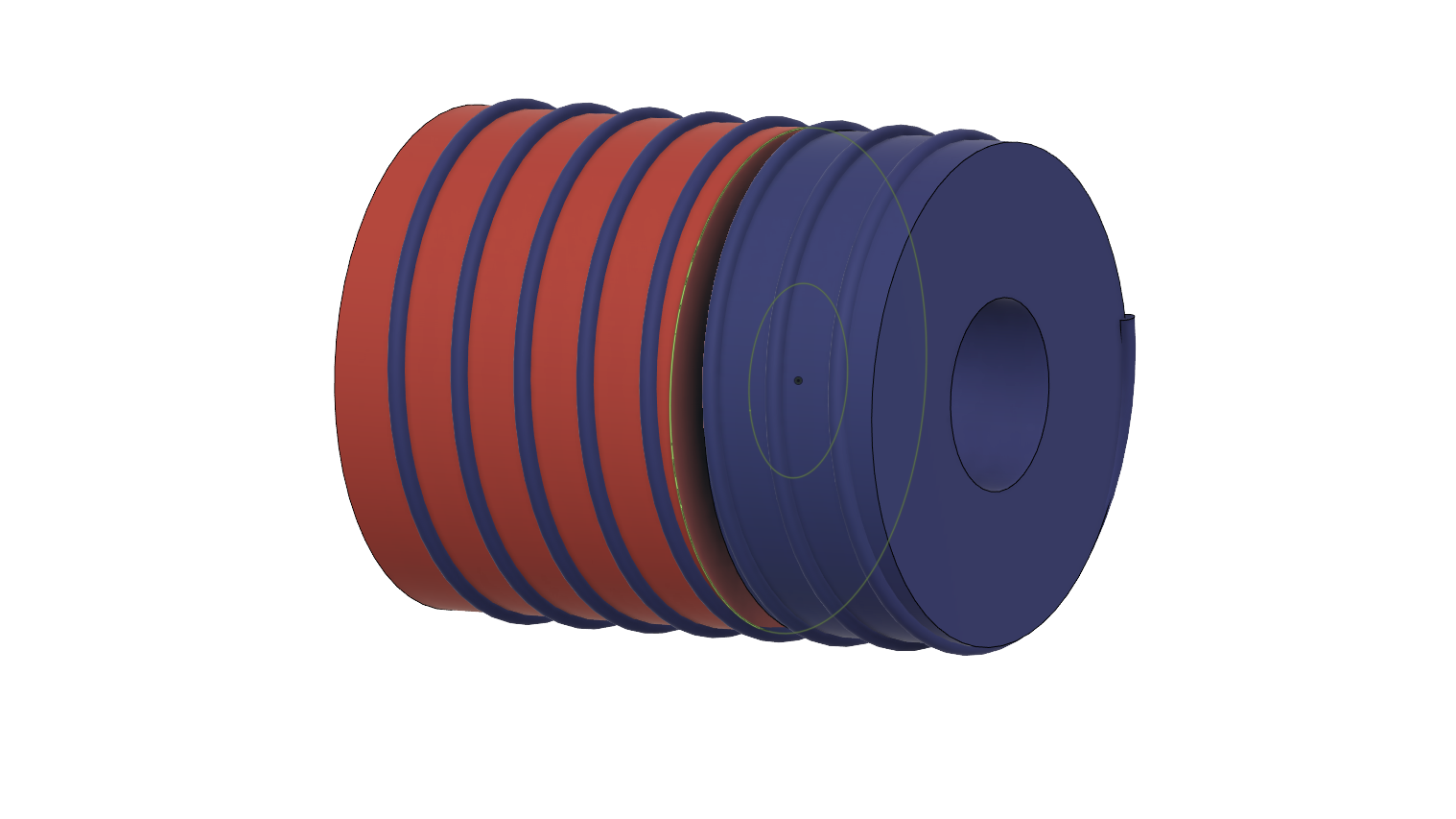

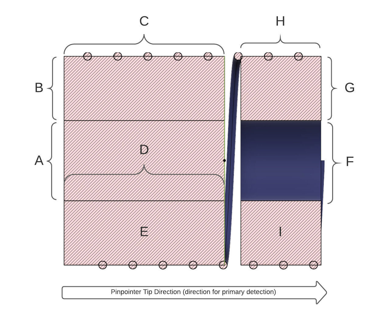

                        Awesome, that's some useful detail. Thanks Carl! Ok, so based on this, I've done a mock-up to use for discussing dimensions. This is not meant to be scale, just to identify the parts, make sure I'm interpreting your notes correctly, and possibly attach some real numbers to the diagram, from there I can do a more accurate mock-up:
                        So I'm interpreting a device which has the RX coil (blue) out in front (at the tip of the probe), and TX coil (red) in-behind. TX coil is on a ferrite core, RX is Air Core. And the RX then has some reverse windings coming back over the TX coil for balance...
                        See this crude mock-up:
Name:	SunRay MockUp B.png
ID:	358970Click image for larger version
Name:	SunRay MockUp A.png
                        And a Cross-Section of the mock-up: Click image for larger version
Name:	SunRay MockUp Crossection.png
                        And finally, a Flat Cross-Section Diagram with dimensions added: Click image for larger version
Name:	SunRay MockUp Crosssection Dimensions.png
                        Ok from that diagram, the following dimensions are described:
                        • A - Diameter of the TX Core (you've already stated this was likely around 6mm for TRX)
                        • B - Depth of the TX Coil windings (from the fact you said 1/2 inch tubing held it, probably 3mm approx)
                        • C - Length of the TX Coil
                        • D - Length of the TX Core
                        • E - Winding Count for TX Coil (you've stated this was likely 100 or so turns on the TRX)
                        • F - Diameter of the RX Air Core (ID of the coil... I'm assuming this is the same as the TX coil? so 6mm approx? or is it different?)
                        • G - Depth of the RX Coil windings (this is hard to extrapolate without other dimensions to work with such as length and core ID/Core Diameter)
                        • H - Length of the RX Coil
                        • I - Winding Count for the RX Coil (you've stated this was likely several hundred)
                        • J (not on diagram) - Number of reverse windings for Induction Balance (you've indicated this was only a few windings, maybe 5-
                        From this, can you confirm if I'm even remotely on the right track for the concept? And could you help maybe nail down any more of the above dimensions (even with rough/approximate numbers).
                        With this we could then finish a more accurate mock-up, and I could prototype a coil
                        Cheers!
                        EDIT: I guess I should have said "TRX MockUp" instead of SunRay, in that we seem to have more data on the TRX, and the SunRay (while similar in concept) is different dimensions. The idea here is to get enough info around one pinpointer probe design, to be able to figure out ratios/aspects etc of coils, which is all important to get it "just right". So for the purposes of this exercise, let's focus on the TRX dimensions above until we get a design figured out.
                        Thanks!
                          Thanks, Carl, though despite my best hacking attempts, I couldn't get the image to load. I'm surprised by how small the probe coil is, I assumed the diameter would be larger.
                          Glass: I'm not sure putting all the coils on a ferrite rod is the way to go, the rod is just going to couple them all together too well. And you don't really want much direct coupling between the TX and RX.
                          The air-core assembly at least has a 100% chance of working ( hence my choice for my coil construction ).
                          Aim for around 10% coupling coefficient between TX and RX. RX to bucking coil coupling should be high, 70%+ , so you don't need loads of turns on the buck to cancel out the TX direct coupling.
                          ( I don't have ny notes handy, and I haven't worked out the details yet, anyway, and it's a year since I did any work on it, so I can't remember much, TBH )
                          Cute though the dot matrix display is, it unfortunately has no true place on a pinpointer, which will be absolutely cacked in mud in use. A 5mm LED is going to be hard to see in real life.
                            I've fixed the image attachment above. A longer TX (or at least a longer ferrite rod) will help with depth as it keeps the magnetic field better focused, up to a point.
                              Thanks for fixing the image link, Carl. It's not too far off what I was imagining, but I thought a larger diameter larger-bore shorter-length air-cored section may have been used. And I agree that a longer ferrite rod would be better, something 60mm - 100mm, as used in most handheld pinpointers.
                              It would be possible to fine-tune the induction balance of this setup by moving the air-cored coil closer/further from the ferrite rod end, as well as all the other possible methods.
