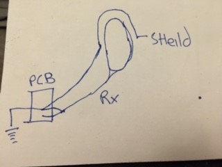

                are you sure you haven't got a ground loop problem
                I had a coil that you could just gently blow over the top and it would chatter away
                I would temporarily jumper from the shield to Rx ground on the PCB and not connect the shield in the head

                    [ATTACH]54375[/ATTACH]
                    What the heck. Anythings worth a try. Thank you. Will give it a go tomorrow.
