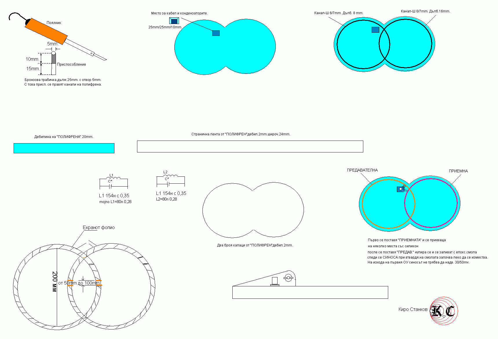

        hello , all what i have for nexus brand
          good schematics
          Varna_sch.pdf

              The TX and RX coils of the nexus mp v-2 device are completely identical: they have the same number of turns and are wound from the same thick wire. For example, the 13" 5.7 kHz head has 50-50 turns, 1.4 mH inductance, 0.5 or 0.6 mm diameter wire. The only difference between TX and RX is that the center tap of the TX is led out, and the resonance capacitor of the TX is molded in. What is the reason that the TX and RX are the same? After all, if they have a different number of turns or wire thickness, they could be tuned for resonance. I want to build a special depth finder head for my factory Nexus, so this question is interesting to me.​
                For a 50" 5.7 kHz head, what kind of inductance, what number of turns, what thickness of wire would be ideal?​
                  I made a 110×100 cm search coil for nexus MP. It works well. In air test, a half liter beer can is 170 cm.​
                      Can you give us construction details?
                        The original 5.7 kHz search heads have identical TX and RX coils, with an inductance of about 1.5 mH and a resistance of 2 ohms. For such a large search head, this would mean 24 turns and 0.8 mm diameter wires. I made the coils this way, but it was not possible to zero them by positioning the TX and RX coils, the copper mass was too large. Therefore, the RX was made of 0.3 mm diameter wire with 24 turns, and the center-tapped TX was made of 8 pieces of 0.3 mm Litze wires with 24 turns. The RX has 1.8 mH inductivity. The TX has 2 A sinus current. I wound a hair-thin copper wire on each coil with a pitch of 1 cm and sprayed it with graphite spray, this is its shielding. The shielding does not reach the entire circumference, it is interrupted in a 1 mm ring. These coils could be nicely balanced by positioning and using a 5 cm diameter ring cut out of aluminum foil. The original nexus heads are carbon fiber laminates, but I made a fiberglass laminate instead. The template is made of XPS glued to a plasterboard sheet, coated with a layer of epoxy and many layers of mold release. I used vinyl ester resin for the lamination. I heat-treated it at 80 degrees C, then glued the TX and RX coils in. It was molded with hard PUR foam. Of course, it weighs more than the factory head, but it works well, it is not noisy, and you can search with it. A lot of work, it is easier to buy the factory one, and it also weighs less. But it was a fun game to make.​
                          Oh, I forgot that the transmitter needs a resonant capacitor for the 5.7 kHz frequency. Polyester film capacitor, about 560 nF, 250 V.
